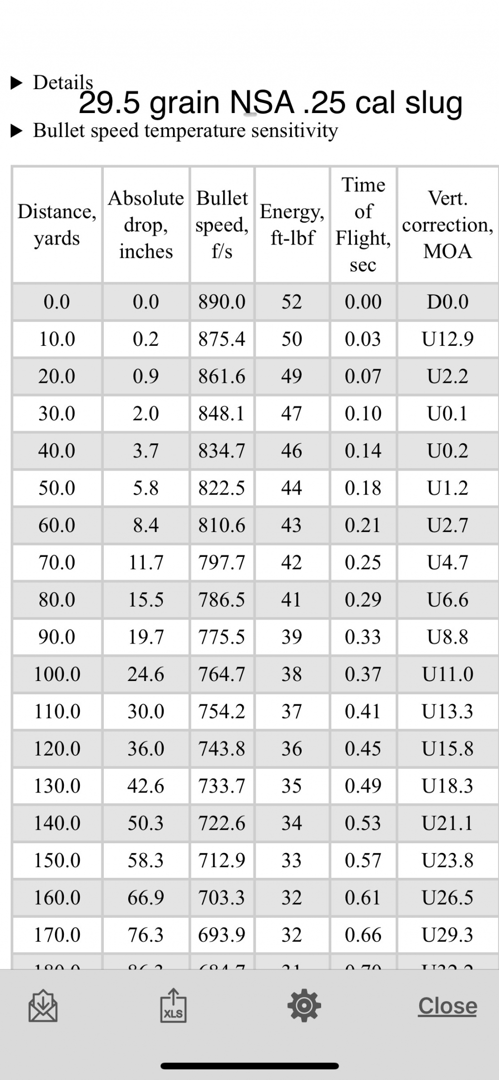

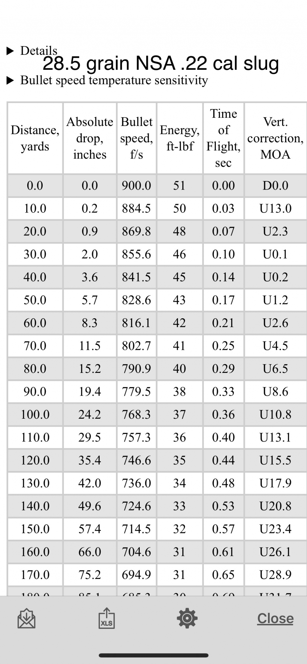

I’ve owned a 30cal FX bobcat and then moved down to .25 cal impact and I’ve always had .25 cal Airguns after that because I thought they were the best for hunting but now I find myself about to buy a FX Impact MK2 .22 cal!! Because if you look at my pictures shown below .25 and .22 is so close and almost the same. So why not go for .22? More shots per fill and cheaper ammo :) And I’m only talking about slugs here pellets are a very different story
