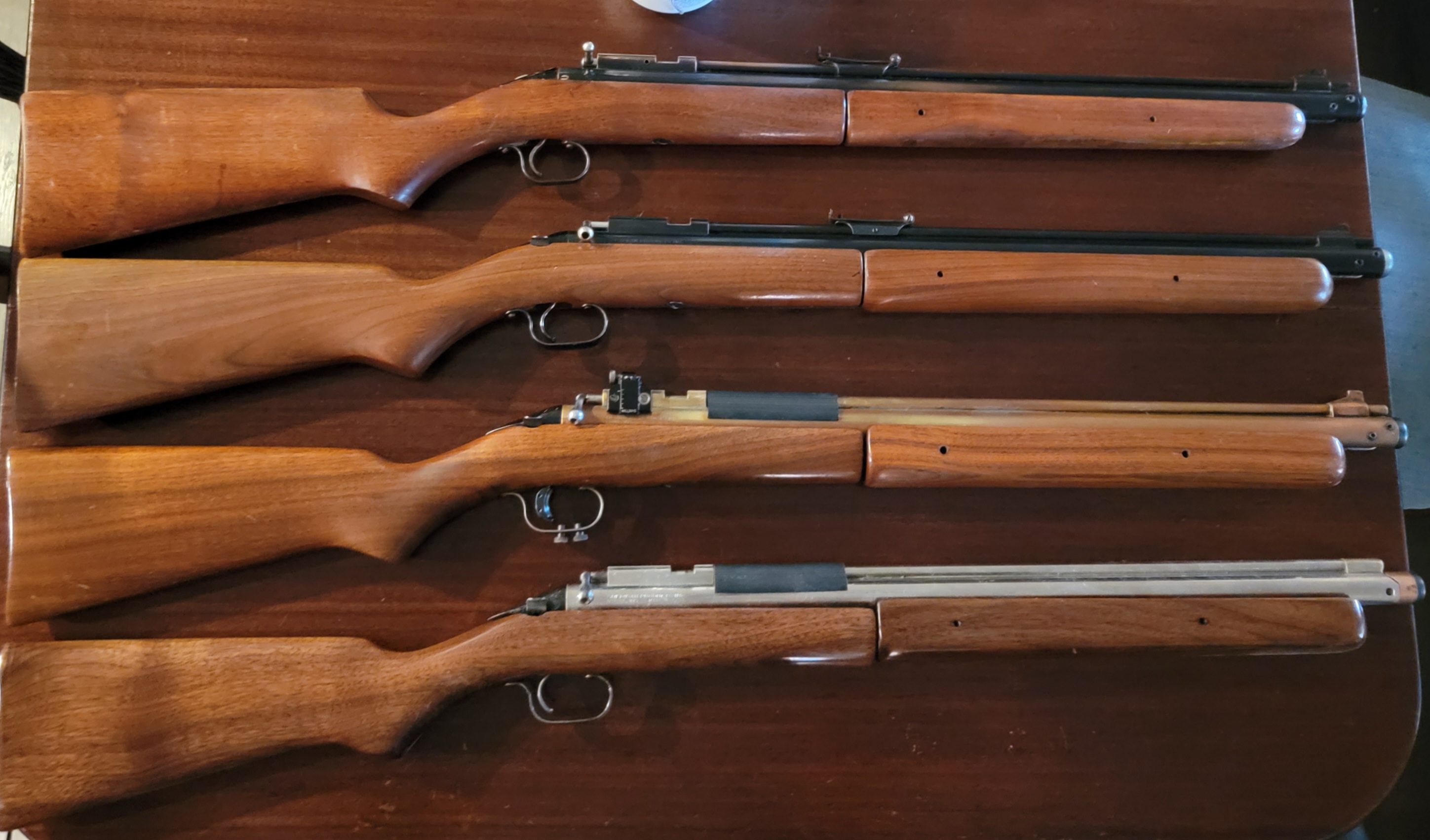

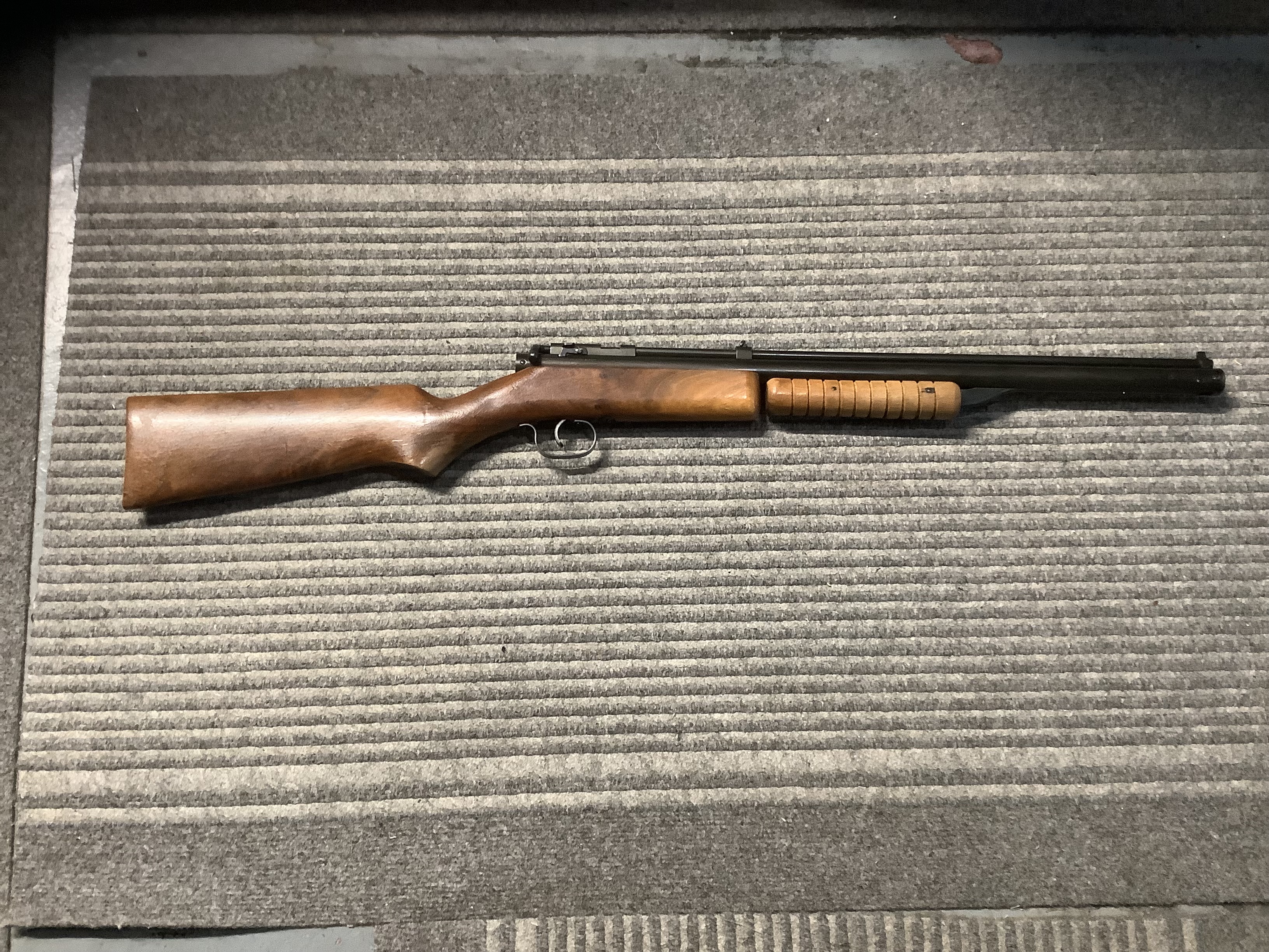

I have a pumper from 30 years ago, its a Benjamin. I also have three Sheridans from 68, 58, and 51 years ago. The Sheridans are in a completely different league, shooting tight groups with good power. The Benjamin from 30 or so years ago shoots about five inch groups, like a improved cylinder shotgun. Its also big and clumsy in comparison.
A forth Sheridan project gun is also pictured.

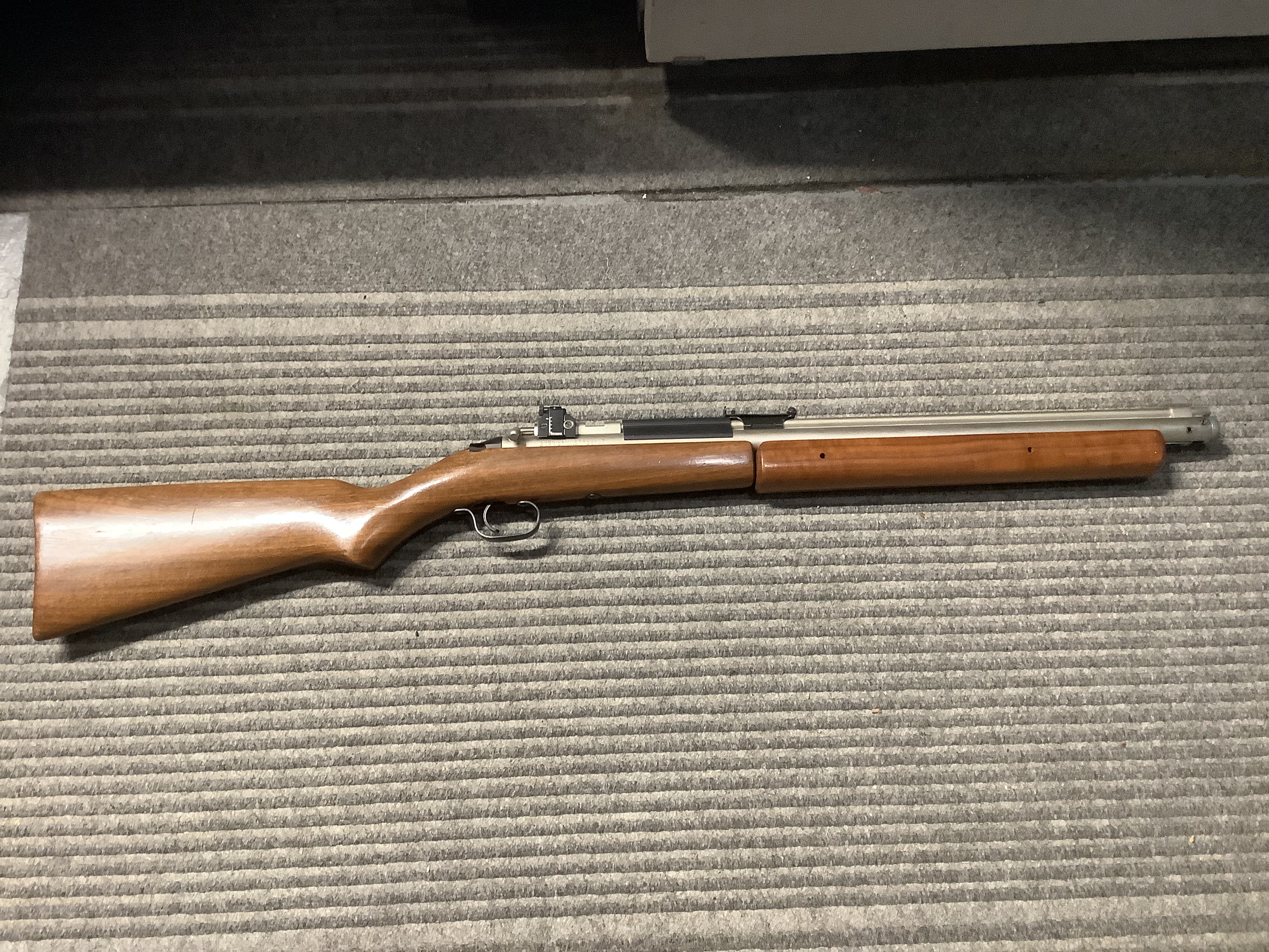

At a recent gun show, I picked up an older Sheridan Blue Streak .20cal. To compare this to the modern Dragonfly2...
Two totally different animals. Quality & build goes to the Blue Streak. But performance, fun to shoot, ease to pump, etc goes to Dragonfly2.
Biggest Dragonfly2 negatives; rubber-like barrel (needs barrel band) & minimalist pump linkage. Maybe a Dragonfly3 will come out & have some improvements.
The older Sheridan, biggest complaints I have are it is a beast to pump, its heavy, and no scope rail. Also pellet selection for .20cal is not good.

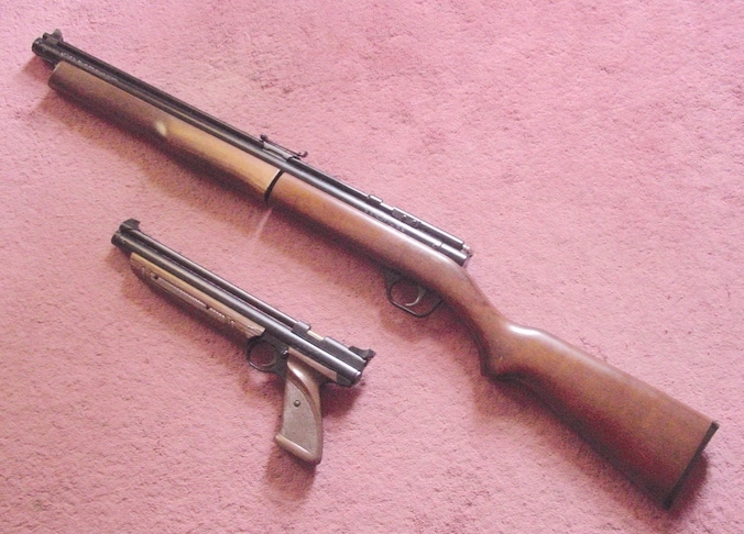

I have two multi-pump pneumatics in my collection. A Benjamin/Crosman 392PA .22, and a Crosman 1377. Bought them both around 20 years ago. Always consistent, reliable, and accurate. Had to re-seal them both once, very easy to work on. Crank them anywhere from 2 to 8 times depending on your target and use. The 392 pumps easily due to the length and leverage of the forend. The 1377 is an especially good shooter with the optional carbine stock. Both are great guns.
