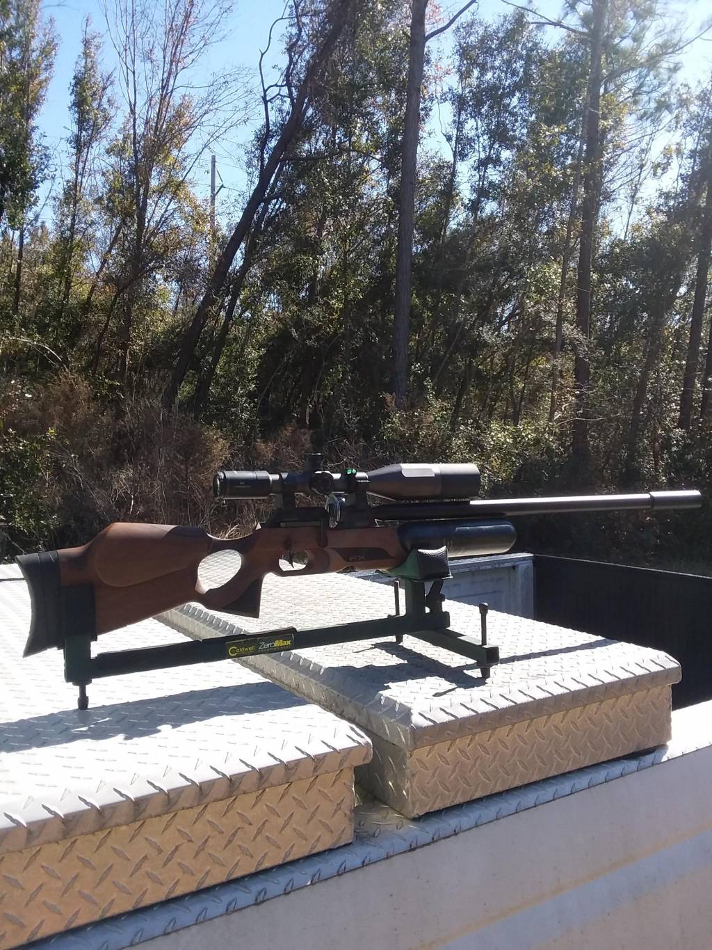

i get 50+ shots out of my crown mk2 600mm barrel, with nsa 24.8gr slugs at 965fps
this gun is used for pest birds on the farm and my barn kitties are about draggin there bellies
on the ground !!!
got 6 fixed cats and between rats, birds and other farm pest critters, we just supply them water and a nice place to sleep to get out of the weather !!
our dogs get along with them ok and the kitties dont mess with my yard pimps either !

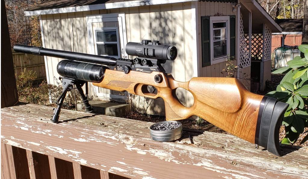

pearls before swine
