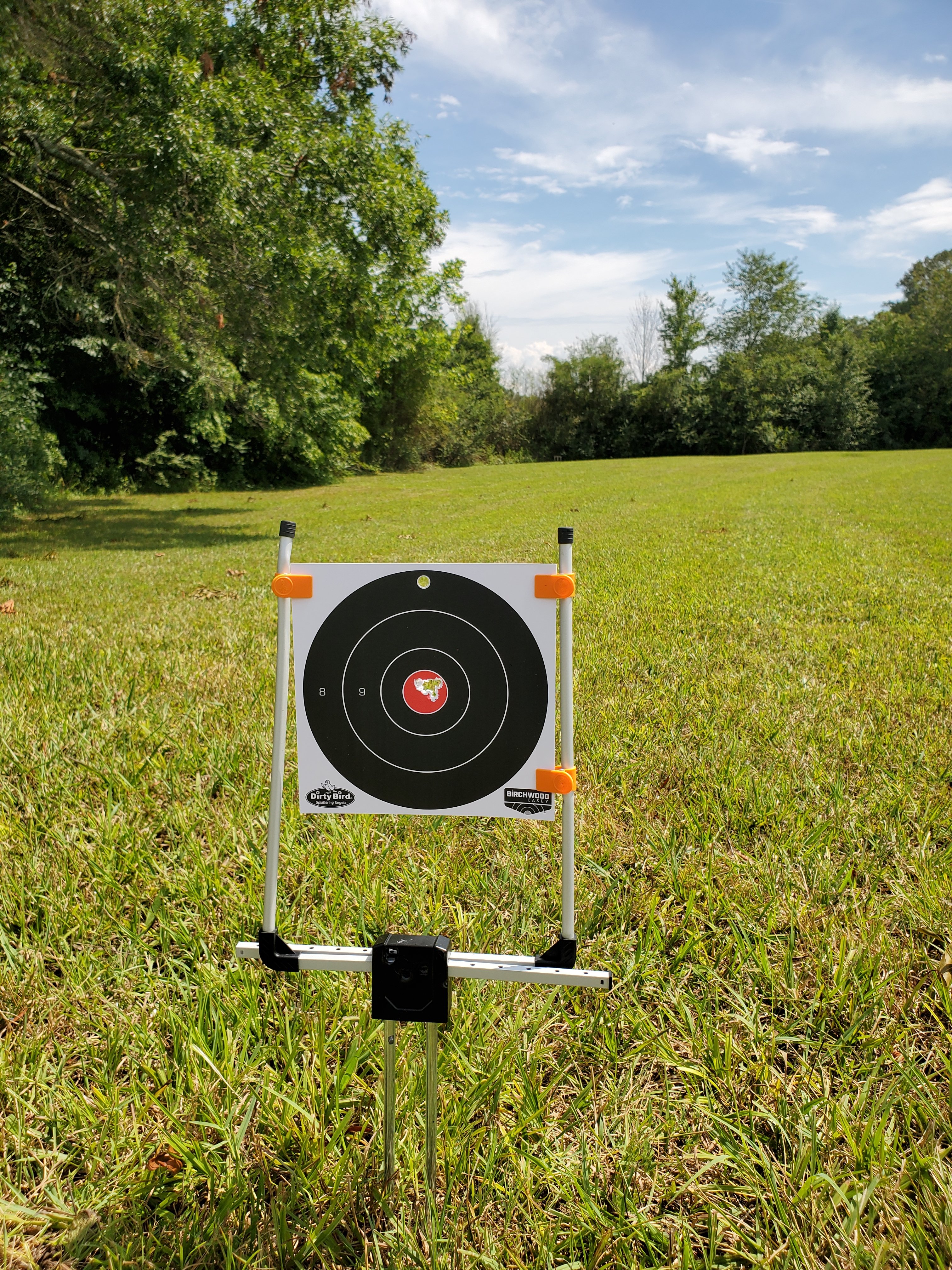

RAW Rapid Are my expectations to high?
Raydee, have you tried the lighter pellets?
I had a .25 Raw that liked the lighter pellets much better.
I think you should be able to get groups like those excellent two on your targets more often than not.
You definitely are not expecting too much from a PCP.
No I have only tried the pellets that were recommended by Utah air. I am going to try other pellets for sure.
Hey Raydee38 these pellets worked great in my RedWolf .22 I got them from AOA.
I’d order some and see how they do. Good luck!
