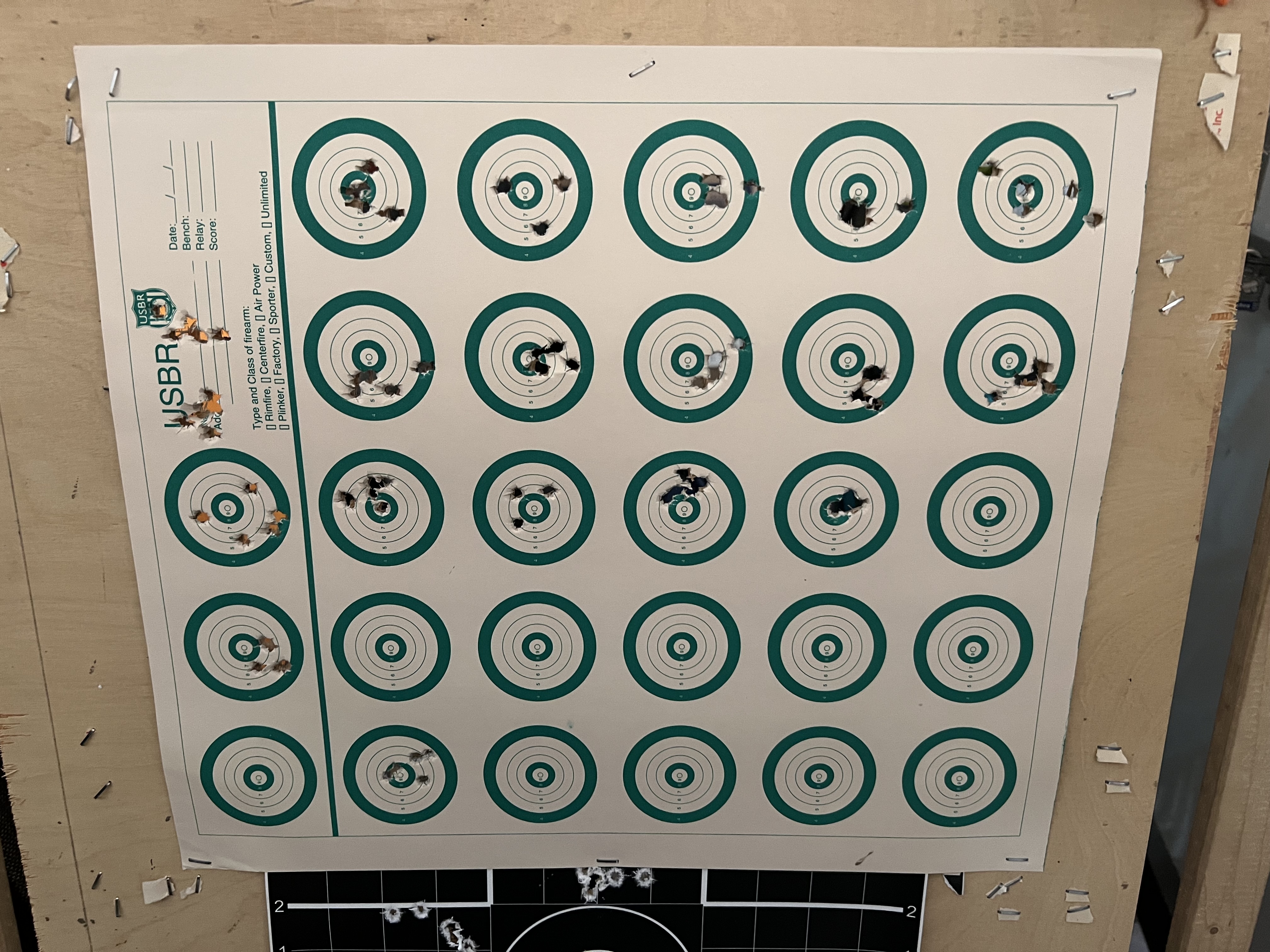

I purchased a RAW HM1000X in .25 about 3 months ago and was told that it was tuned for 33.95gr JSB pellets shooting around 900fps. I am weight and head sorting pellets and while the SD and ES are fantastic I am not having any
luck with grouping at 50 yards. I have tried lowing the fps to about 865 to 910 without much of a difference. I recently decided to try a barrel tuner like I use on my Rimfire and centerfire rifles and there have been some spots that look promising. I am wondering if maybe trying a different weight or manufacturers pellet may be worth a shot or am I just expecting too much from a pcp rifle? I am only looking to use this rifle for bench rest so shooting small is the goal.
I have attached a tuner test from this morning.
These groups would be normal for my skills at 80 yards.....
Reactions: Raydee38
