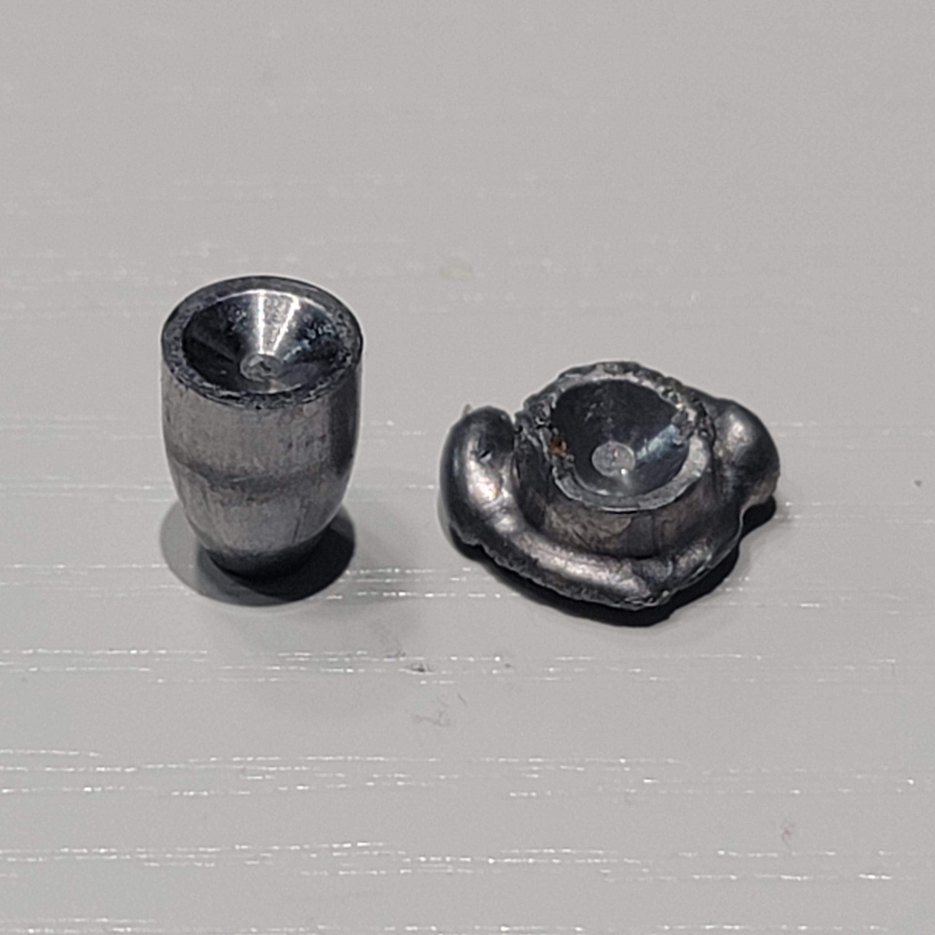

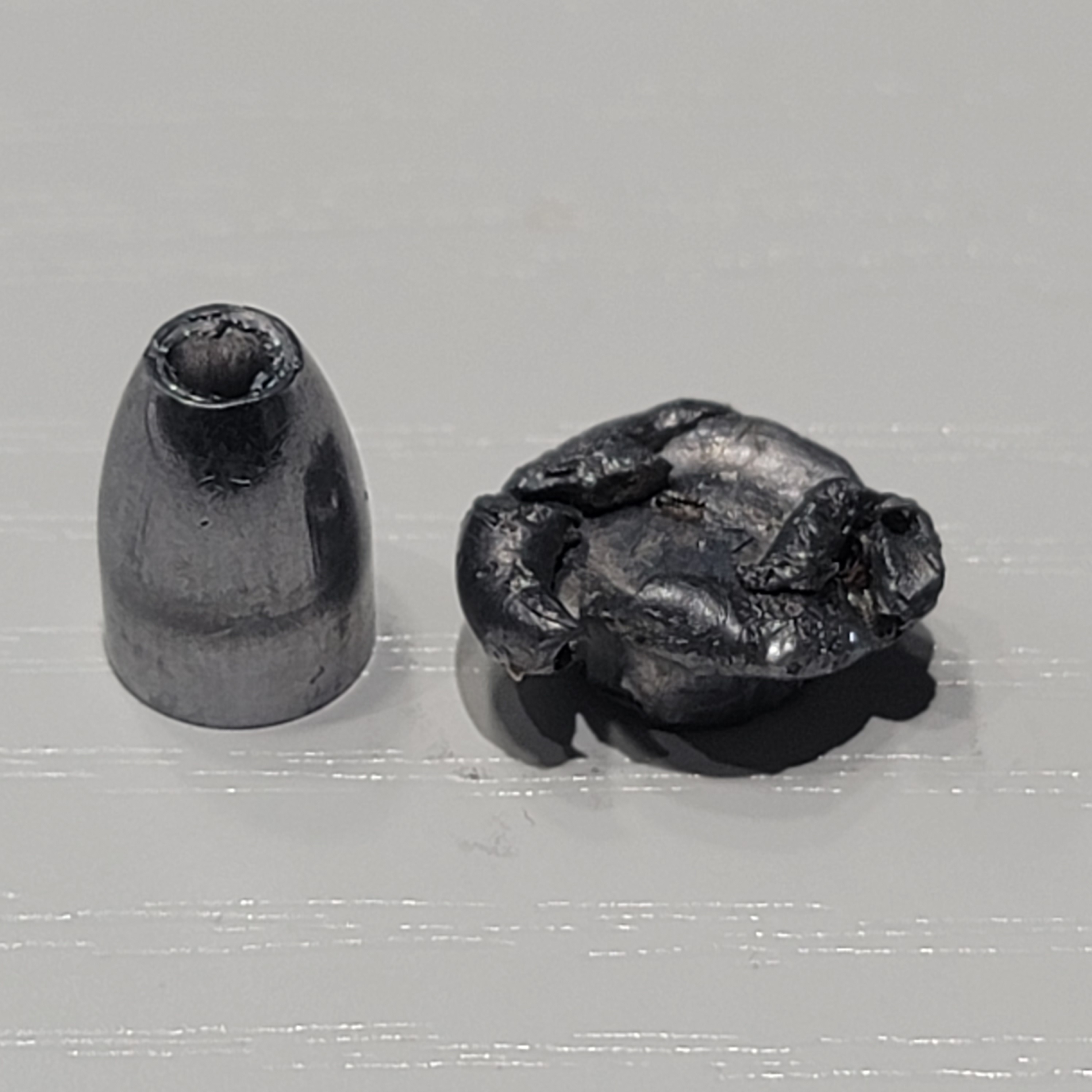

I've posted this photo plenty, but it's always worth posting whenever the .30 cal FX Hybrid Slugs expansion question comes up. Here is the expansion after a full passthrough on a groundhog bodyshot at 60 yards from an FX Maverick VP shooting them at 930fps. You can see a video of the shot here. She was dead before she hit the dirt.
I am preparing a big ballistics gel .30 cal shootout with the following ammo, just as soon as I recover. I just have to do a retune on my FX Maverick to push the Heavy ARG slugs to the appropriate speed.
