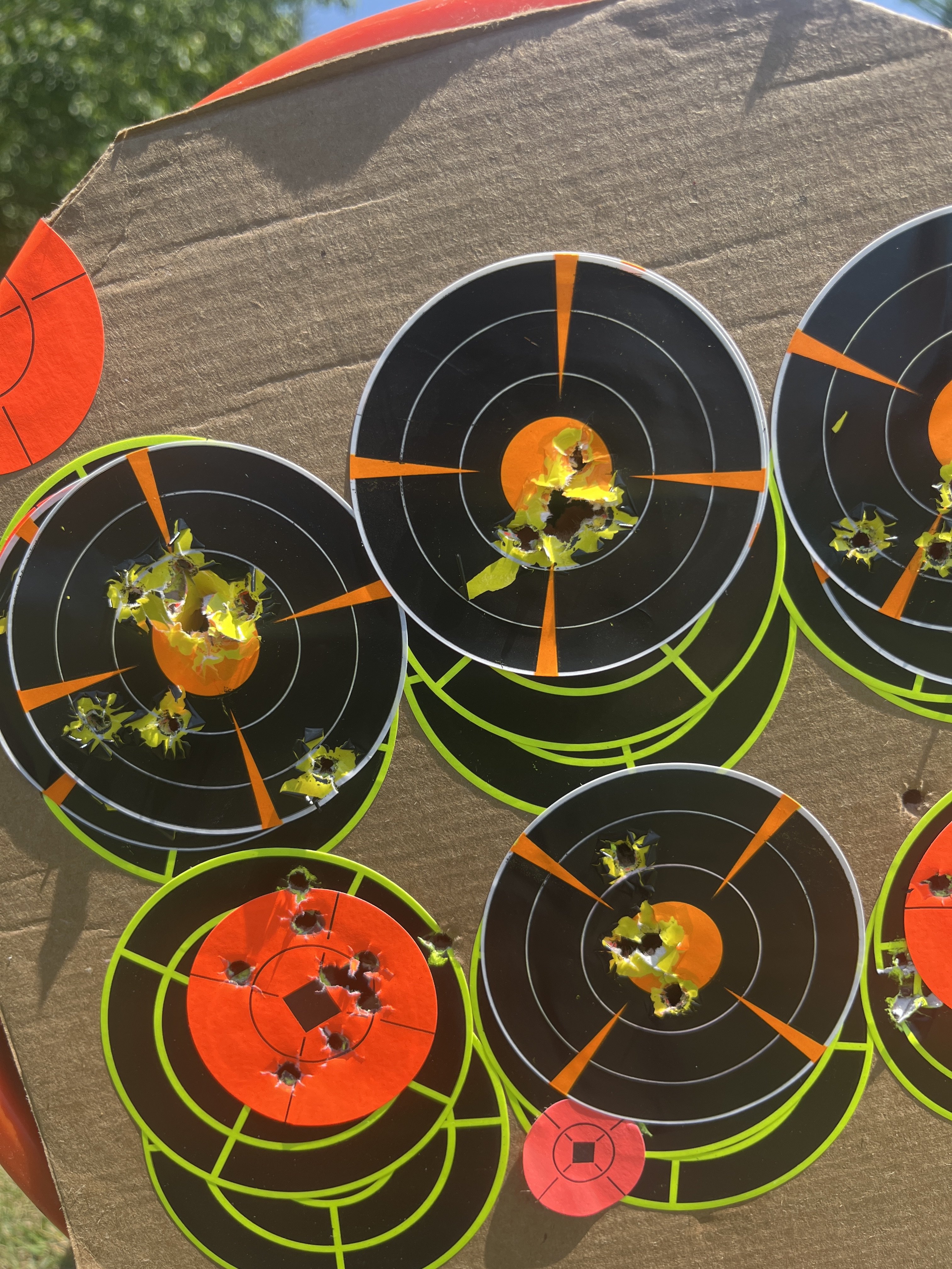

My 177cal RAW can be shot rested a bunch of different ways and easily produce 1/2" 50yd groups (assuming the wind isn't messing things up). I also had a Daystate Regal and it was the same way - accuracy didn't change depending on how the gun was held.

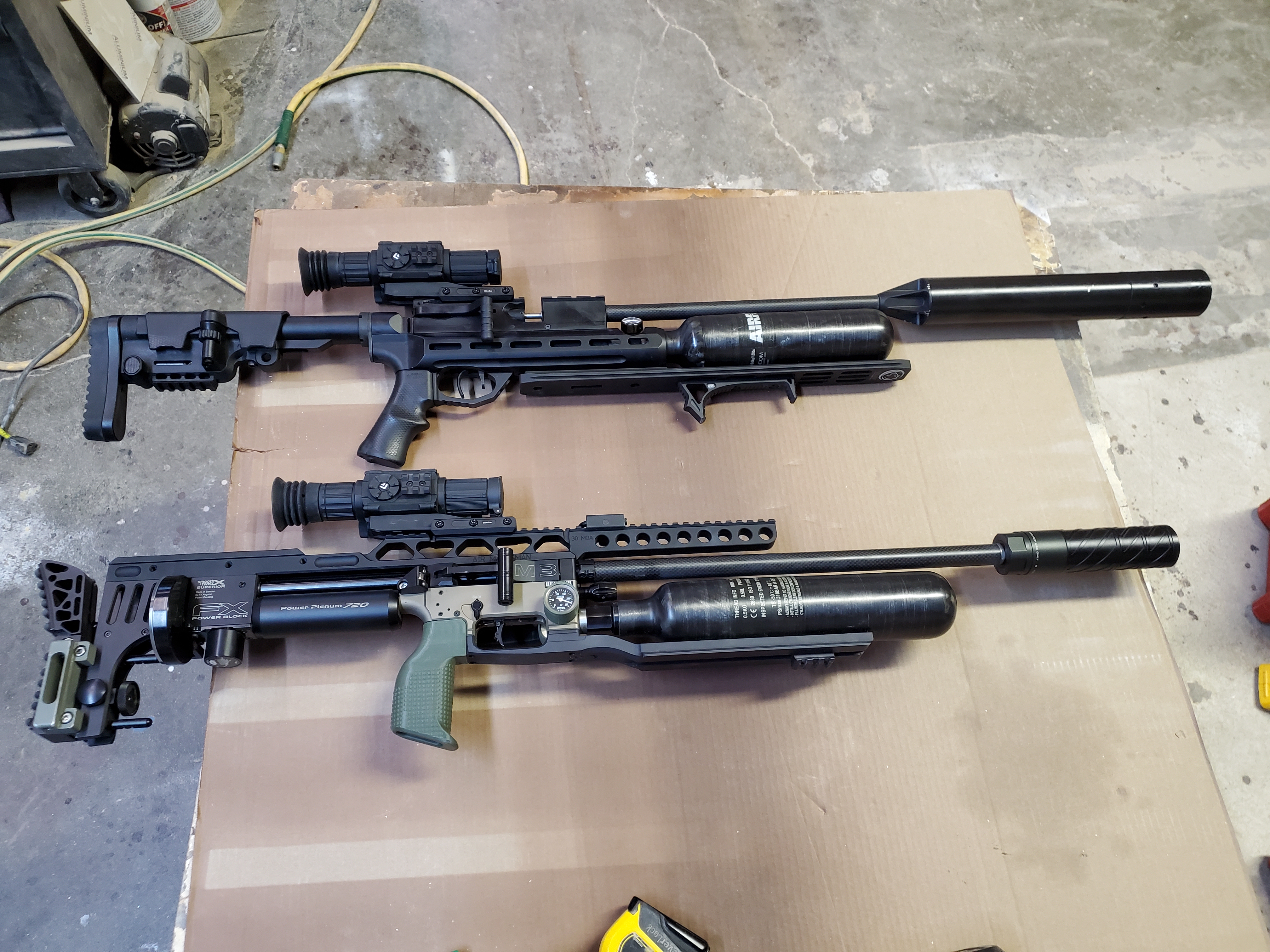

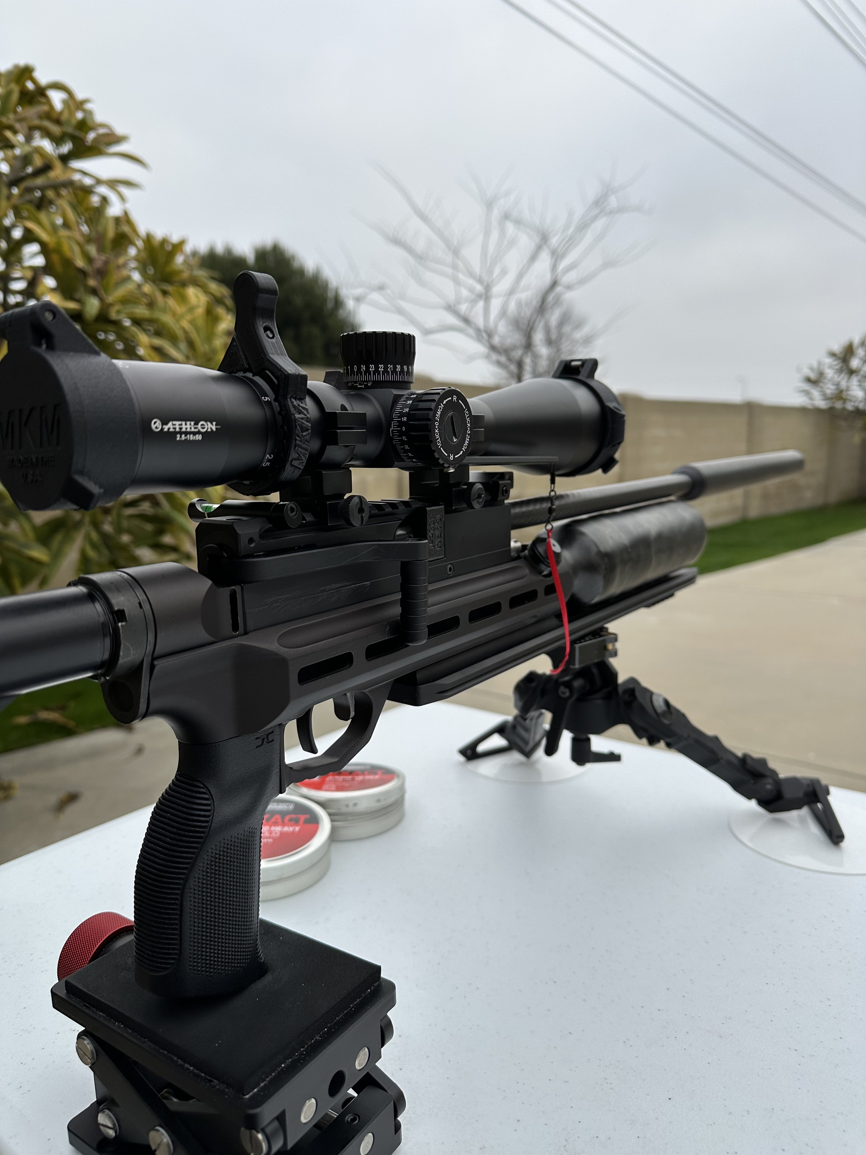

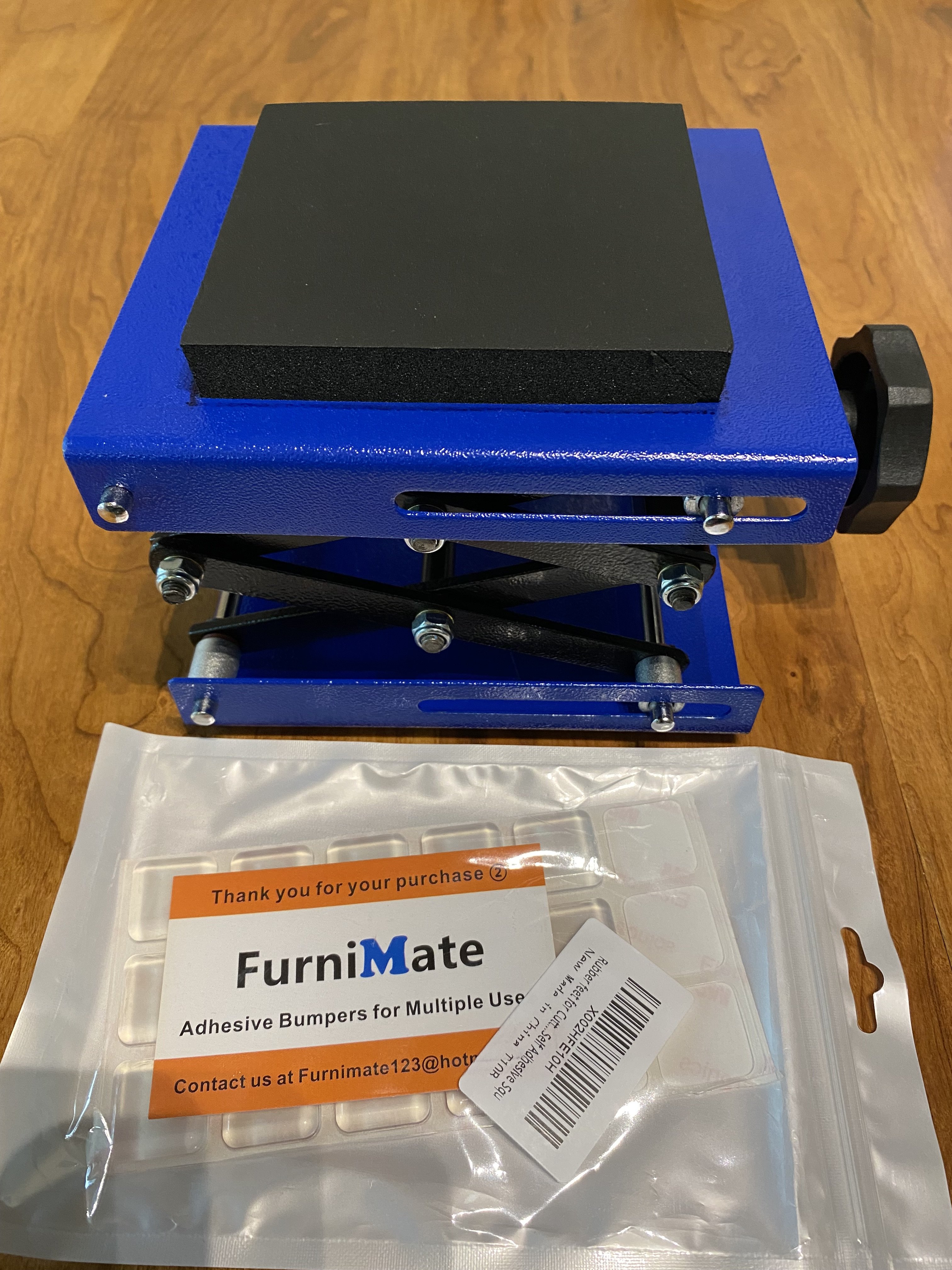

I too shoot my RAW off a front bipod with a rear lab rest...accuracy is dependent on me doing my part for a consistent hold and sight. Mine is tuned to shoot JSB 18gr @ 970fps about 37fpe.
Your setup is the one that I copied 😁 . I bought the top pad and bottom pads that you recommended, but I cheaped out a bit and got a lower cost lift.
This setup definitely help with consistency.
