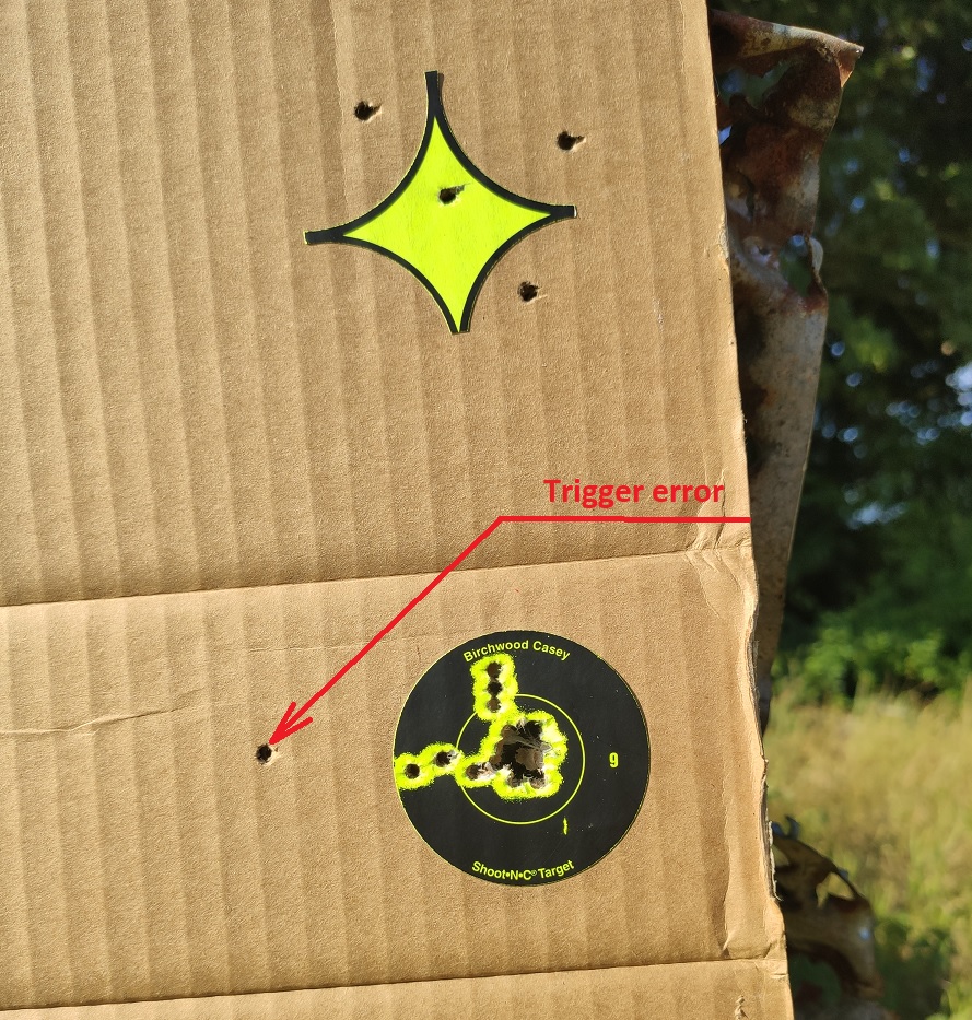

15 shot groups are harder, i shot those all day yesterday, and there was no wind to blame.
This is my best ( on the day ) 15 shot group at 75 M with the .177 Maverick, that i still need to tweak a little on CUZ still a bit too high dev on a shot string.
But its getting better, here the REG is set to 80 BAR which are fine in the 700 mm barrel with a heavier hammer, shooting 13 gr Zans at just over 1000 FPS.
If it was not for that trigger error i would be extremely happy, even if there are 6 erratic, but those are to blame on the erratic shot speed as the chrono dangling on the end of my barrel told me.
So the 3 shots in the 12 O clock position that is 3 fast shots, the other 3 in 9 O clock position those are actually 3 slow shots, which for some reason went there and not as i would have put money on at the 6 O clock position
PS that is a 2" Shoot NC target.
PPS: Another target i shot, well the first 4 shots was placed symmetrical just beside the red bulls eye on the target, looking just as good as the 4 on any dice.
So the 5 shot i was mentally geared to make that a nice symmetrical 5, sadly it whent 10 mm high and right in between the top 2 holes already there, so i just proceeded to turn that 2" target into Swiss cheese too.
