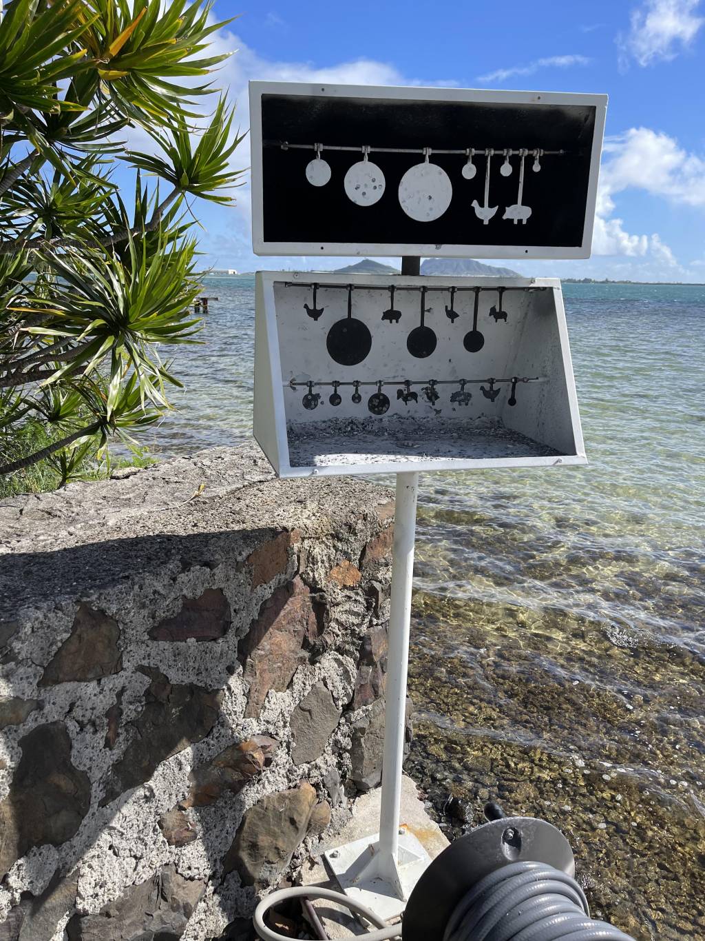

Anyway, I've used duct seal for a long time in the smaller traps. It's easy, clean, effective and low maintenance. The only down side is weight. I'm thinking of having a big square trap made to replace the two traps in the photo. I'd fill it with duct seal...but is there anything better? (The backstop on the current traps is at an angle so kind of hard to stack the duct seal.) The key is clean and low maintenance.

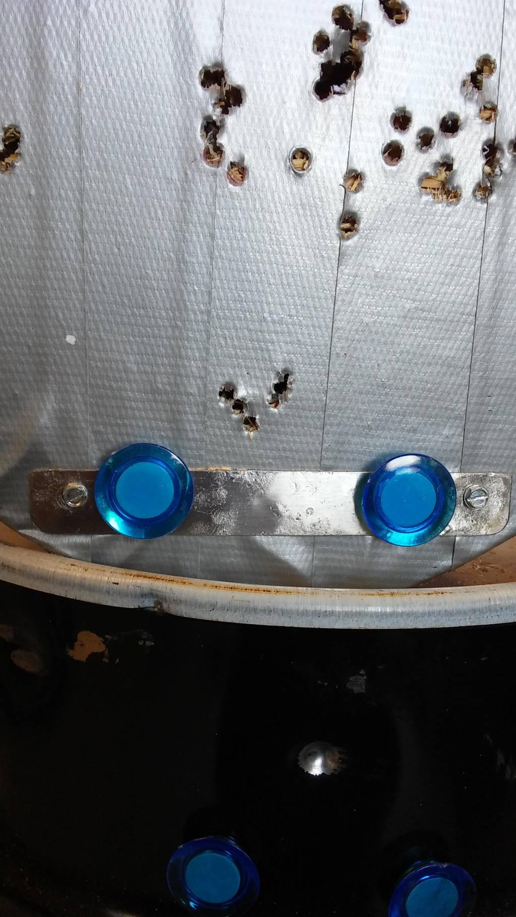

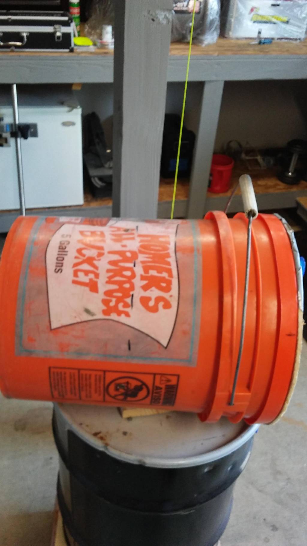

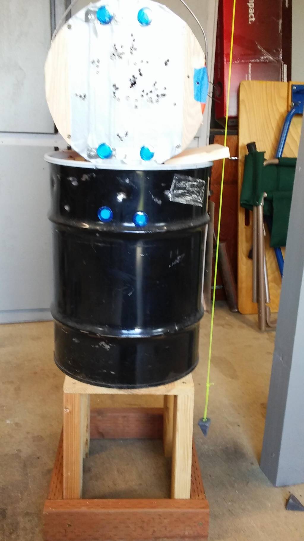

I have never used a mud flap. I was suggesting it too line the (inside) of of trap you are using . A semi mud flap, the pellets would probably just bounce off. This is my setup, the bucket is fill with rubber mulch (part way) see the dotted lines about half way on the bucket . I screwed a piece of 3/4 plywood to the inside then added the mulch (from home depoe) for your .177 you could go less . I've shot mine up to 40 ft.pds. at 6 ft. no pass thru . You can use cardboard for the front covered with (duck tape) but I use 1/4 plywood or 1/4 compressed cardboard like they use in the bottom of draws wrapped in duck tape. the strips of metal with magnets hold the target.
