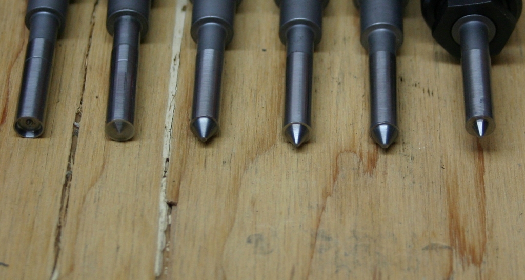

In .25 cal. I have a good size HP. (3rd try) Best of both worlds, accuracy and good expansion at long range.  I had to have good expansion at POI first. Then I went to work on an accurate size, weight and OAL. Different bases help to get the OAL just right in a given weight. My barrels are very OAL sensitive.
Too large of HP could be detrimental to long range stability.
I posted on here a couple Youtube videos exploding water filled cans at 173 yards and at 200 yards. They sound like a .22 short being fired out there at 200 yards when they explode. But that is with a 75 FPE gun.
I'll try to post a picture of the bases I have after work...............

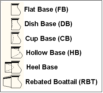

I think you are getting the hollow base and Cup base mixed up.... here they are to clarify.....
The cup base works OK on some weights and nose shape, it's the hollow base that is the crappy one, every nose shape, weight, and nose style (solidpoint or hollowpoint) are useless at my power level.
