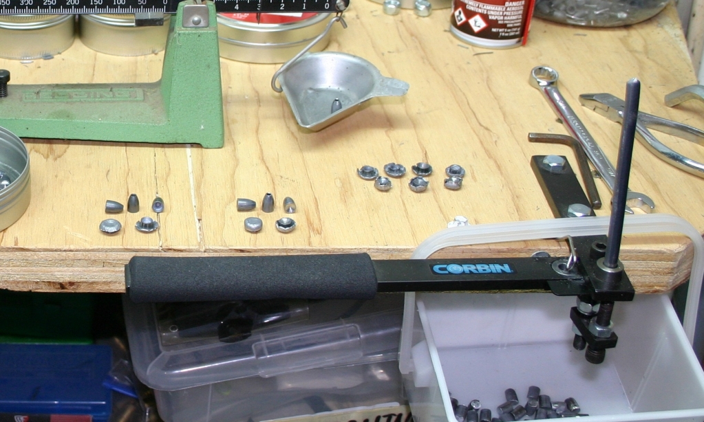

I buy all of my lead wire from Corbin direct. It's not worth casting your own, or trying to find a better or cheaper source. Corbins lead is 100%, no alloys are introduced, so the wire you buy now, is the same as it was 8 years ago. When other alloys are introduced to the swaging process, there is a danger of too hard of lead due to alloys introduced. Lead wheel weight lead will damage the dies, and possibly damage YOU!!!
I get all of my wire from Corbin, .170 in diameter, in 10 pound spools. 10 pounds of lead is approximately 70,000 grains. One spool is $50, if you buy a case of 4, it costs $180. The shipping is up there, but not to the point it is cost prohibitive. I still have about 100 pounds left, I'll buy 3 cases at a time in the future.
I'll make another swaging video that is a little more detailed than the last one, due to my award winning camera work. One thing I will show in more detail, is the cheapo adjustable cutter that I made, that works like a charm. Anyone reading this, if you are inclined to get all or some of this equipment, leave out the wire cutter. It works well, but for lighter pellets that we use in the airgun community, it's a hindrance. It is really designed for making longer cores to be jacketed for powderburners

That's exactly what that is, it's a hose cutter. Modified by me to make it adjustable, so you don't waste wire. I'll put a detailed review on it, and how I build it. Whatever weight I need, I make the lead slug weigh about 2-3 grains heavier for some bleed off.
I would also go onto Corbins website, he has TONS of free info that you can download and print out for reference. He tells you everything you need to know about swaging, as well as how to fix some issues that you might encounter. I downloaded and printed everything related to swaging.

You are 100% correct. I have the semi wadcutter dies for the Corbin press, it is a one step process. It is a two step process for a standard reloading press to make semi wadcutter pellets, and a standard reloading press cannot make the smooth sided pellet (slug) that we want.

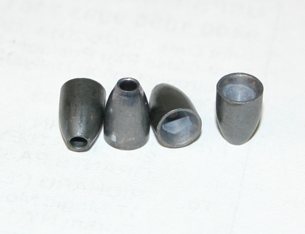

I use a deep cupped base .25 cal. 30.5gr. in a stock Cricket @ 872 FPS. - Extreme sub-MOA. WAY more accurate than a JSB anything at all ranges. Down side, only about 52 FPE. Blows in the wind more than I like at long range.
I use a very small cup base for a .25 cal. 37.8gr. in a modified Cricket .35 to .25 @ 942 FPS. This is my 100 - 250 yard slug gun. Can't shoot pellets out of this one, even if you wanted to for some dumb reason. These things cut the wind unbelievably well.
These are what work best so far.
The Hollow Point is probably more important in some ways than the base.
Don't over look the HP size and depth...... To small will suck!!!!
I have the first two HP pins that were to small. They failed to expand properly at long range. No good to me.
This spring I had the right one made. Has perfect expansion beyond 250 yards from a 75 FPE gun. Get that first. Then accuracy.

As for multiple steps, the die and press are made to be able to do both steps in one action. Watch the video that Tom posted on the first page and he shows exactly how the process works.

I make 60 – 100 in .25 cal. an hour approximately. About the same time it takes to have 3 beers. No big hurry. Precision match grade rounds are what it's all about for me. I visually inspect each one for perfect form.
Tiring? A 5 year old could make .25 cal. slugs all day long.
