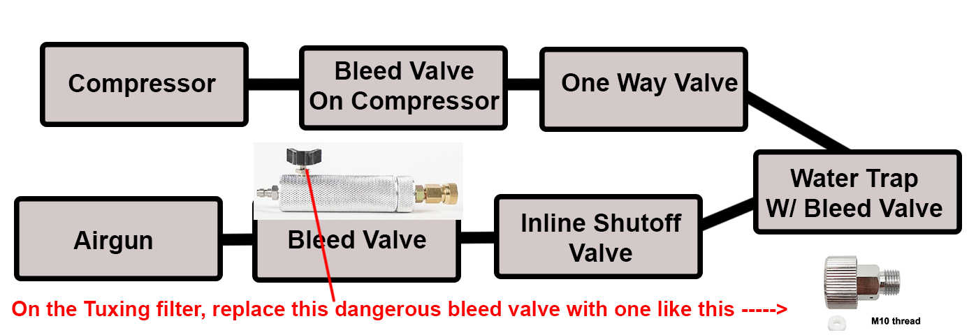

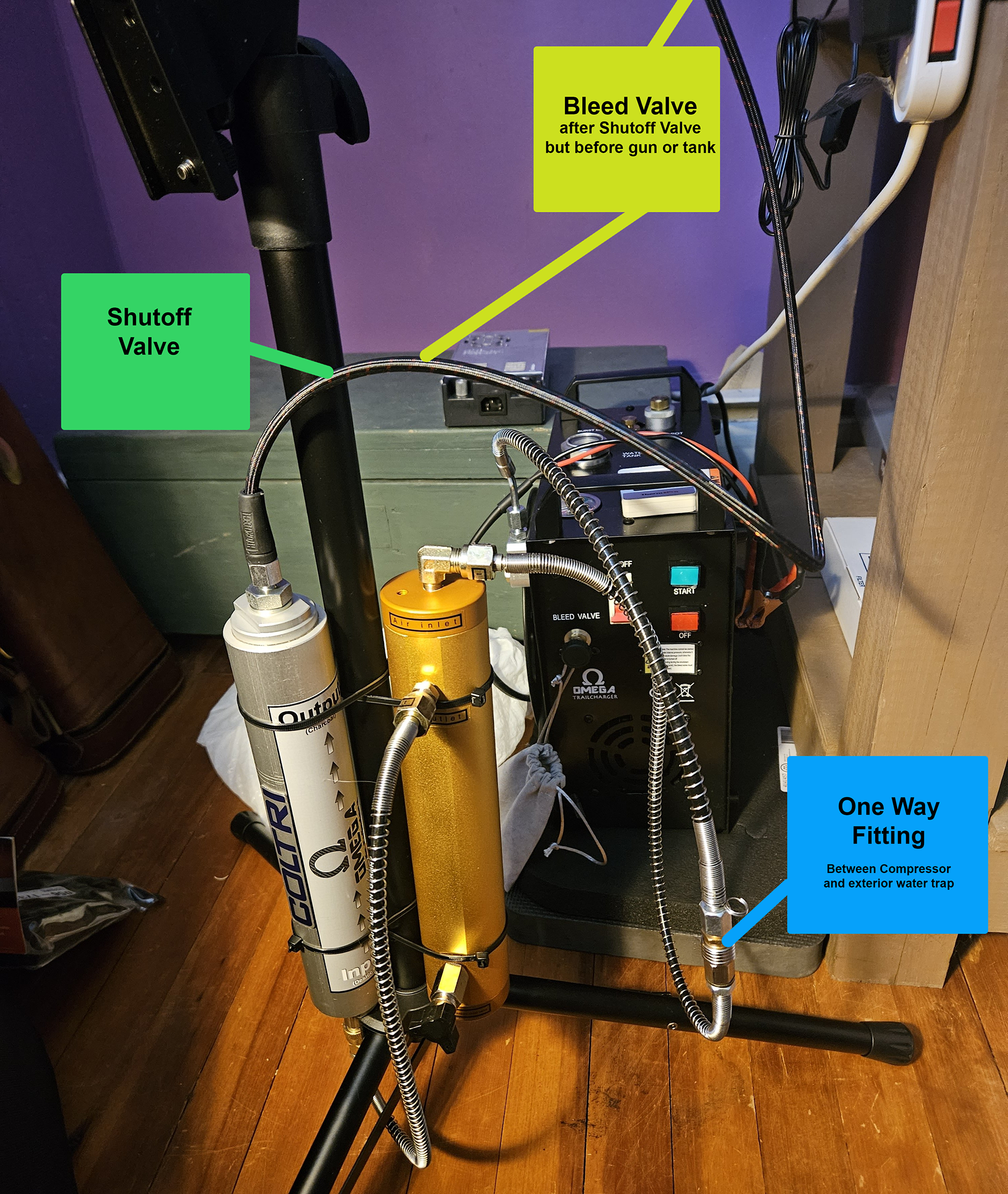

I just started to look for the parts, as you noted them.
Could you possibly send me photo(s) of what/how the connections look like in position? I'm trying to picture the layout in my mind and I'm failing. Ask me about pediatric physiology and I can imagine it all day everyday, mechanical things not as easy for me.
BP-1
It would be difficult for me to take a photo of my setup that would show what you want, but I have used your setup to show where the parts will go. You can use threaded connectors or QD connectors or a mix of them to hook everything up. Just make sure that the one way fitting is pointing the right direction to allow air to pass through it to the gun side but not back into the compressor.
