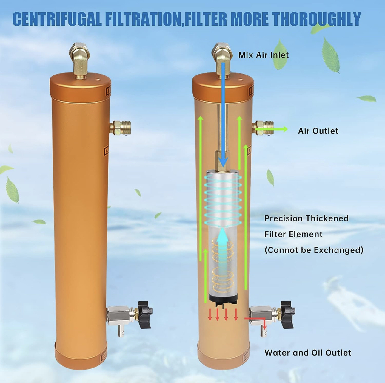

They are not a gimmick, and frequently used in industry. We call them "cyclone separators", but centrifugal is equivalent.
From my Uncle Google:
Cyclonic separation is a method of removing particulates from an air, gas or liquid stream, without the use of filters, through vortex separation. When removing particulate matter from liquid, a hydrocyclone is used; while from gas, a gas cyclone is used. Rotational effects and gravity are used to separate mixtures of solids and fluids. The method can also be used to separate fine droplets of liquid from a gaseous stream.

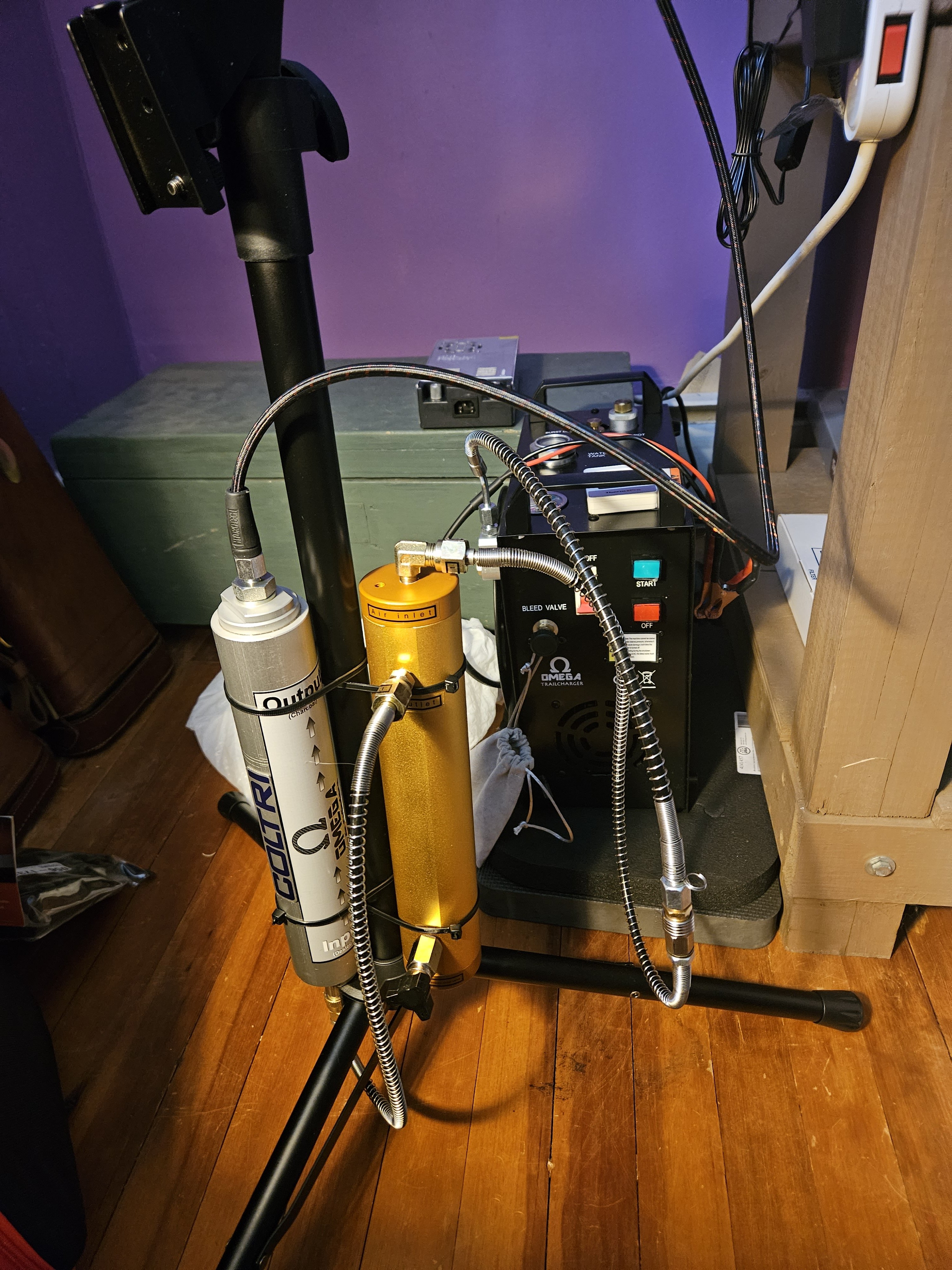

Finally up and running

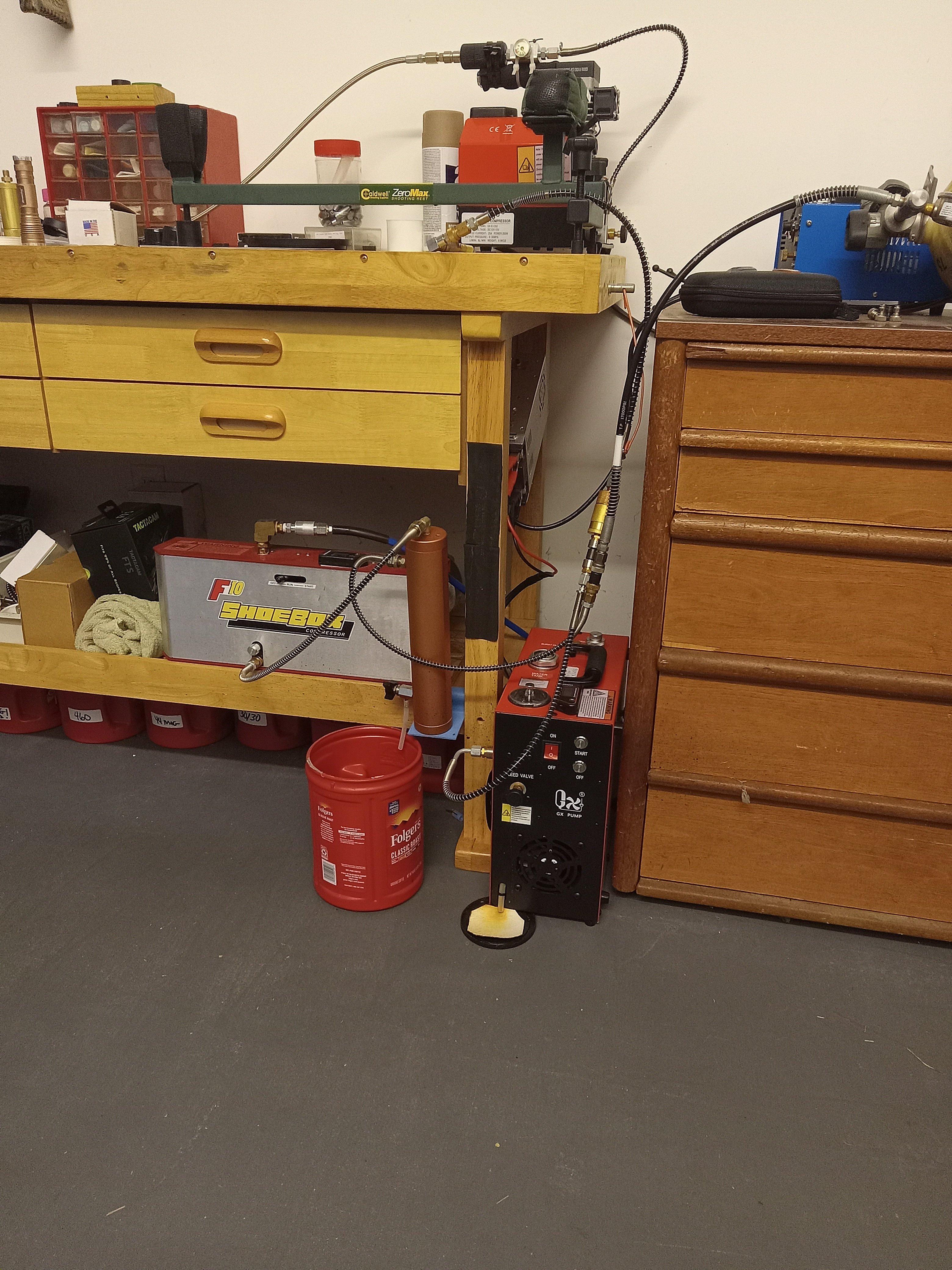

That looks great! Essentially what I have that I can switch back and forth between my GX CS4 and Yong Heng compressors. I have yet to see any water in it from the CS4 but it does well in trapping the moisture from the Yong Heng which has a much less efficient water trap than the CS4.
As noted in other posts of mine, I added a one way valve between the compressor and the external water trap plus a shutoff valve and bleed valve on the gun side of my molecular sieve filter so don't have to fill those up from empty every time I want to fill a gun. After checking every seal and connection, they now hold 300 bar forever. The seal that needs replacing most often is the one way connector O-Ring. They seem to last about 2 months before they start to slowly leak as they are opening and closing constantly under high pressure. A bit of O-Ring grease extends their useful life as well as using 90 duro O-rings.
