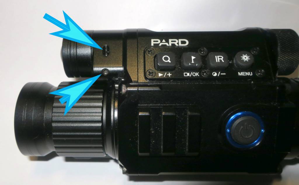

Once again on an NV008, there are small windage and elevation adjusting grub screws on the laser.

@TMH Thanks. I can see the difference between the laser on the 008 and 007. On the 007 it’s a single button to turn it on or off so far as I can tell.
