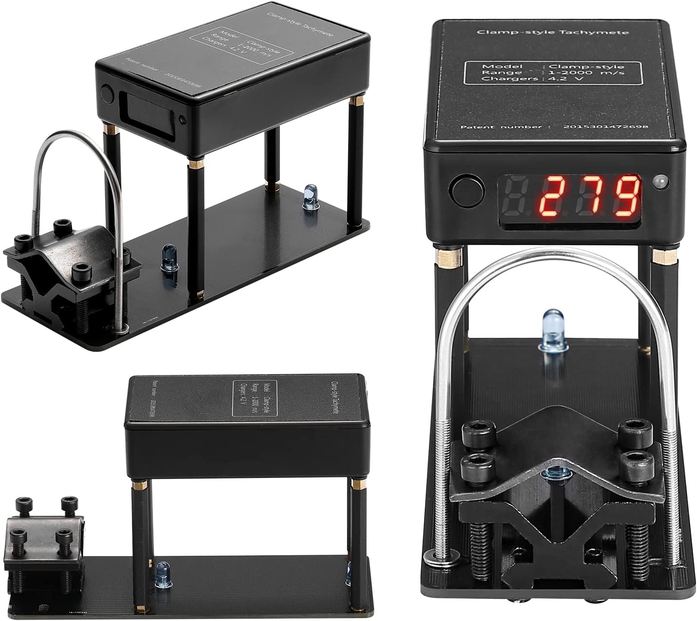

Anyone try these inexpensive chronographs that are $35? I'm not planning on tuning very often. I just need to tune for slugs. I've seen some youtube videos and a few positive post. Just wondering if anyone has compared one to a more expensive chronograph. Are they accurate, and consistant? Looks like there not going to be the most durable for I wont be using it very much. I already have a chosen pellet I just need to figure out what slugs it likes. View attachment 339427
Yep, great little chronograph. Agrees with my Caldwell which I no longer use. I would guess close to 200 readings with NO errors. Does meters, feet and energy. Input projectile weight and shoot. It's just too cool. $32 shipped from Amazon. I'm going to get another one just incase. Bill and Addi.

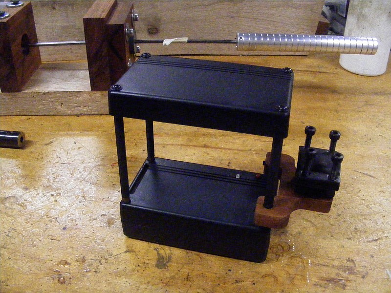

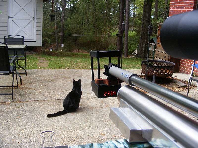

I ordered one of those as well. The way I generally use these little chronographs, I prefer to be able to attach to the muzzle so I added a clamp to mine:
Mounted to a rifle:

Just got mine from Amazon yesterday and tested it today. Seems to work just fine, but the diameter of the muffler on my Avenger is too big for the clamp. A Velcro strap solves that. Fits the Buckrail perfectly. I think I’ll get the one from Aliexpress as well. Gives me a backup and won’t have to change back and forth when I have two guns out t test.
