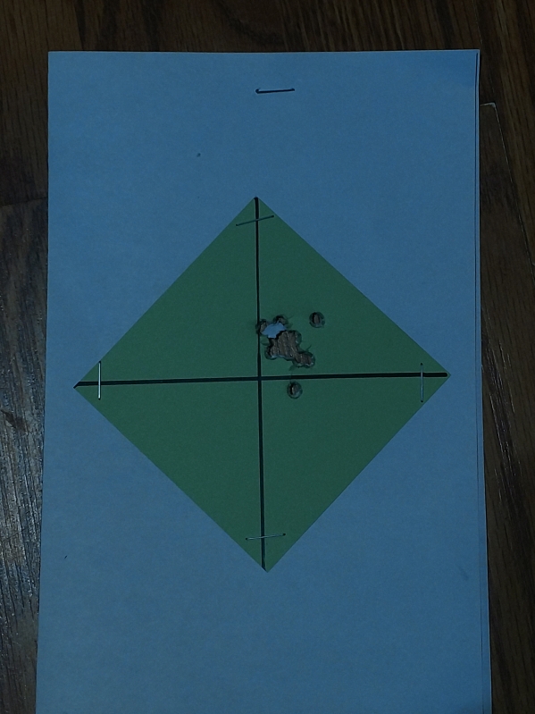

A lot easier without the Digi can adaptor. Shot in the dark with the flashlight. Not much to brag about. Winds come back tomorrow, had to throw some more lead while I could. 3/4 x 3/4"
