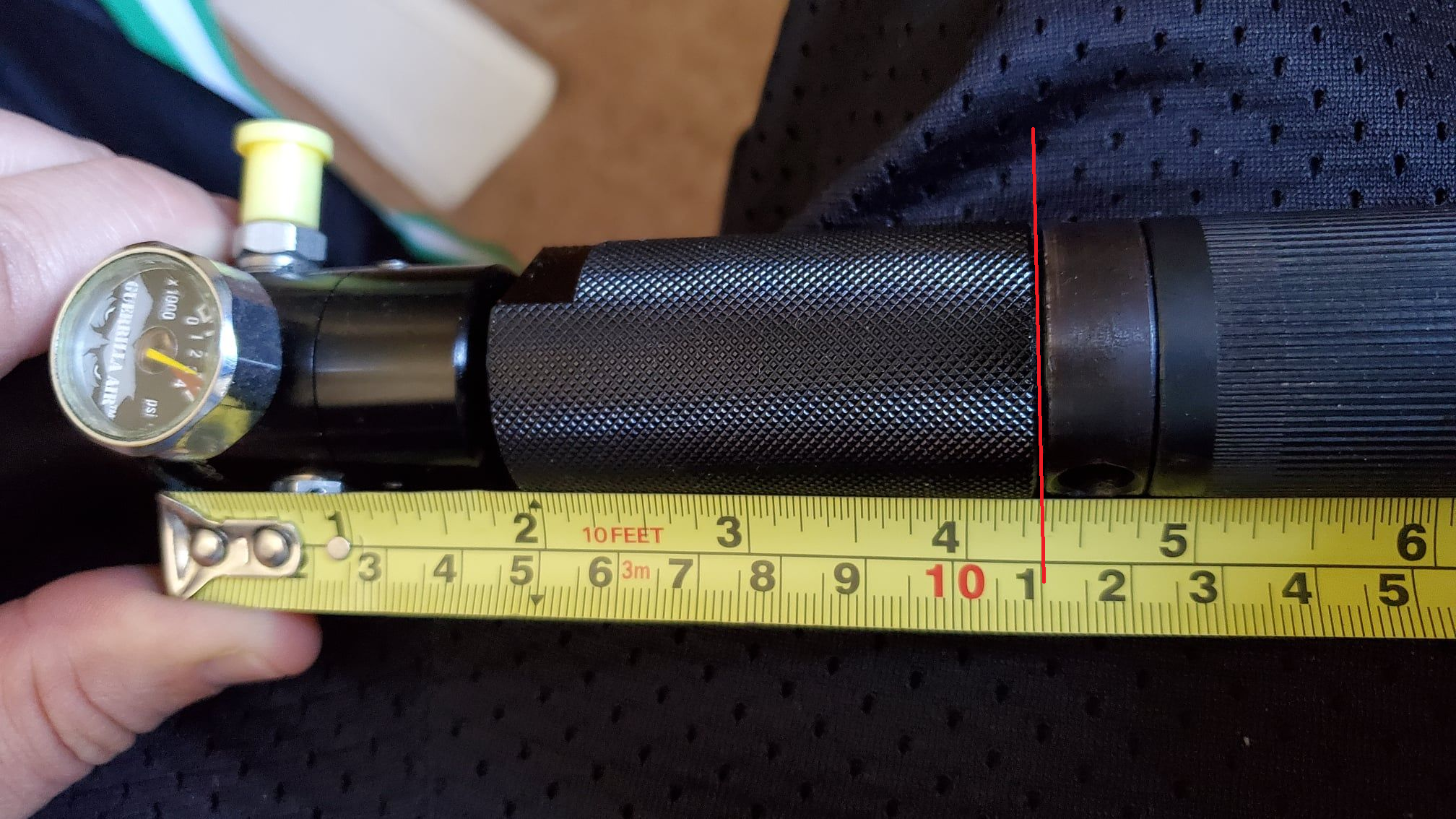

I just took a look at the adapter link AirShootist provided. I hope you realize you are moving your bottle 5+ inches forward when all is said and done. It’s going to look stupid so I hope it works. If it’s going to be a bench gun, who cares how far the bottle is hanging out on a limb.
Yes, I realize that. It's a Krait X (long boi) so: meh. It'll look a little odd but it will probably work pretty well. Gun wants to creep at higher pressures so if we reg it down to 150 then to 125 it'll probably be fine. Here is a pic of the length it adds, which is a hair over 4.25 inches. Not bad.
