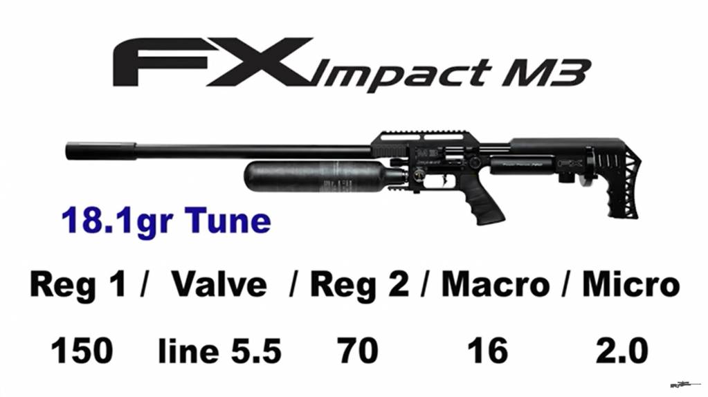

Hi, New M3 owner...wondering if the M3 is capable of a 1 inch group at 100 yards with FX 18.1gr pellets. I adjusted it to the factory tune from FX. It was at 933 FPS. I did my Micro barrel roller a few clicks till I got to 888 FPS (885-890). I am doing about inch and a half - 2 inch groups at 75 yards at best.
What more could I do to tune it? Nothing?
I got the gun used so it could be screwed up or something. At 890 FPS: Bad groups past 60 yards and it shoots flyers about every 20 rounds.
FX Impacts shoot flyers? Is there obviosly something wrong with my gun?
I can get it worked on for free. I just need to know if there is something I'm missing here.
My 933 fps tune here:
Thanks -Nate
