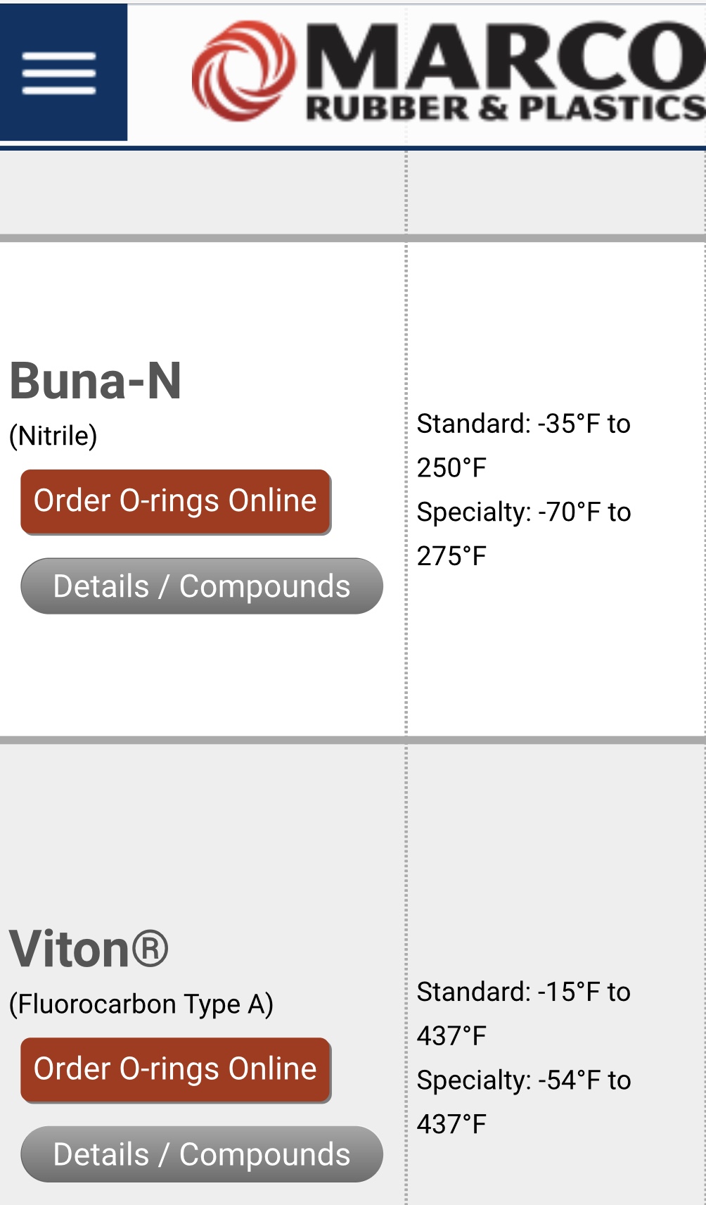

Viton and Buna are two of the most commonly used elastomers for sealing applications and for good reason. ... While both Viton and Buna seals both serve as great sealing options at moderate temperatures, Viton is far superior to Bunafor high temperature applications.Nov 10, 2014
I put in the o-rings that came extra with the gun, and what a difference! I also worked on the scope and shroud. I have gone from okay groups with an occasional flyer, to using Sheridan pellets for a target at 35 and 45 yards. I am currently using cast off composite wood flooring with dime size stickers for targets. Two pieces back to back. The Sheridan 20. cal won't go through, but the Nova Freedom blows through no problem. With the Tanto suppressor, all I hear is a loud TWACK. My wife can't hear the rifle in the kitchen, when I'm on the deck right out side. I can hardly wait for the groundhogs to come out to play.

General Description: Perfluoroelastomer (FFKM) is a highly fluorinated elastomeric family of compounds that provide the most resistance to chemicals and high temperature than any other elastomer in the market. FFKMs are considered the elastomeric equivalence to PTFE (Teflon) due to its excellent chemical and temperature resistance.
Pump issues.
I really think they come almost bone dry from the factory (at least mine did) and need a lot of lubrication right off the get go. I have no idea if it made any difference, but this is what I did with mine when I first bought it. I put 6 drops in, then pumped 15 times, then added a couple of drops every 10 pump or so up to full pressure. Then as remembered... That seemed to get the oil into all the parts of the pump. As far as where it goes, I've used about 1/8th the bottle and I have no l evidence of oil leaking out anywhere. The lack of evidence of oil leaking indicates to me that the pump was under lubricated at assembly. Or it's confirmation bias.
Thanks for the post Paul67. I will only use FFKM from here on out.
