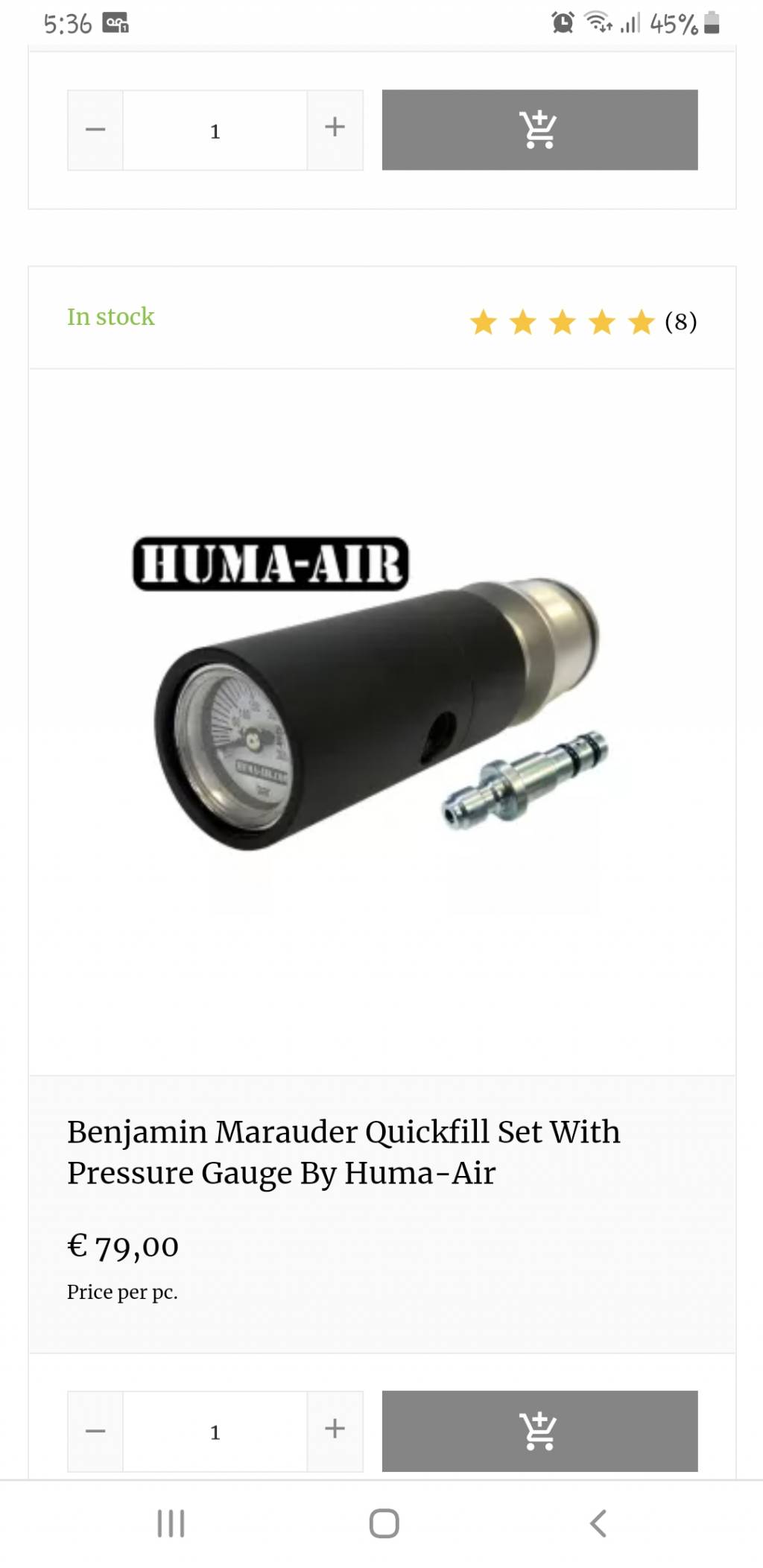

Anyone know where I can find front guage for the Prod?
I installed a huma reg on my prod. My pressure guage now shows only the reg pressure. So I do not know when it is low until it go past the set reg. I found a front gauge by huma for the marauder rifle. It is exactly what I need to install on my prod so I can have a tank guage and reg gauge. Except huma only make it for the marauder rifle. Anyone know if there is one made for the marauder pistol? I can't find it anywhere. Can't believe they made one for the rifle and not the pistol. ;(

I've bought one of their Quickfill set ups for my huma regged mrod when they first came out & even though i wasn't happy about having another fill probe to keep track of i'm really happy with it. I also have a huma regged prod that i hoped they would make one for? My guess is that the demand just isn't there for the prod! Anyway after reading Darkhorse 196's post i wrote Magnum Air Power about when they would be back in stock? I like his set up better than the Huma,especially with no fill probe & the gauge on the side.
The version with the bust-disc has been discontinued, the new version with only a gauge is scheduled for production this spring, no exact ETA on that yet.

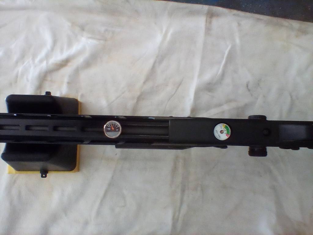

These are pics of modification I have done to my Benjamin Armada. I have the Huma reg. installed. I had the Huma gauge as well, but did not like looking straight down the barrel to see fill pressure. I decided to add the second gauge directly into the tank without a second gauge block to keep as much volume as possible. After some indecisive moments, I drilled the hole, tapped for 1\8 NPT, installed gauge with some Teflon sealant. I have achieved 50 shots @ 1750 PSI with zero leaks. Couldn't be happier. Lots of other custom changes, shoots great.
I checked Magnum Air Power. They have one with the gauge on the side. That would look funny and ugly having a gauge to one side right at the end on the fill nipple. I prefer the one like huma made for the marauder rifle. I dont get why people are so against having the gauge at the end on the barrel. Are you looking at the gauge with the gun cock and loaded or what? If it ain't cock and loaded, then shouldn't be a problem.
Been looking on Google and haven't found anyone who makes a quick fill with a gauge at the end. Guess just keep shooting till it goes off the reg for now.
