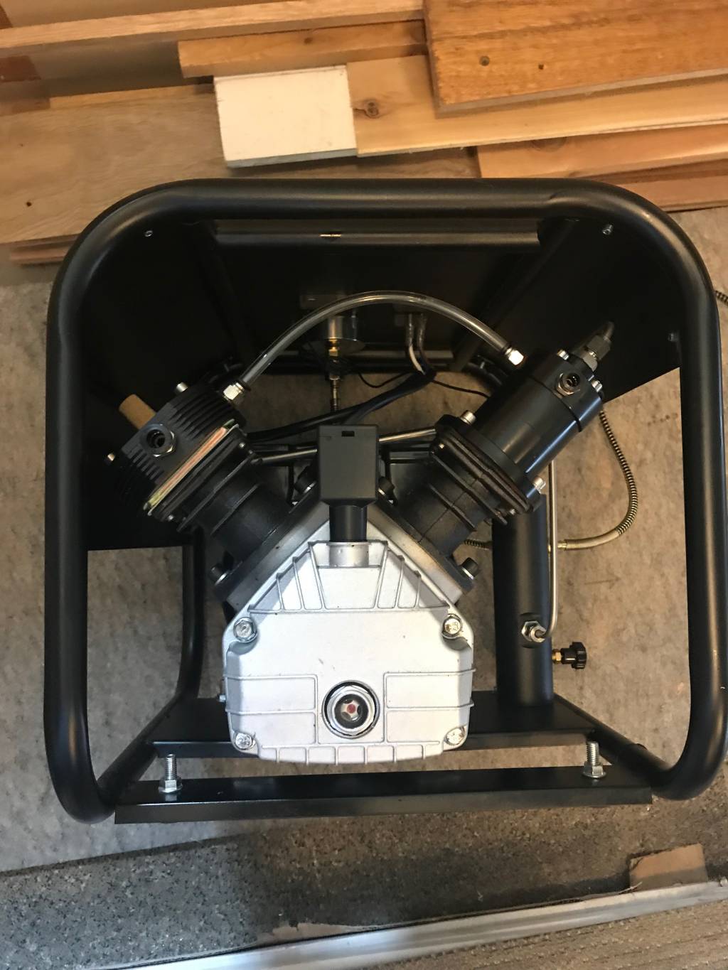

Hi all, just wondering if someone has the schematic of the piston pump of this Chinese made compressor.
I had a short circuit while running it and it wouldn't start up again. Went to a friend to try sorting it out and ended up taking it apart and cleaning it. It was very dirty inside, especially in the tube where the air bleeds out. Anyway, got the pistons moving again after reassembled, air was pumping out but unfortunately, by tightening the air valve lock, air would not able to pass thru. hard to explain, but I was hoping someone would have a diagram on showing how the internal parts goes. Maybe we did something and caused the blockage.
thanks.
Alex
thank you very much chickenthief for the link. It is not exactly the model I have but the write up was very informative. Too bad I didn't come across this article as we had made some critical mistake in taking the compressor apart, without any clear knowledge of what to do. We did clean all the oil contaminants and rust that got accumulated inside the unit. We found the split rings were broken and to make matter worst, we lost the Reed Valve Wafer.... hopefully we can find the replacement parts and get this compressor working again.
