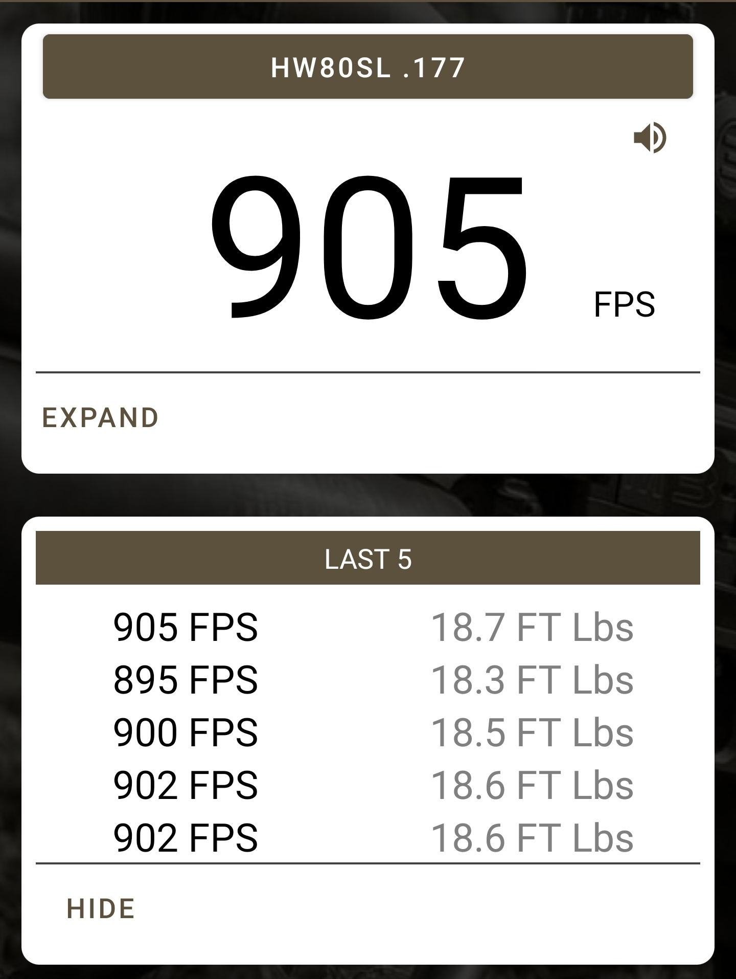

My HW80 is one of the few springers I have that really NEEDS a full blown artillery hold by the books. These were JSB 10.3s. H&N 10.65 pellets are a good 75fps slower
What in the hell spring set up are you using and it must be crippler on the arm as the short stroke and a bit longer breech block don’t lend it to the golden ratio of cocking. That being said ,some guns are just overachievers.

I have no idea. This is one of the few springers that I own that I haven't done anything to myself. I picked it up through the classifieds for like $300 assuming something had to be wrong with it. Nope. Just a basically brand new tuned HW80SL with what looks like a Venom muzzle brake for $300
One day I'll get bored and tear it down and take some measurements but until that day comes its a mystery to me.
