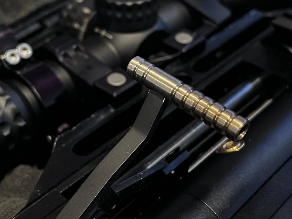

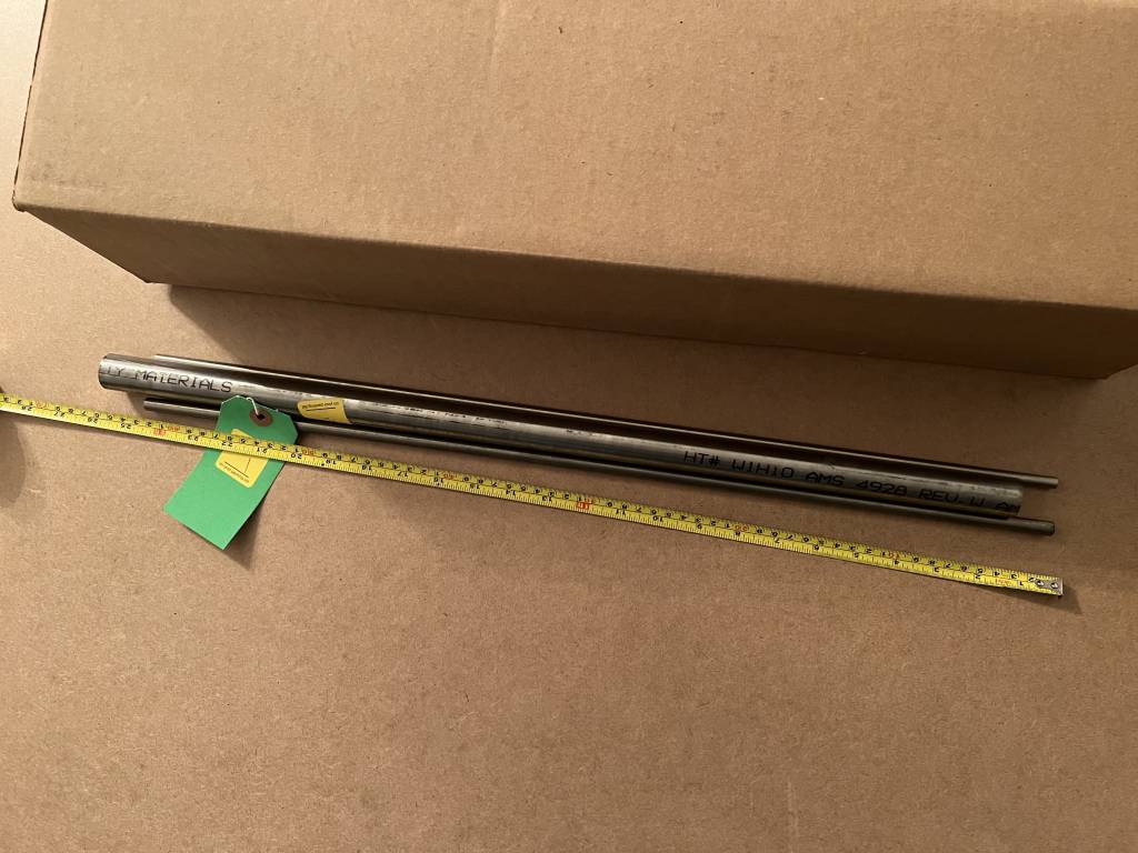

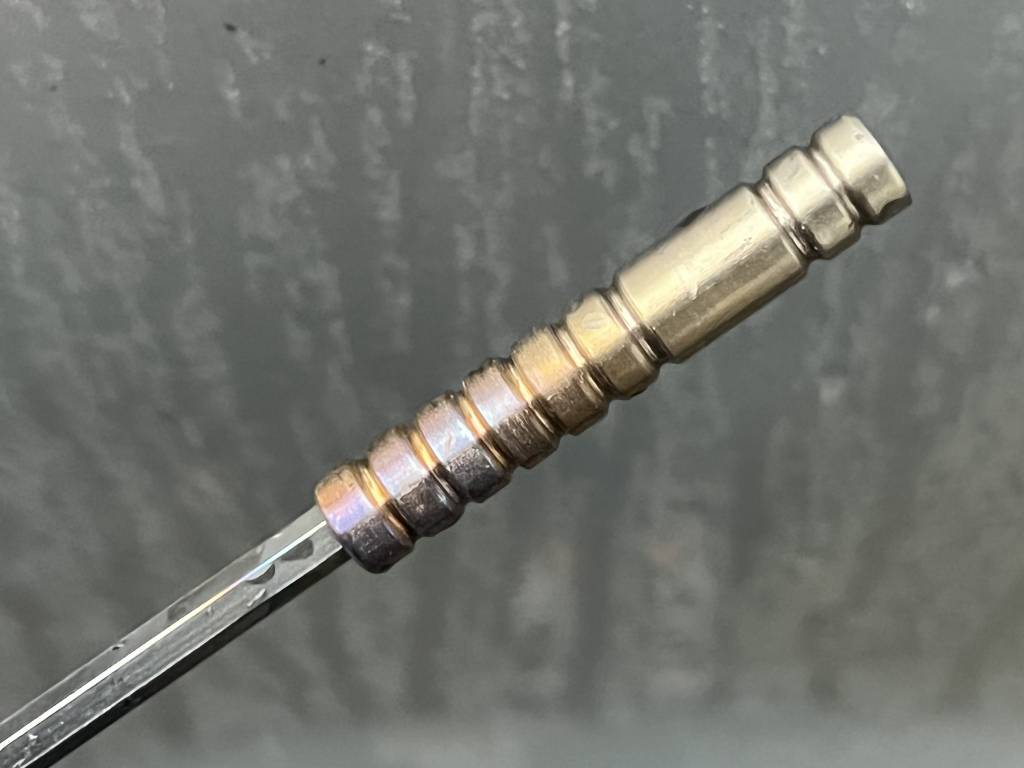

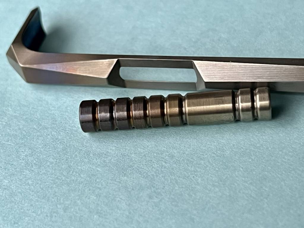

I've had good results in the past with heat anodizing titanium parts (which can always be polished out with something like a green Scotchbrite pad). So I made a little test handle using my very last little scrap piece of titanium, and that gave me some other ideas that I'm anxious to make:

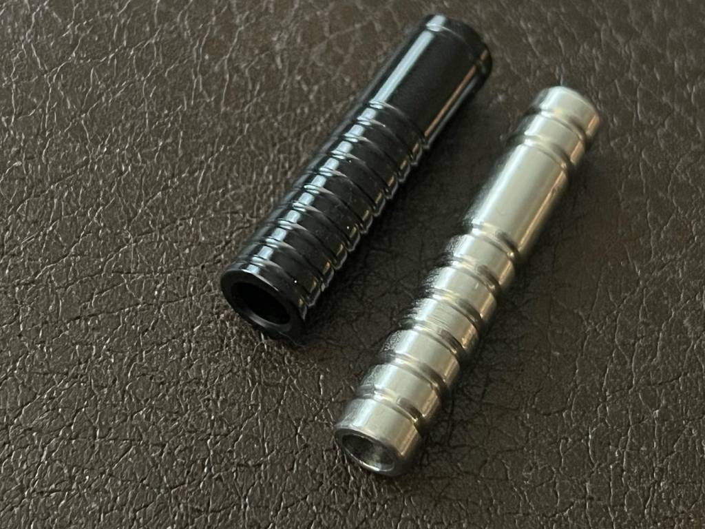

3. Lever handles - I find that I like the deep grooved handles the best (you can always slap some o-rings around them for added grip if need be), but I can also knurl them.
Personal note, the additional length of my new handle totally changes the cycling action. I've used this rifle in the past 5 NRL22 matches, and I already had a solid picture of the geometry that I wanted for a new lever.

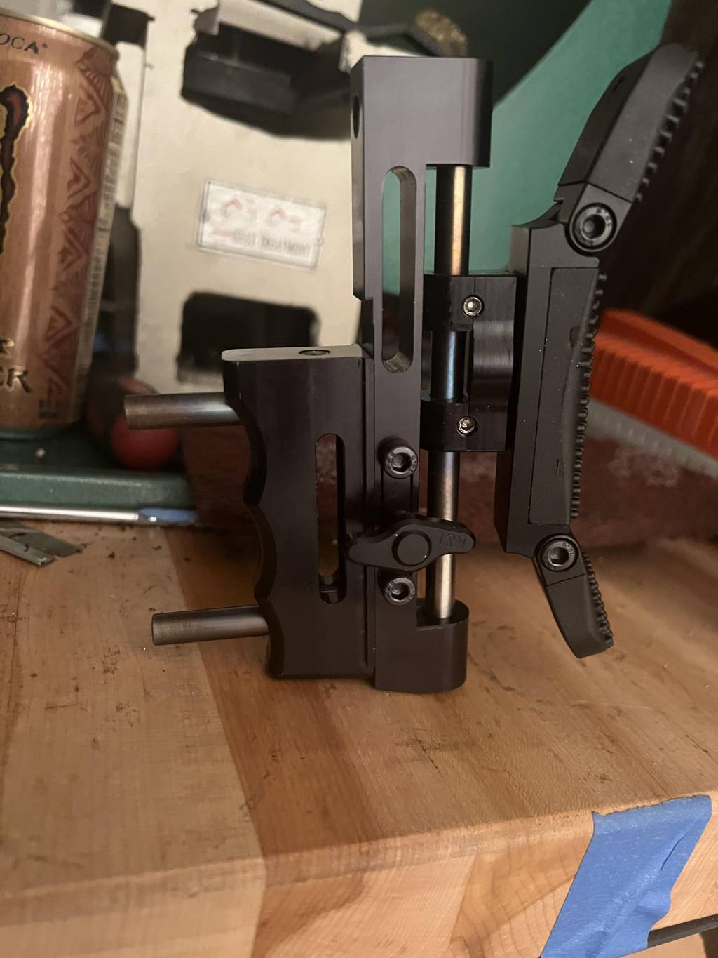

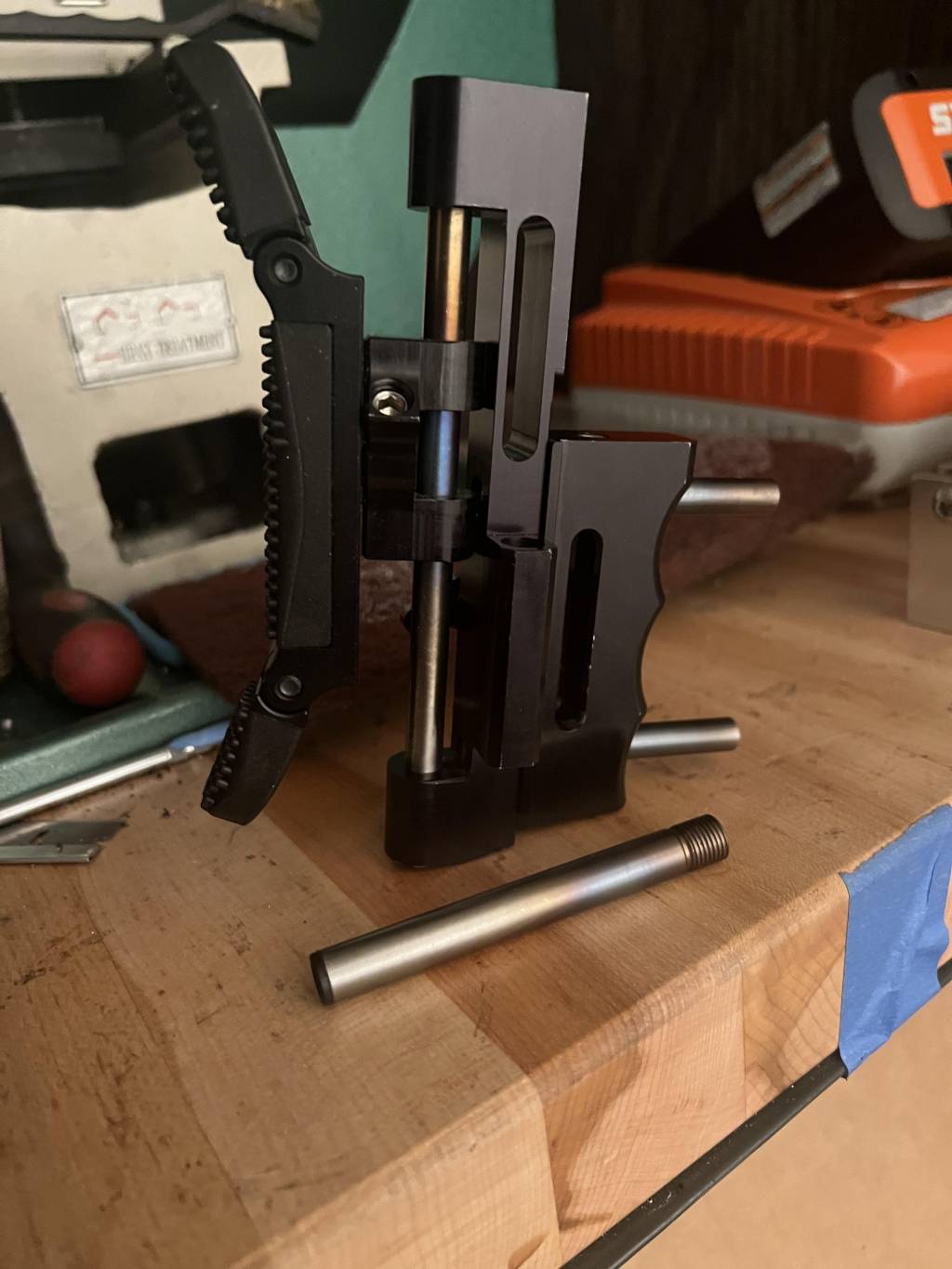

6. Replacement extension rods for the K&L stocks - would be another cool and subtle aesthetic (I'm planning to replace mine with heat anodized titanium)

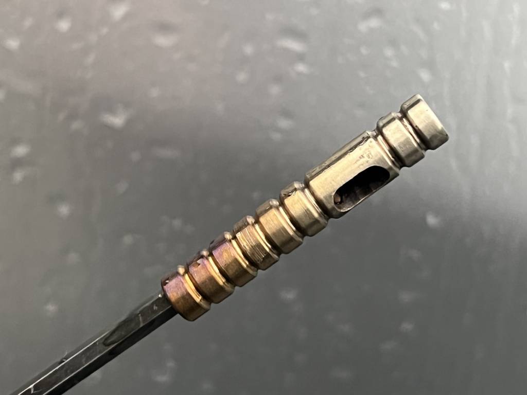

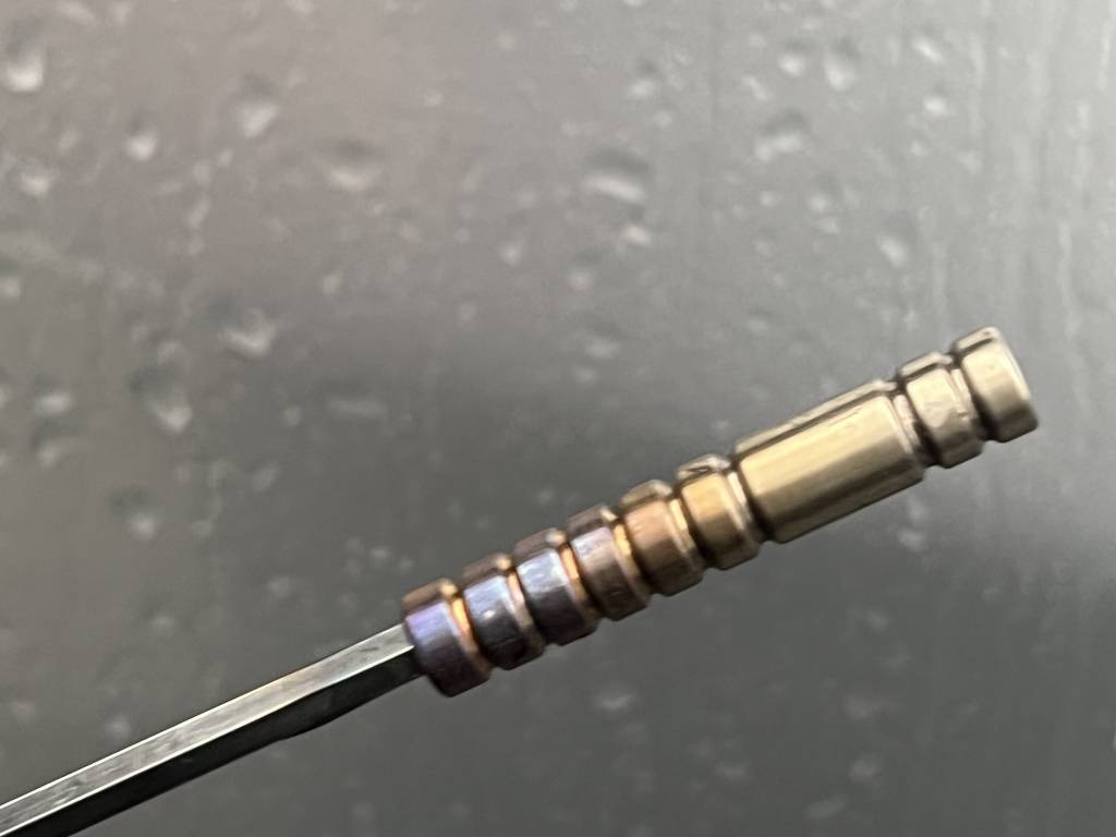

It's tough taking photos today (dark and rainy day here in the PNW), but here's some examples of the burnt / oxidized color spectrums that appear in the surface with some heat. My lever handle is just a rough scrap that I grooved, so the bumper case is a better representation of what a machined finish looks like (I dig that lighter straw greyish tone personally):
Again, the coolest aspect of doing this with Ti vs. other metals is being able to "wipe the slate clean" with a green scrub pad and reapplying heat to change the appearance.

You aren't "anodizing" the material..! Anodizing is a chemical process that takes time, various chemical baths, AND money.
You are just putting heat to it, and the heat...does the coloring ! That's NOT anodizing. While titanium can...be anodized, it's not done as you speak, and it's also not cheap. It's also not very durable. Some consecrated rubbing with a dry thumb would eventually remove the color.
I have an older car that uses a hood prop rod. I made one out of titanium. I had to bend it in a few places. I liked the color that it left from the heat, so like you, I warmed most of the rod to produce some nice colors. And, as you say, that coloring is also...not very durable. It does scratch easily.
Also note, titanium is slightly heavier than aluminum.

LOL, well I wasn't expecting a know it all type to chime in and "correct" me for some time, but I'm not surprised you got me so quickly. Go ahead and pat yourself in the back Mike, job well done!
For the record, I can anodize the parts or "heat oxidize" the parts, depending on what is desired. The latter just looks cooler, and as I've said can be erased and redone pretty easily.

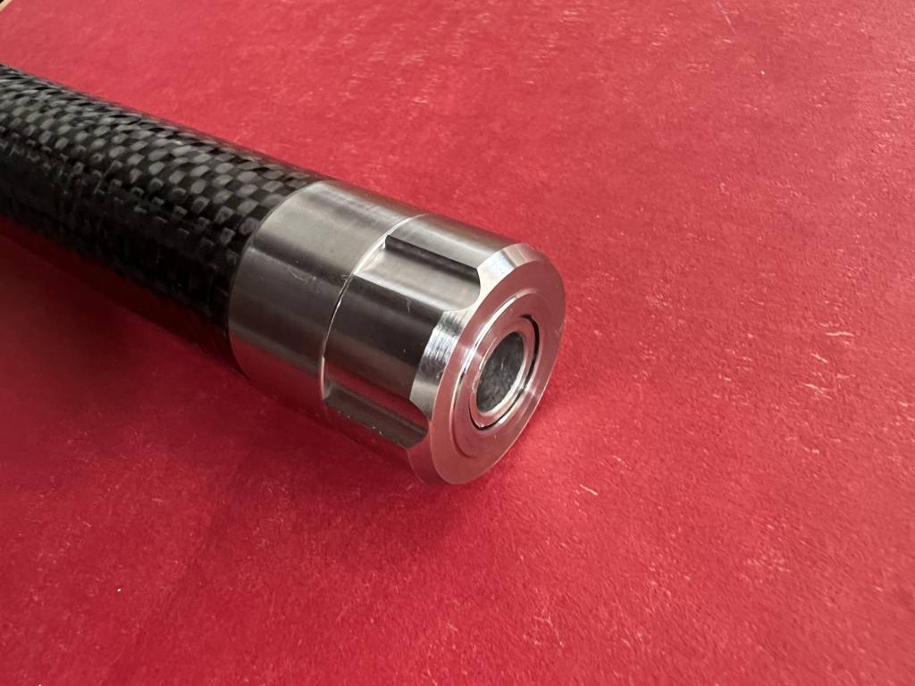

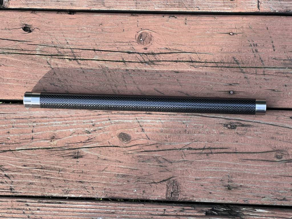

Well these were definitely not cheap to make, but this is the first shroud designed for a 600mm FX barrel system..

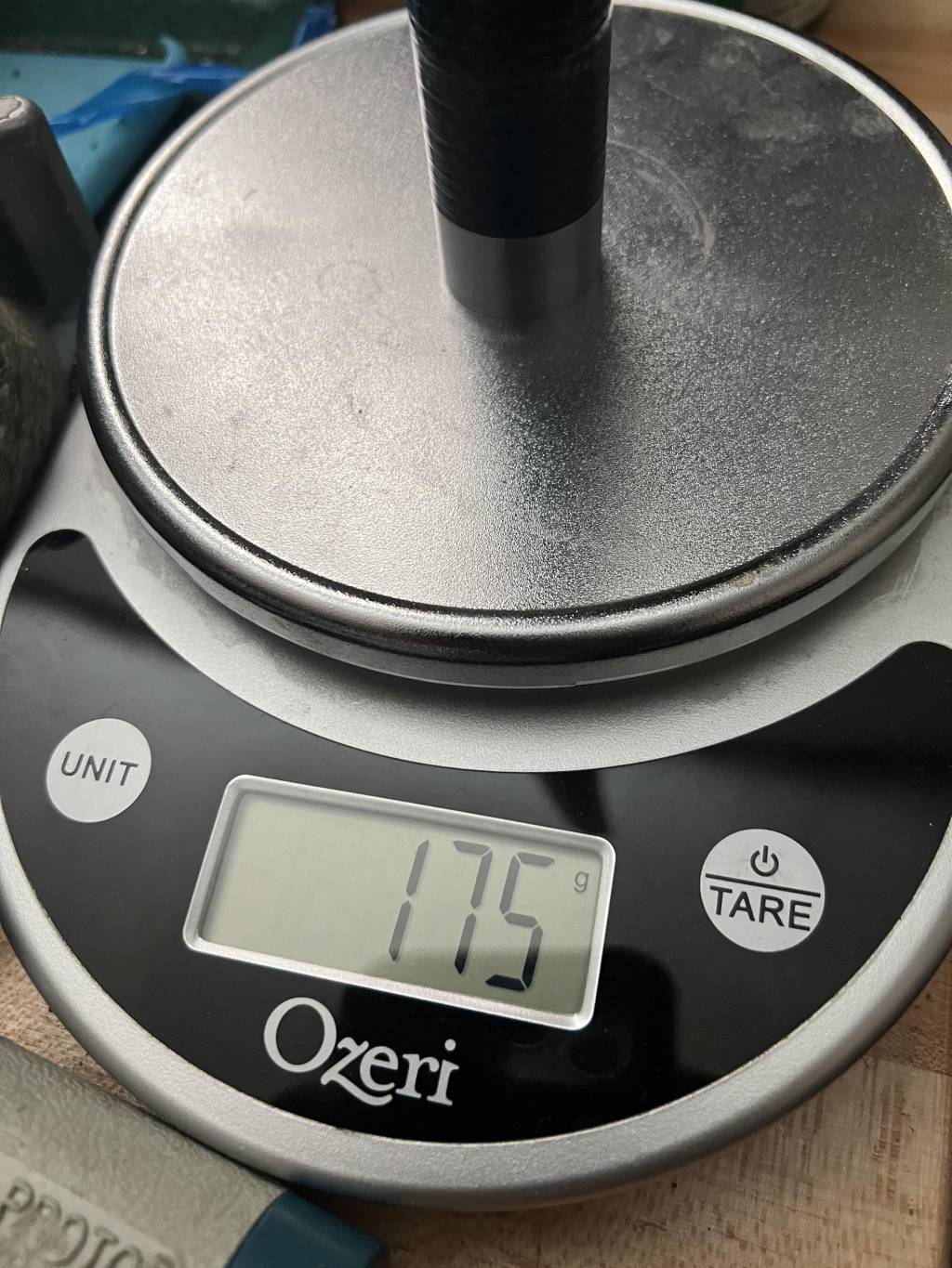

Weight overall is 175 grams..
Wound up using some high modulus CF tubing from Rock West. It cuts VERY clean with carbide on the lathe (zero fraying or issues like cheaper overseas made tubes).
Reactions: 2L8 and DaveSa
Nice machining on that shroud! Beautiful piece of craftsmanship. Yes, those cheap tubes splinter very easily if you get overzealous when cutting them.
Thanks! This carbon fiber tubing is SOLID, but it also has some precision tolerances that I was looking for (it took me a few months to decide on the tubing specs).
It was time consuming getting everything concentric. The muzzle endcap has (3) bores and everything is machined to be "press fit" inside and out.

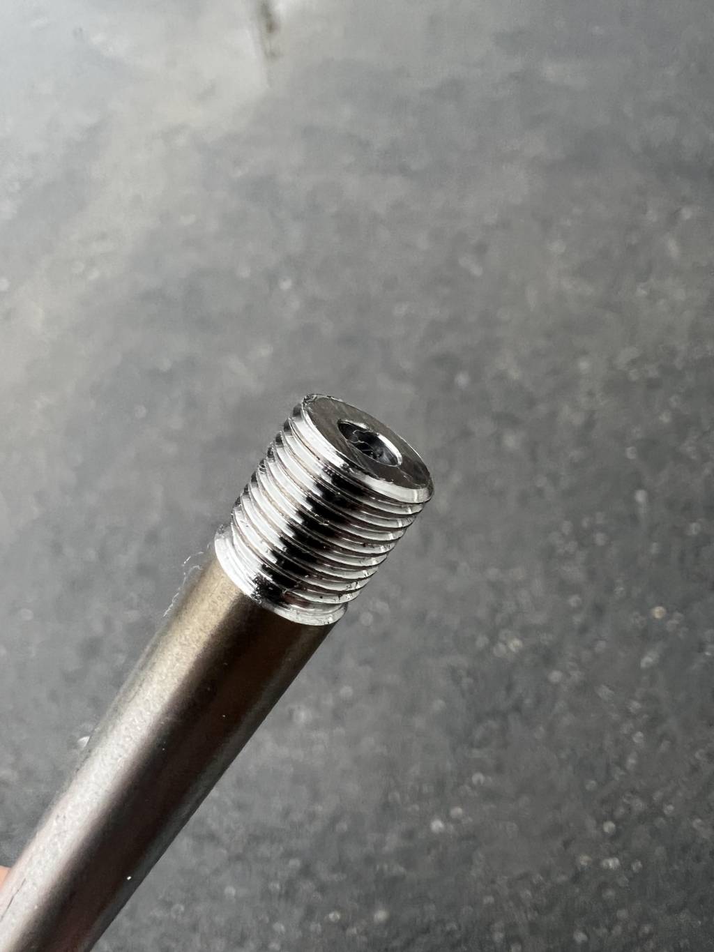

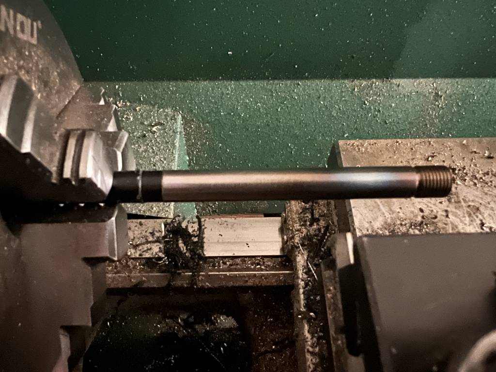

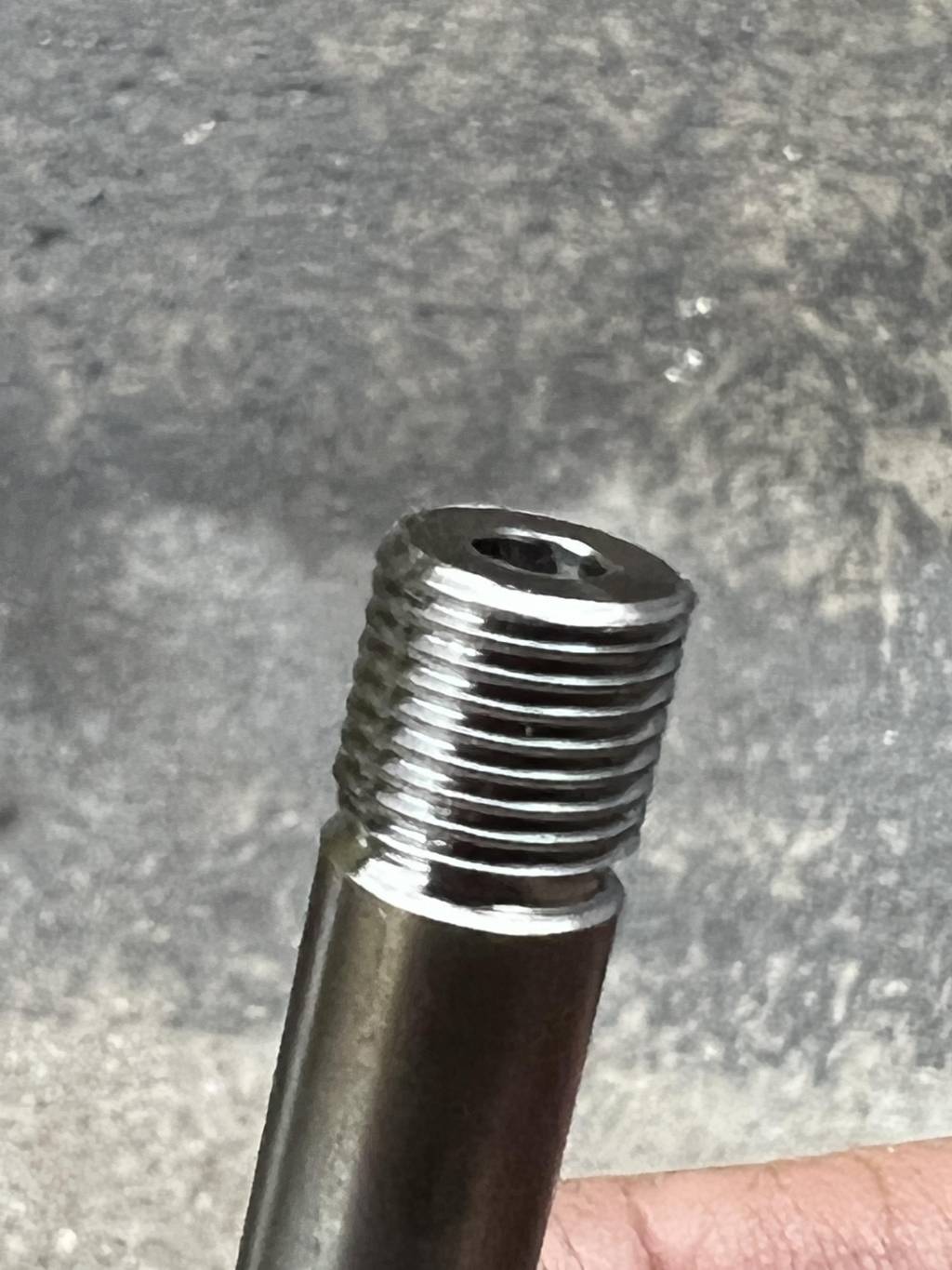

For this specific "FX compatible" shroud (and other 14mm OD barrels with a 1/2-20), I made a gauge from steel and went in to the titanium with a micro tool for the larger counterbore. I removed a few mics of material at a time (all the way to the internet shoulder of the 1/2-20 threading bore) so that the end of the 14mm barrel snugs into the endcap before it threads in.
I also added o-ring grooves for 14x1.5mm internal Viton / duro 90 o-rings, but man the precision fit feels superb when I slide them over the barrels!

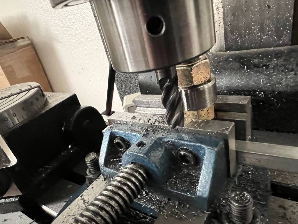

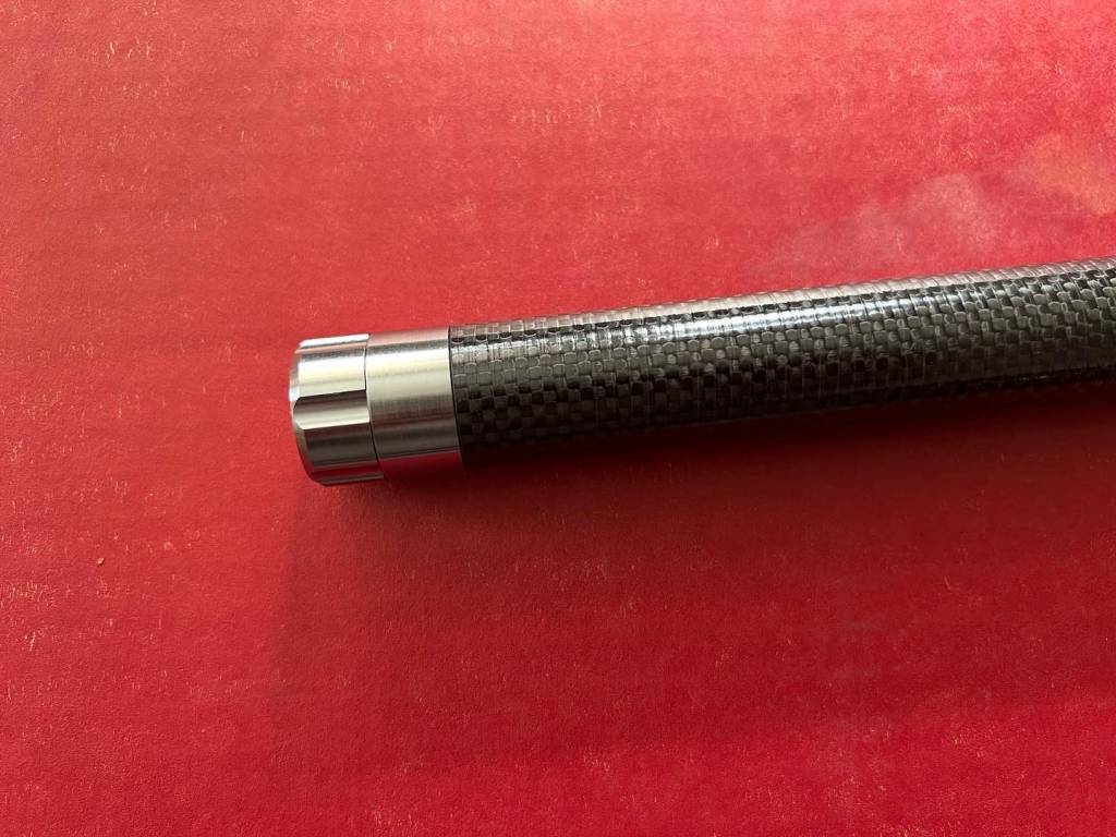

That thread protector came out pretty cool. I had made a knurled protector, but my knurled were dull and I wasn't real happy with it. So I figured out a clever way to chuck the protector using two hex nuts clamped down on a 1/2-20 cap screw. The hex nuts were aligned in a way that allowed me to easily index the part in a little vise on my mill so I could just use the Y-axis and mill 1mm deep with a 3/8" carbide mill:

Here’s one idea for you and that’s the valve knobs on the impact and the valve knob stem. Maybe add a 5th line out since some folks go out past the 4th line, and maybe halfway in between each line a dot or a slight detent crater.
on the valve knob keep it looking like the M3 with the acorn look as it’s easier to grasp but on the rear edge of the valve knob closest to the trigger block some reference/index lines of various lengths like the MK2 valve knob had.
of course the innards of the M3 valve knob would be transferred over to your design, if you decide to do it
There are a whole slew of things one could make and sell for Mavs. I know there are plans for many things, but it just seems nothing is coming to market for these and are taking a backseat to all things Impact. Personally think titanium is overkill for most pieces unless you need high strength and lightweight (like valve pin maybe). If someone actually was making Mav carbon fiber shrouds with tensioning I am betting you they would be busy. Obviously aluminum would be a lot cheaper there and probably all that would be necessary. Hammer weights would also be one that people might jump on.
As far as titanium, I would think the actual cocking linkages would be a much better use for the price incurred. .
