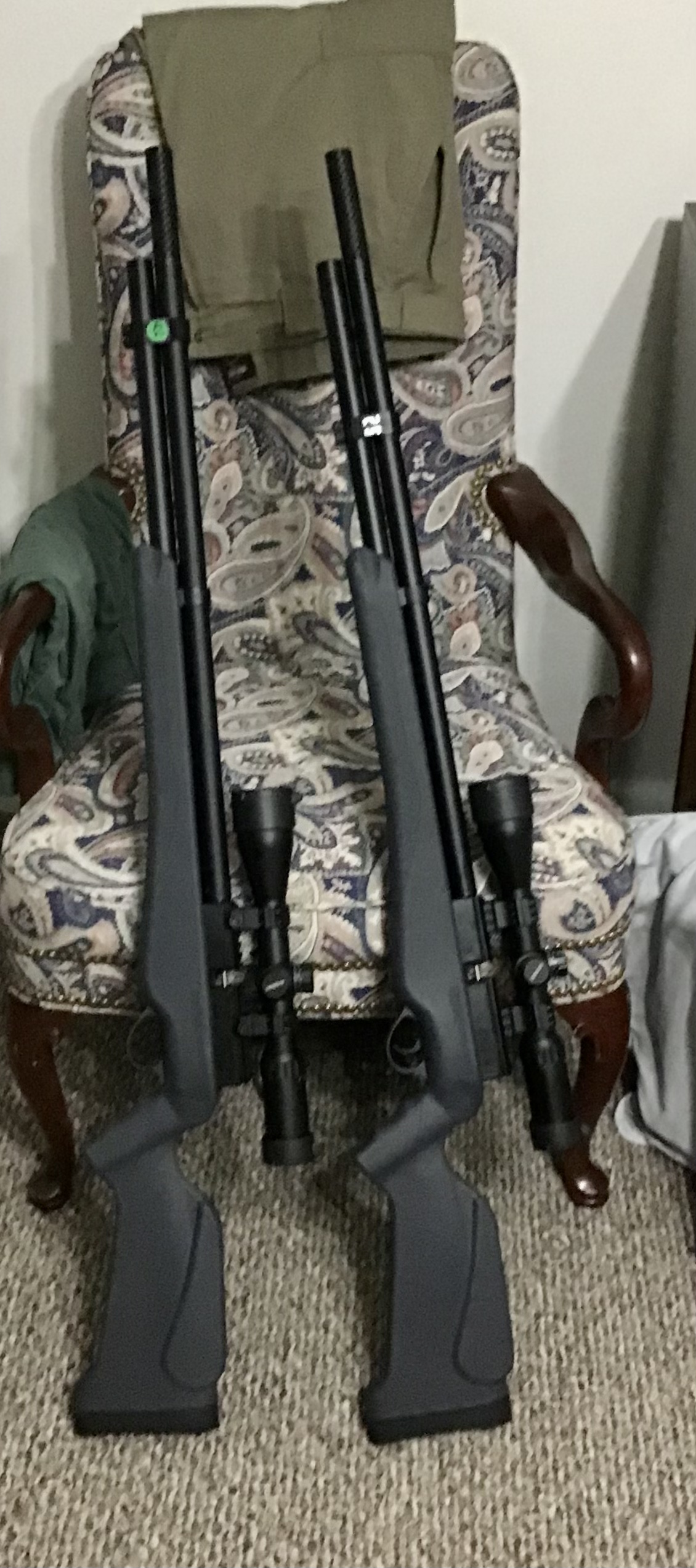

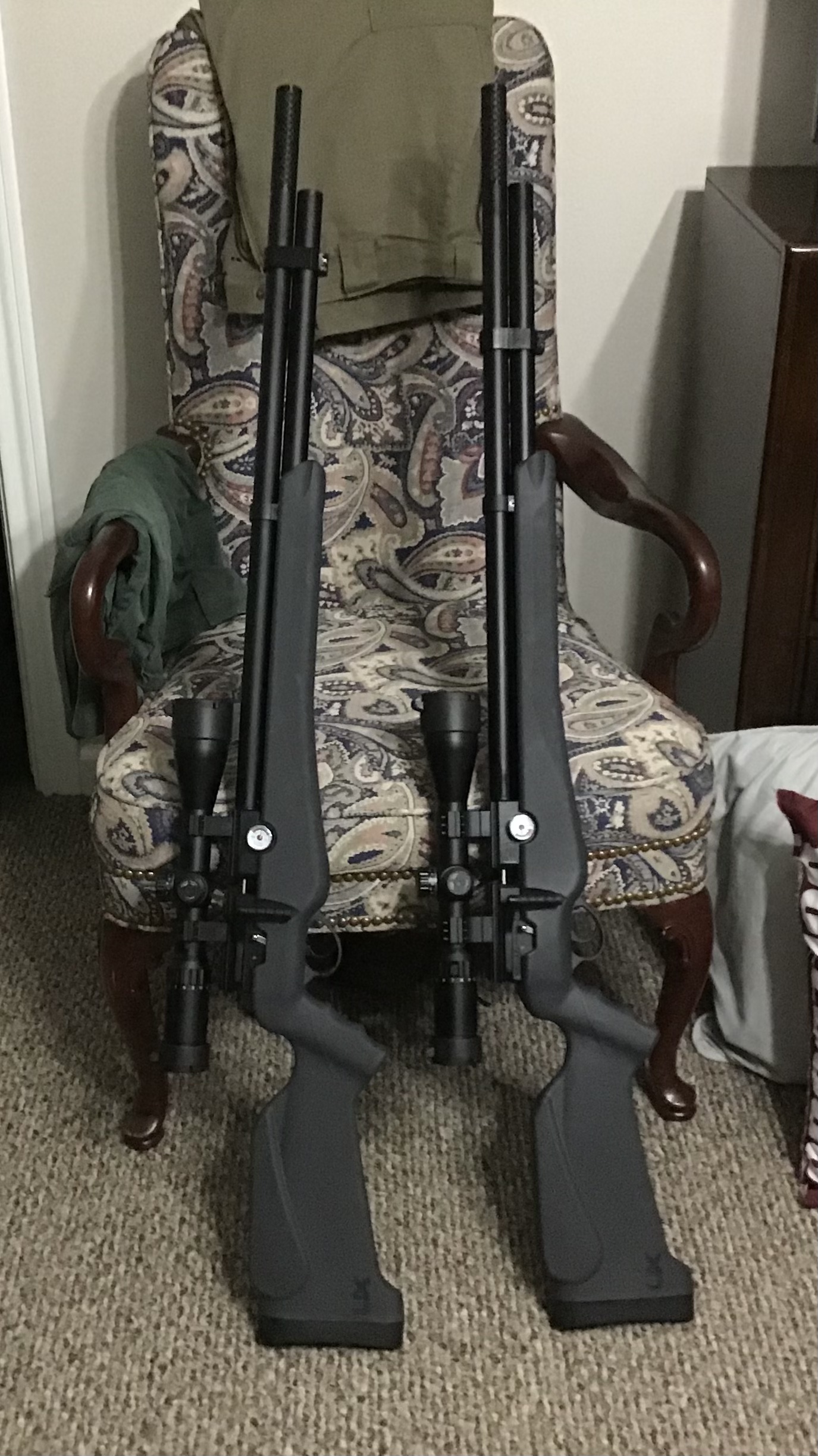

Anyone install a regulator in a Umarex Origin ?
My .22 Origin is two years old and still going strong. Just bought a Origin in .25 . Less than three years from purchase Umarex will fix problems under warranty you pay shipping to and from Arkansas. I am thinking that when I do have a problem(hopefully after three years) I will remove the "everpressure" system and install a regulator if possible. I know there are many warnings of "if you disassemble this you will DIE ! " Lawyer stuff I reckon. What say you ?

I too love the Origin for what it is. I am very happy my tunes on each. .22 for shot count and .25 for light varminting. My big thing is keeping them going down the road. If I can reseal them when needed and have the ever pressure system working that would be my 1st goal.
