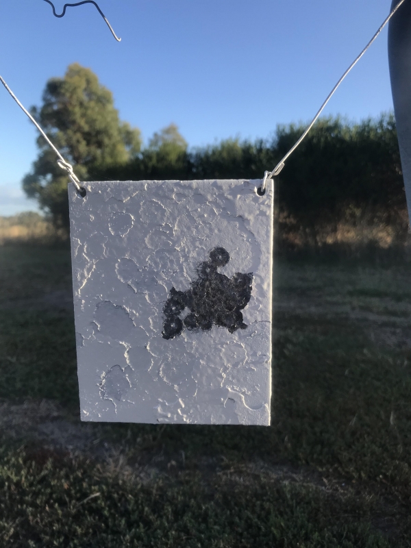

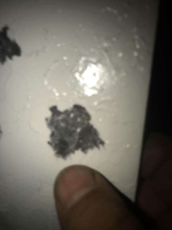

I’m convinced the st-x is a step up from the st. I have a Crown in .25 and an Impact. At 100y shooting the 25.4 jsb’s sub inch groups are frequent.
This is typical. 100y washed but not sorted 25.4 jsbs. That is 16 shots.
This is the best group I’ve ever shot. 5 shots under 1/2 inch at 100y.
When it’s calm at 100y shooting quality pellets at the right speed you will get sub inch groups. They just start landing on top of each other.
Ive shot a lot of with my standard smooth twist barrel and it’s a good barrel but the st-x is better.
