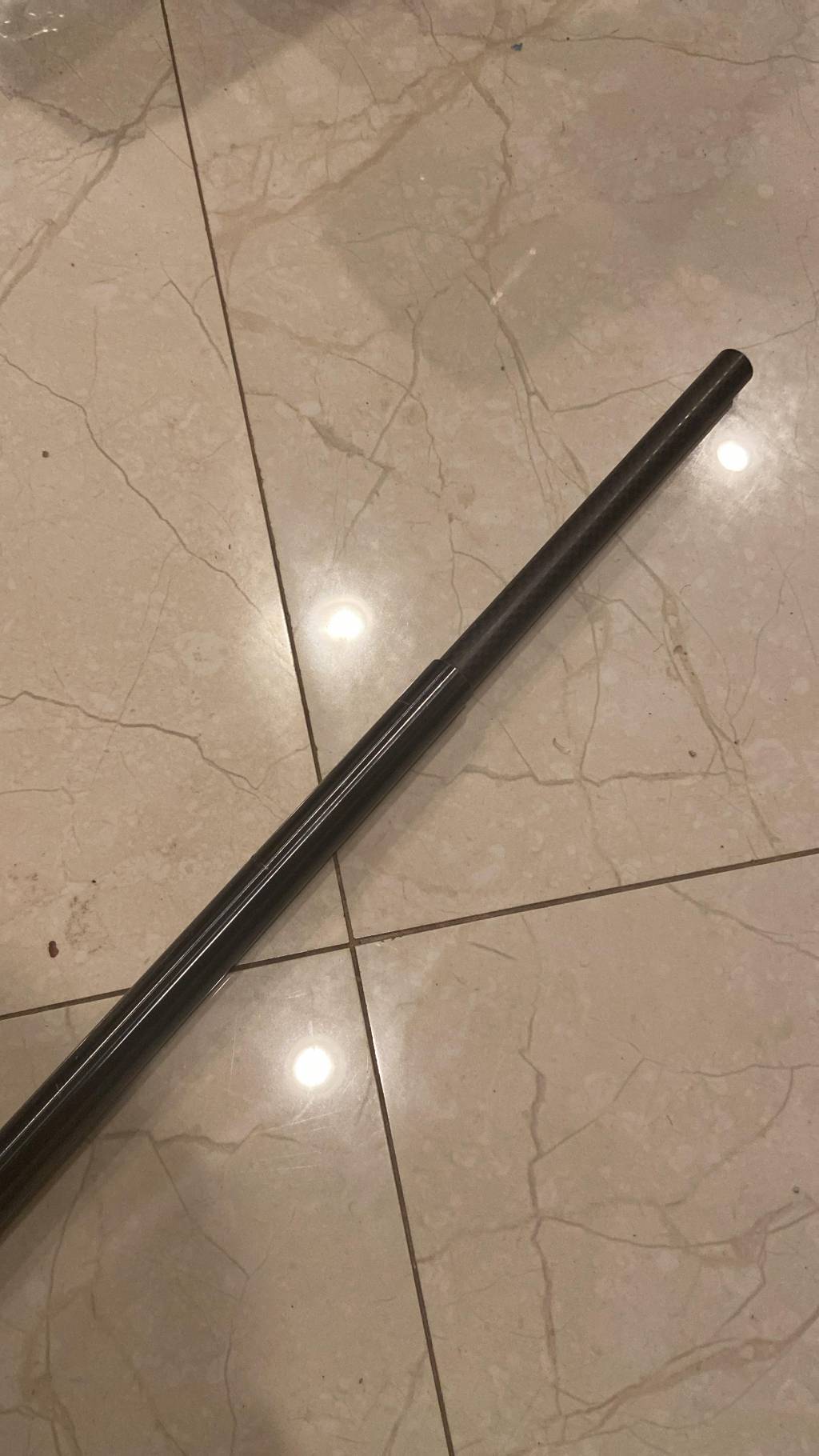

Anyone have the problem with impact cf sleeve?
My carbon fiber sleeve now stuck in the housing.
I try all I can do but can’t move it at all.
Anyone have idea to help me out?
There is slight differences in some sleeves ID, we're you trying to slide it in first time? What I would do would be put the sleeve in a padded vise and put the CF in a drill chuck and try to spin it out. I was opening the ID of a CF tube with a dowel and sandpaper. It got bound up really good and had to beat the wood out of there was not easy.
A welding glove folded over is a good way to pad a vise. The rough leather gives good grabbing capability while not messing with the finish. Obviously try to clamp the area the CF is not inside of. Good luck.
