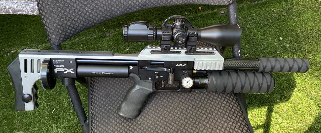

Mine Detuned To .177:
ammo 10.5 CP
speed 750fps
reg 110
hammer spring length 50mm
no hammer weight just delrin spring guide
STX pellet liner 500mm
-1/2” at 50y
shot count 70

Shot count 70? This doesn’t seem right, my impact (admittedly 480cc) would do 500+ with jsb heavies
