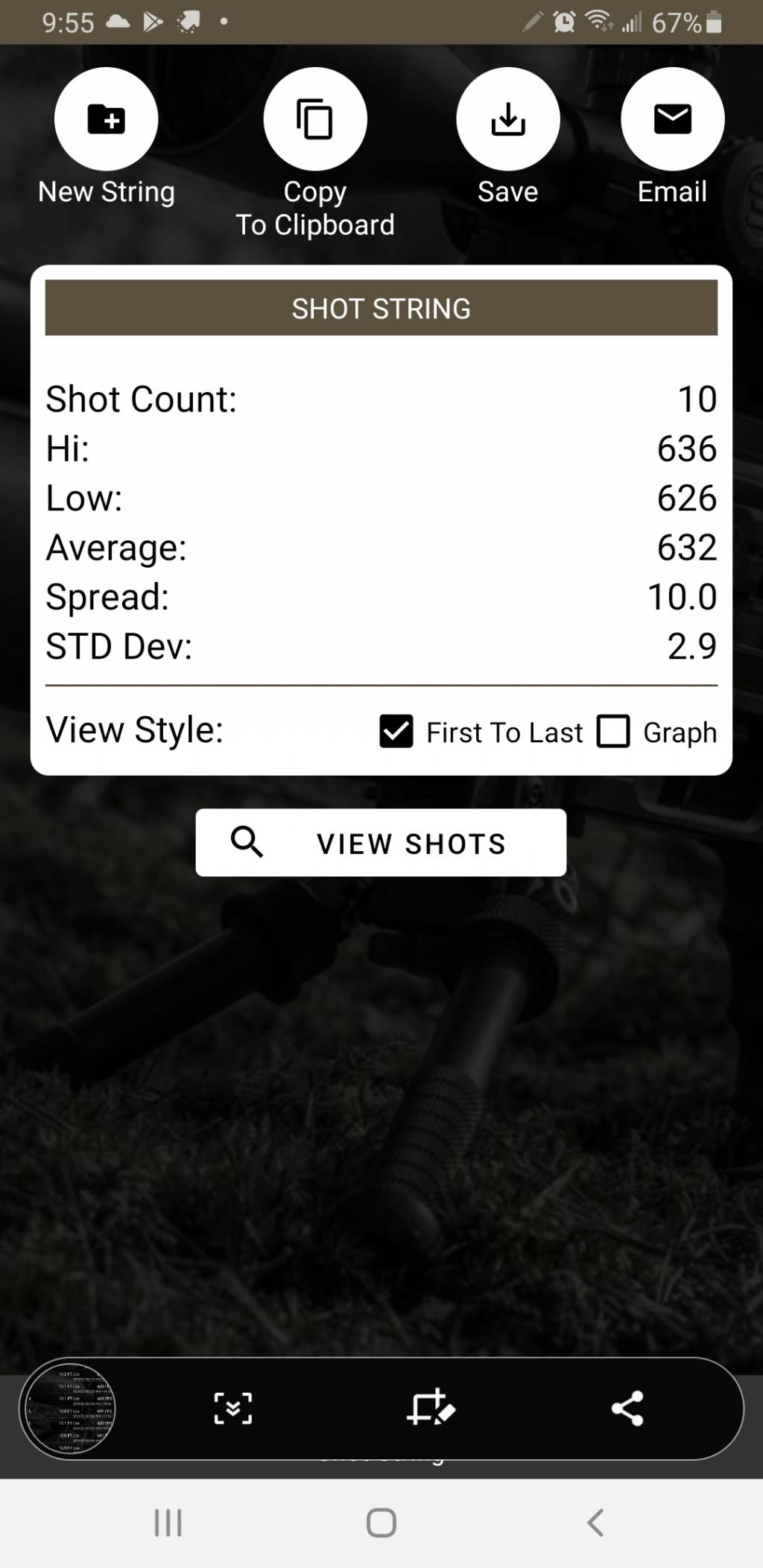

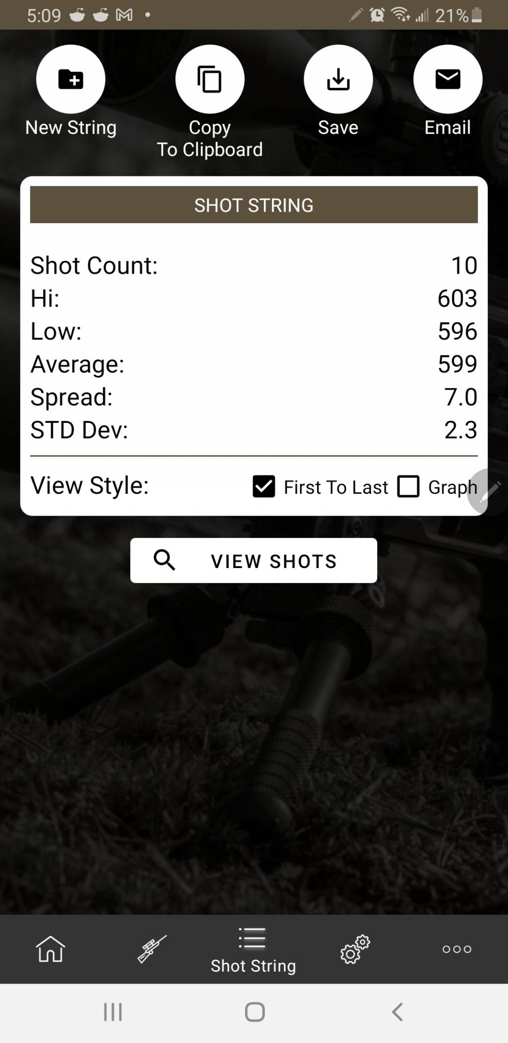

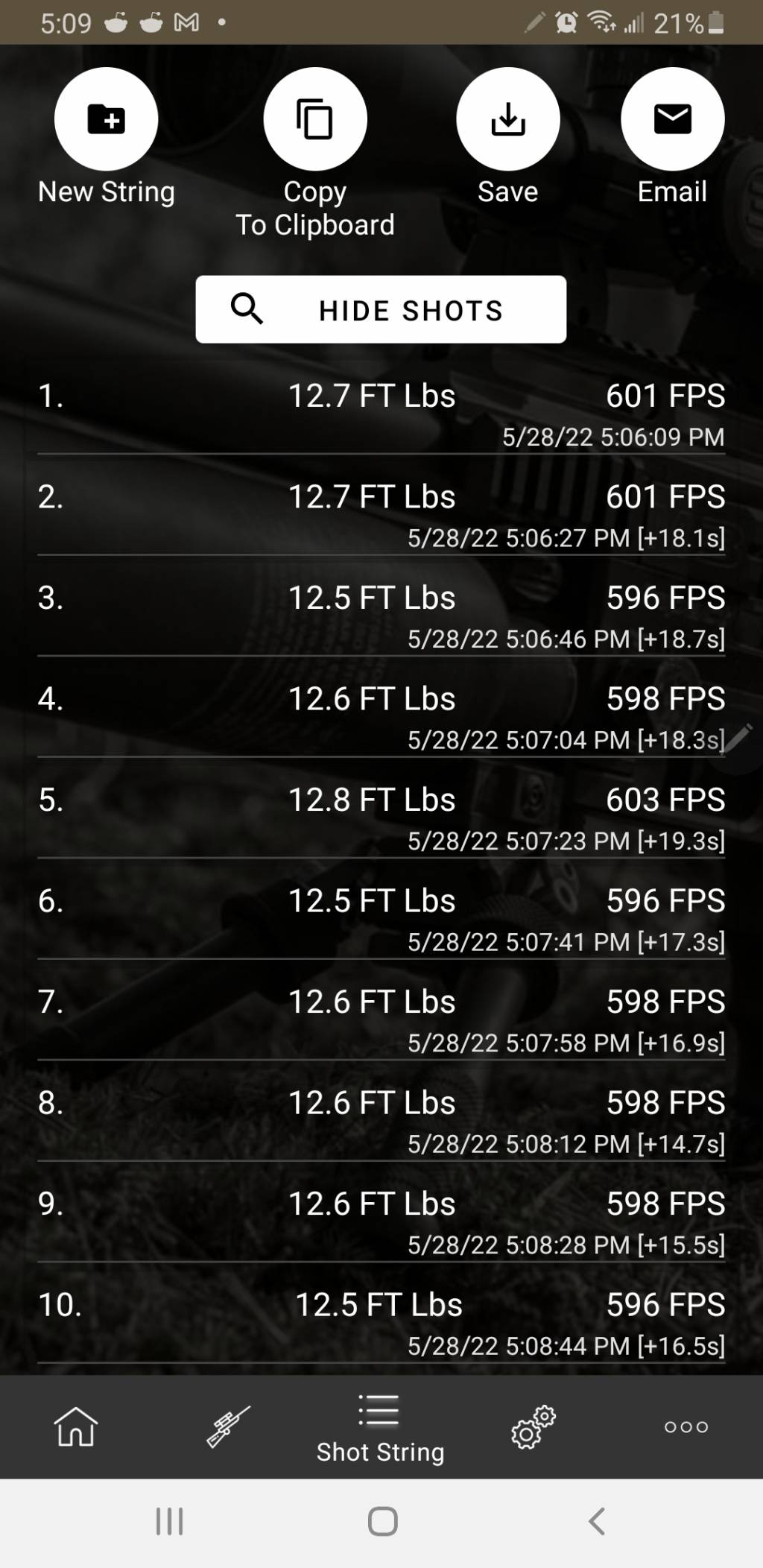

I have a .22 35E which I know is a silly caliber for that gun. It seemed fun and it absolutely is. Currently I'm running an ARH kit and putting 15.89gr JSBs out at 600fps (12.7ftlbs). The kit is extremely smooth and I am very happy with its consistency.
My only complaint is that the gun is pretty hold sensitive and has a pretty modest amount of recoil. I was hoping someone here may have a little insight on where to go from here. Snip a coil? Toss the piston in a lathe and lighten it up some? Maybe just be happy with 1" at 30 and stoked when it does better?

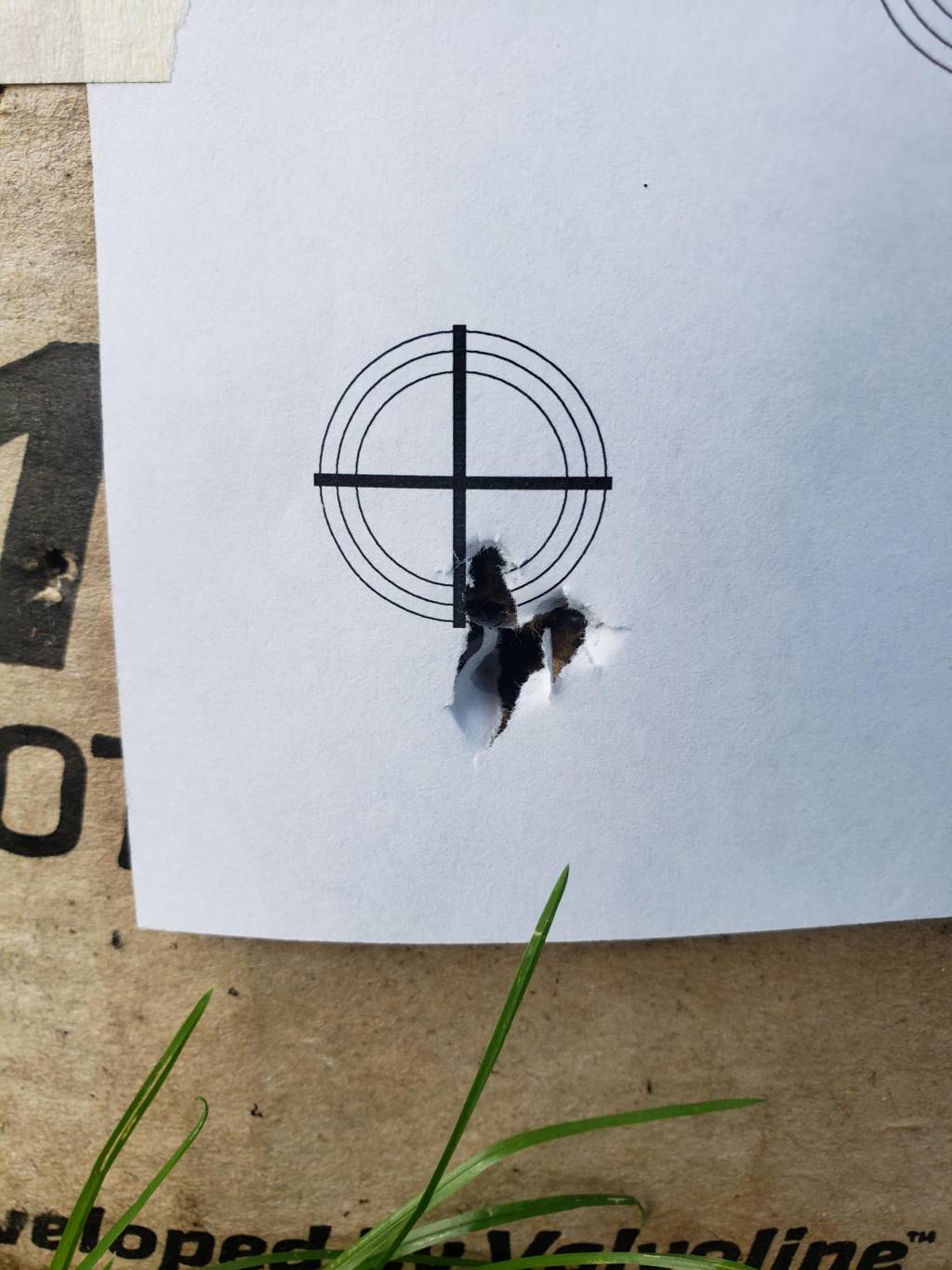

Edit:

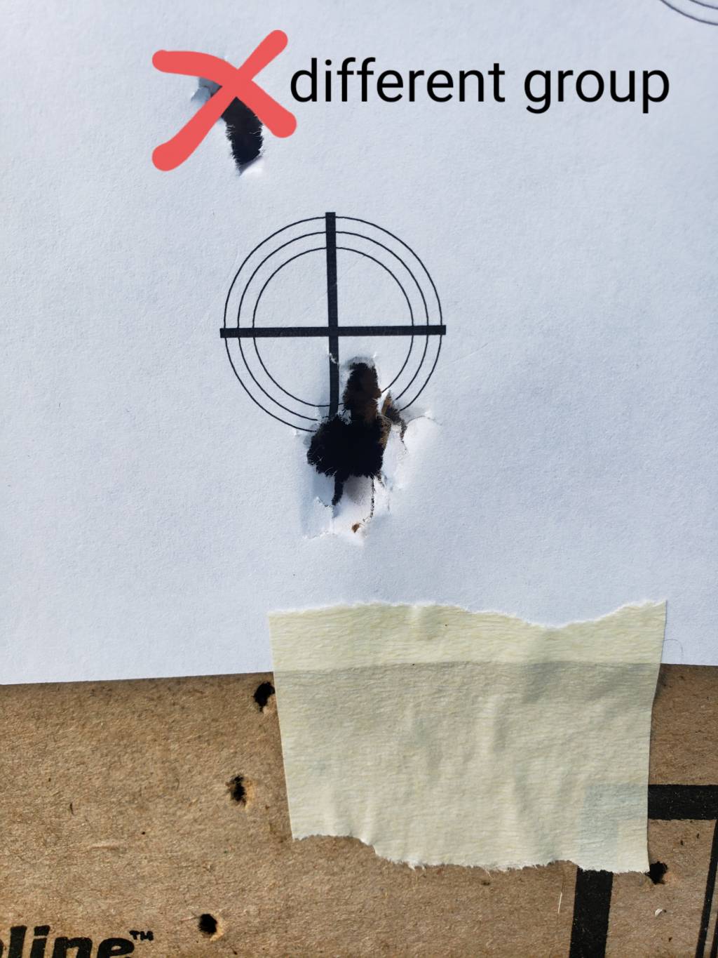

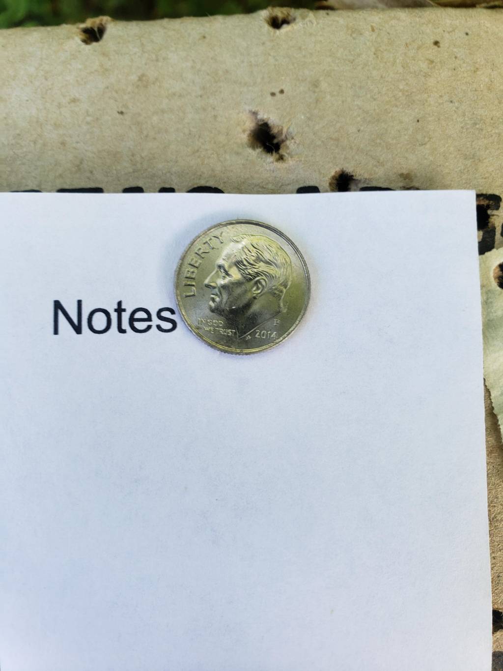

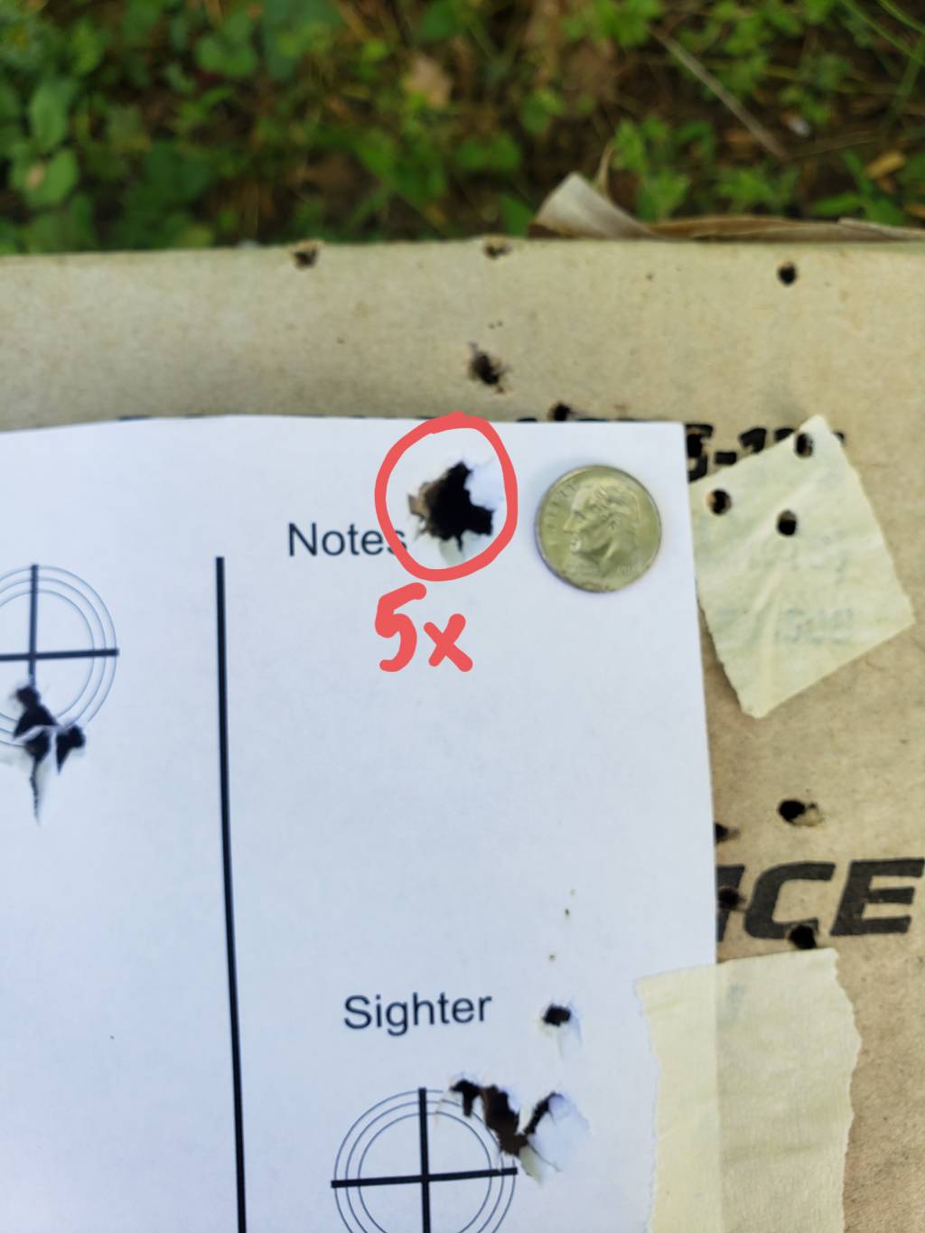

Decided to play around with some pellets and thanks to a friend's advice, gave the JSB 18s another go. They seem to group much better than the 15s and I'm really not losing an absurd amount of velocity. Definitely on the sensitive side for holds still but progress is progress.
2x 5 shot groups at 30yds
