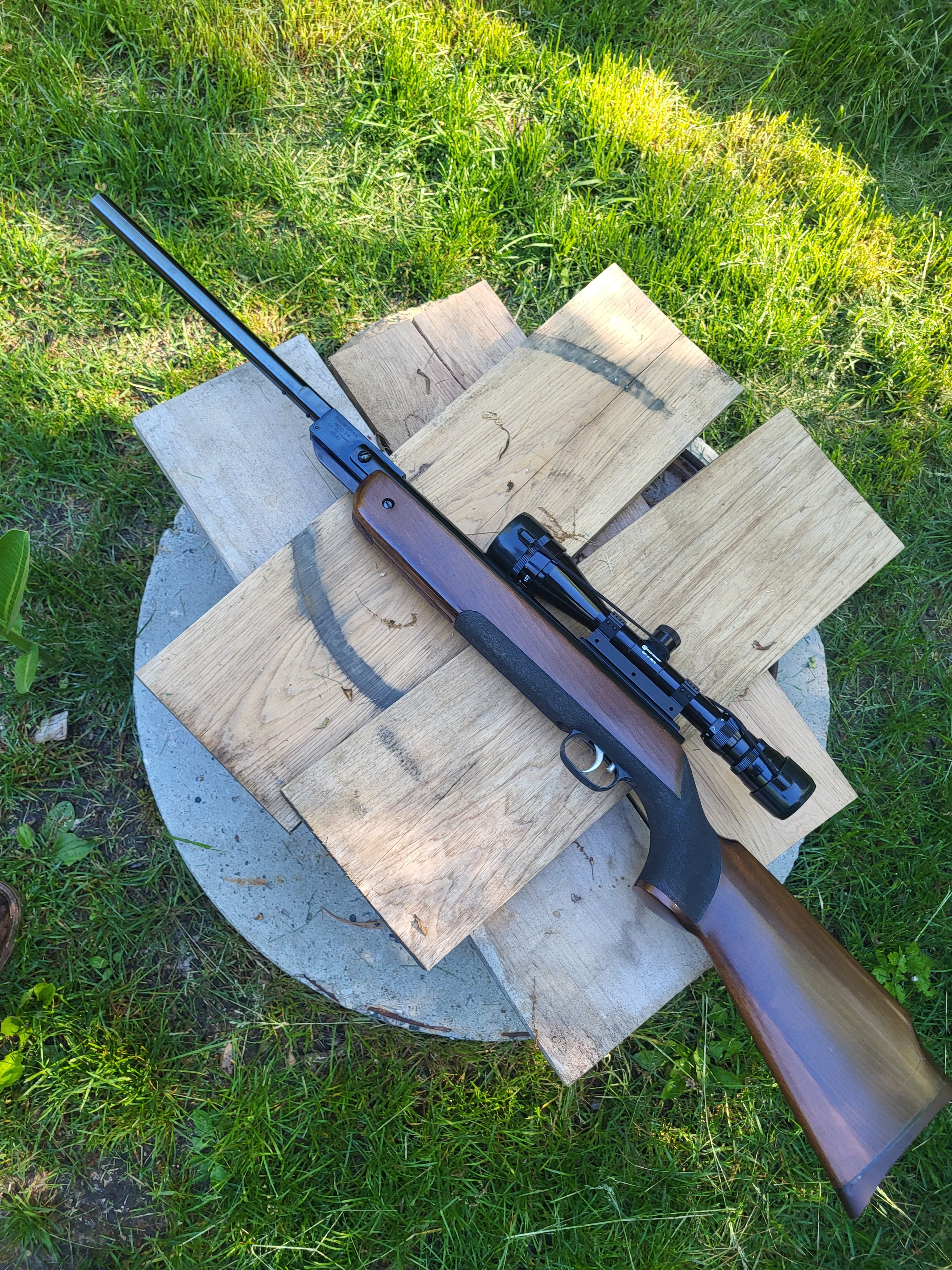

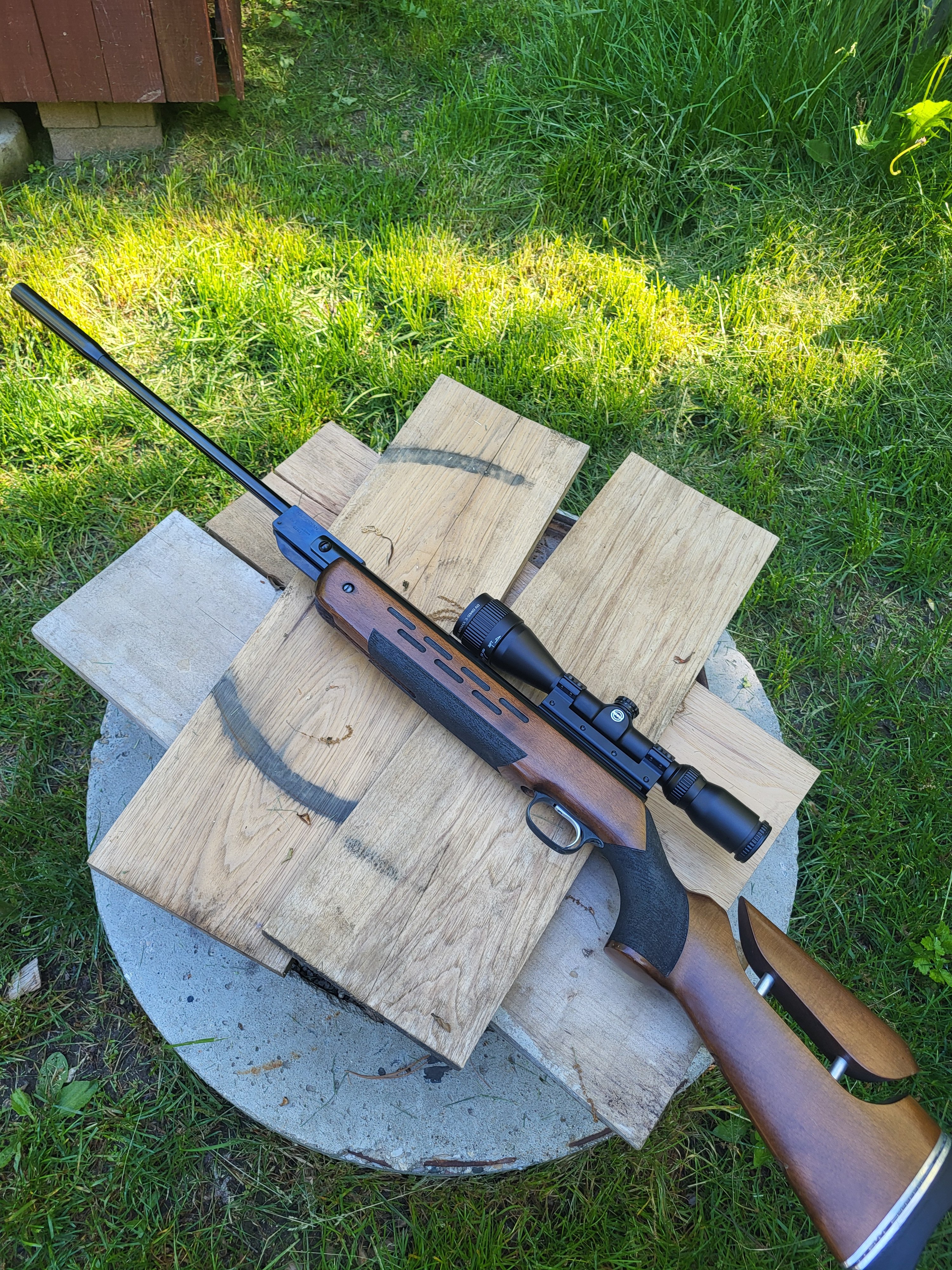

Yeah only the rear sight and model name is different between the two, but it seems to be a flawed design, as mine has a scope stop screwed on both in front of and behind the sight, indicating it has a real problem with sliding down the rail during use. Which sucks for me, because my rifle is in perfect condition, short of 2 marks on top of the rail from some a hole screwing the stop pins in.🤬
I'll post some pictures of it later, but yes it's just a regular dovetail clamp, but with only one clamping screw. I already have another old 77 with the correct beeman peep on it, I actually bought this rifle solely because it has that goofy notch sight on it....they are basically a unicorn sight to find still on the rifle😂 i think I'll just remove the stop pins from the scope stops they put on, im sure even just the extra clamping force was enough to hold the sight, they just went a little overboard 😂
