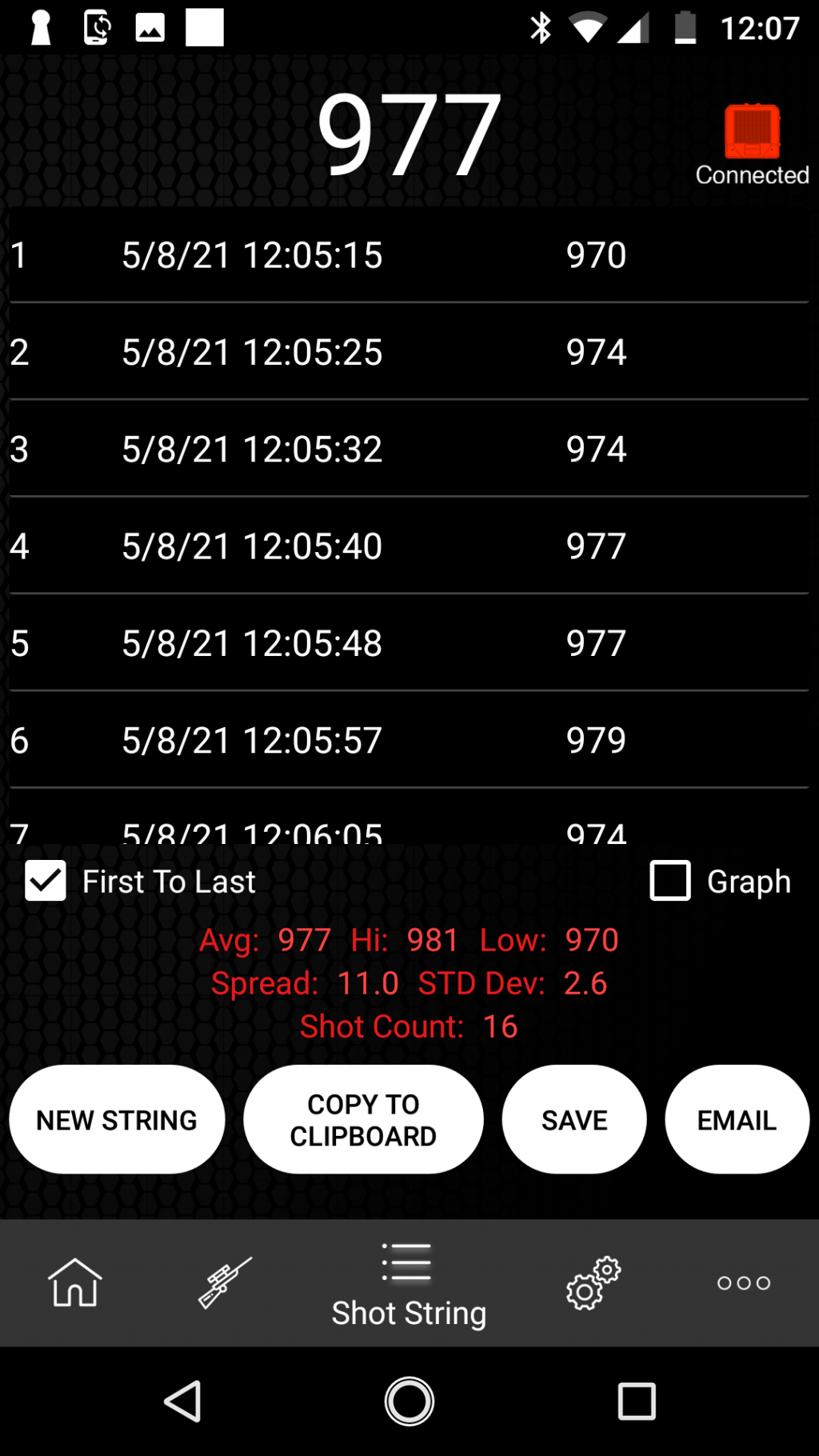

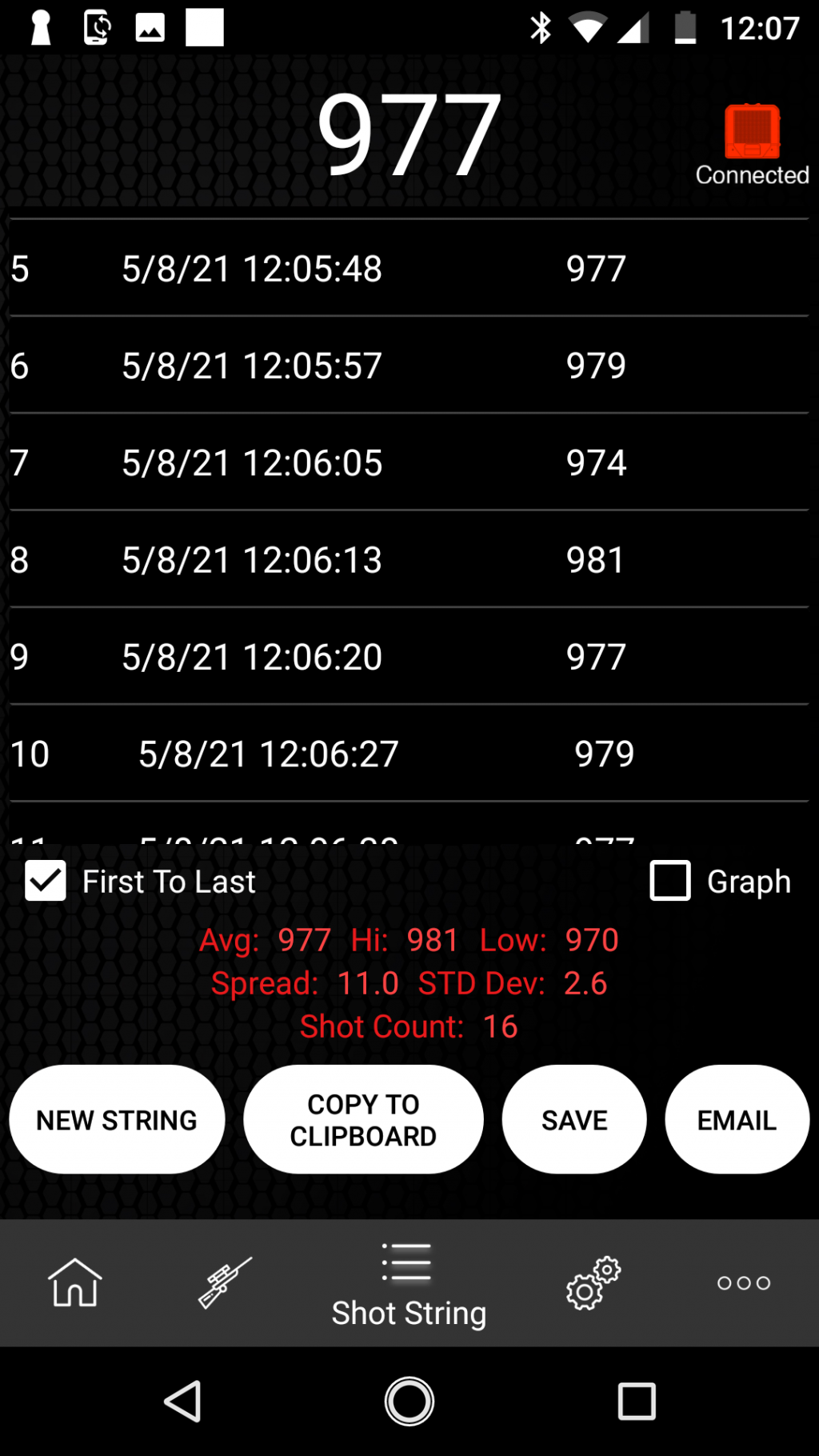

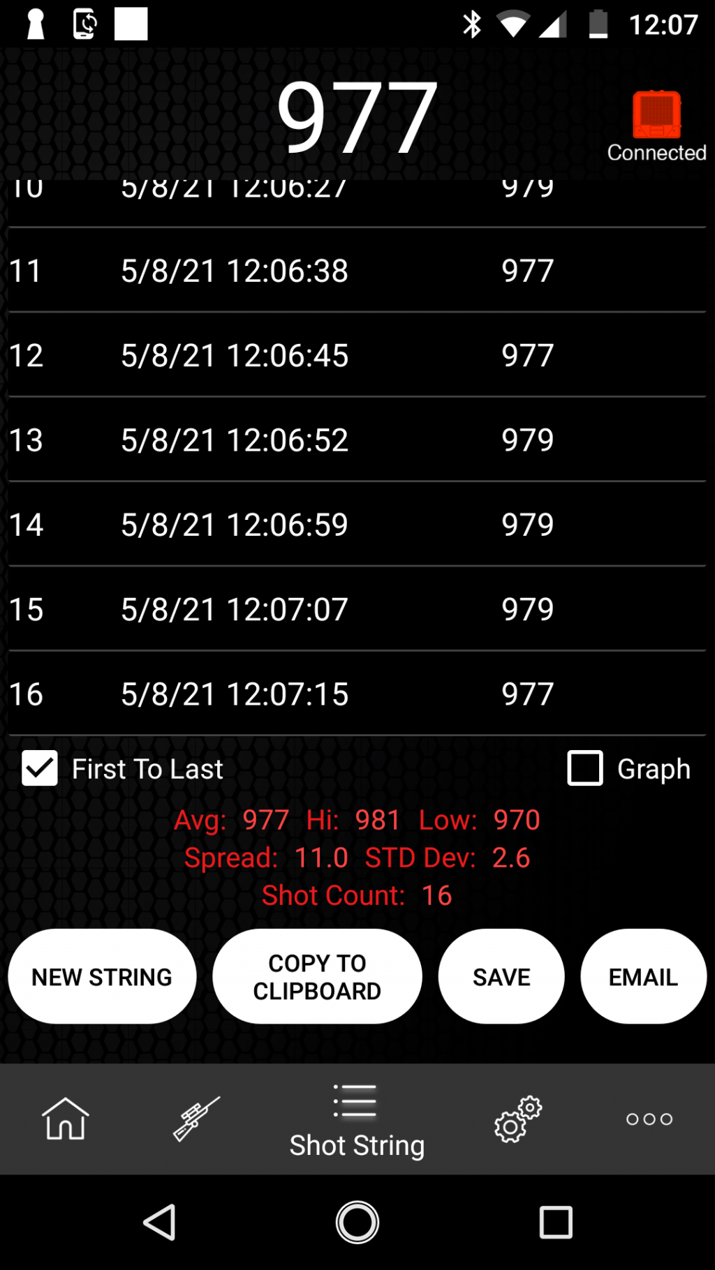

i just installed the dual reg system from huma on mine. to be honest in a day or 2 i will remove it as after seeing what happened to the exploding plenum i got scared and dont want anything external or aftermarket part on my riffle.. the numbers look promising but the huma gauge is off by 15 bar and the regulator was set at 220 bar instead of 135 as was indicated in the bag
