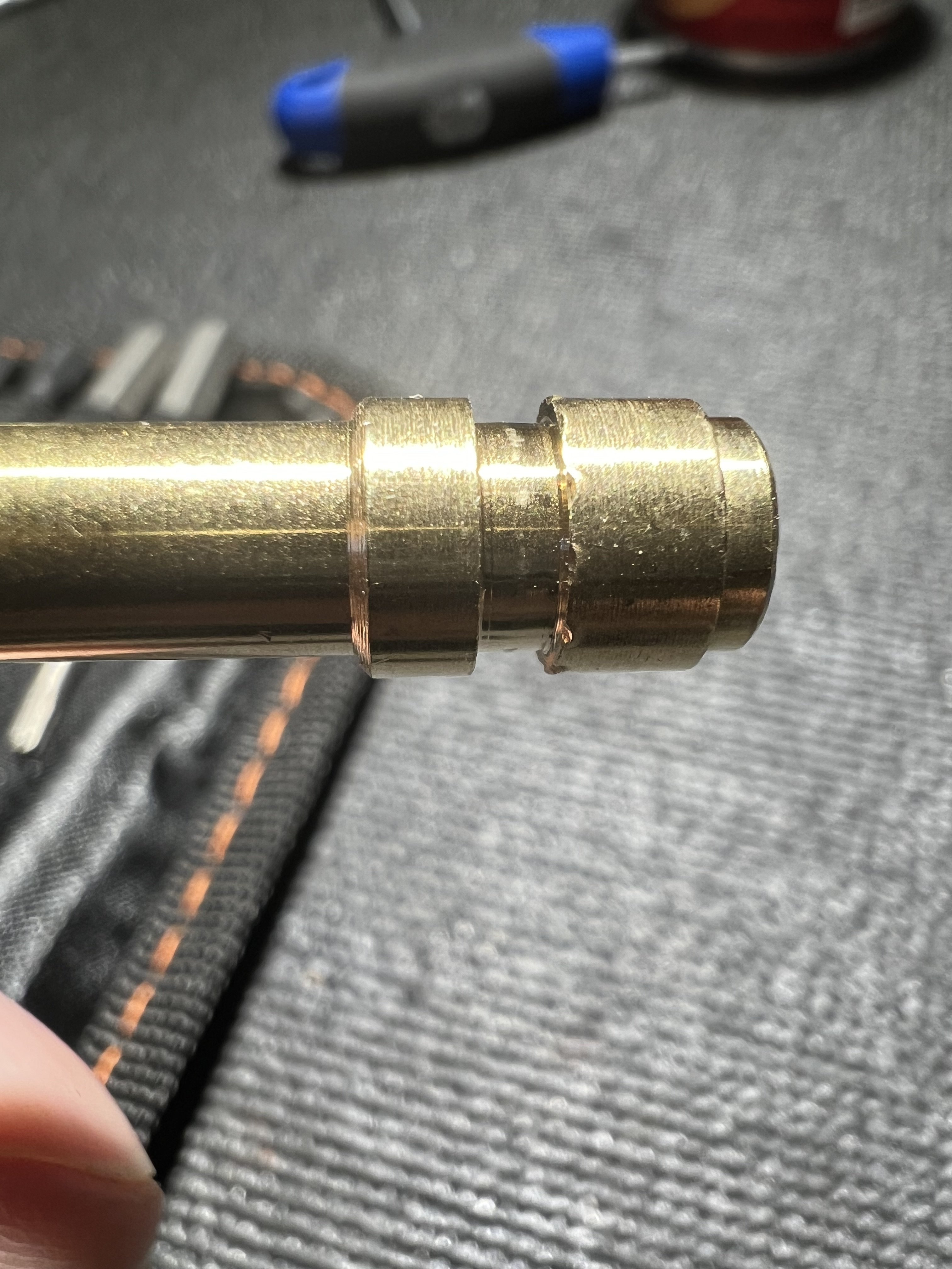

Just to mention...
I recently received an email from Krale that the filler plug from the first batch of DRS may no longer be used and that they would send a new one on Monday...but no explanation why.
However, after checking, I quickly found out what the problem could be.
Because this is a brass probe and brass is not exactly the hardest material, I suspect it will probably be replaced by a stainless steel one.
For those who have recently purchased a DRS, do you also have a brass fill probe?
1 photo usually says more than 1000 words ;)

My probe is brass.

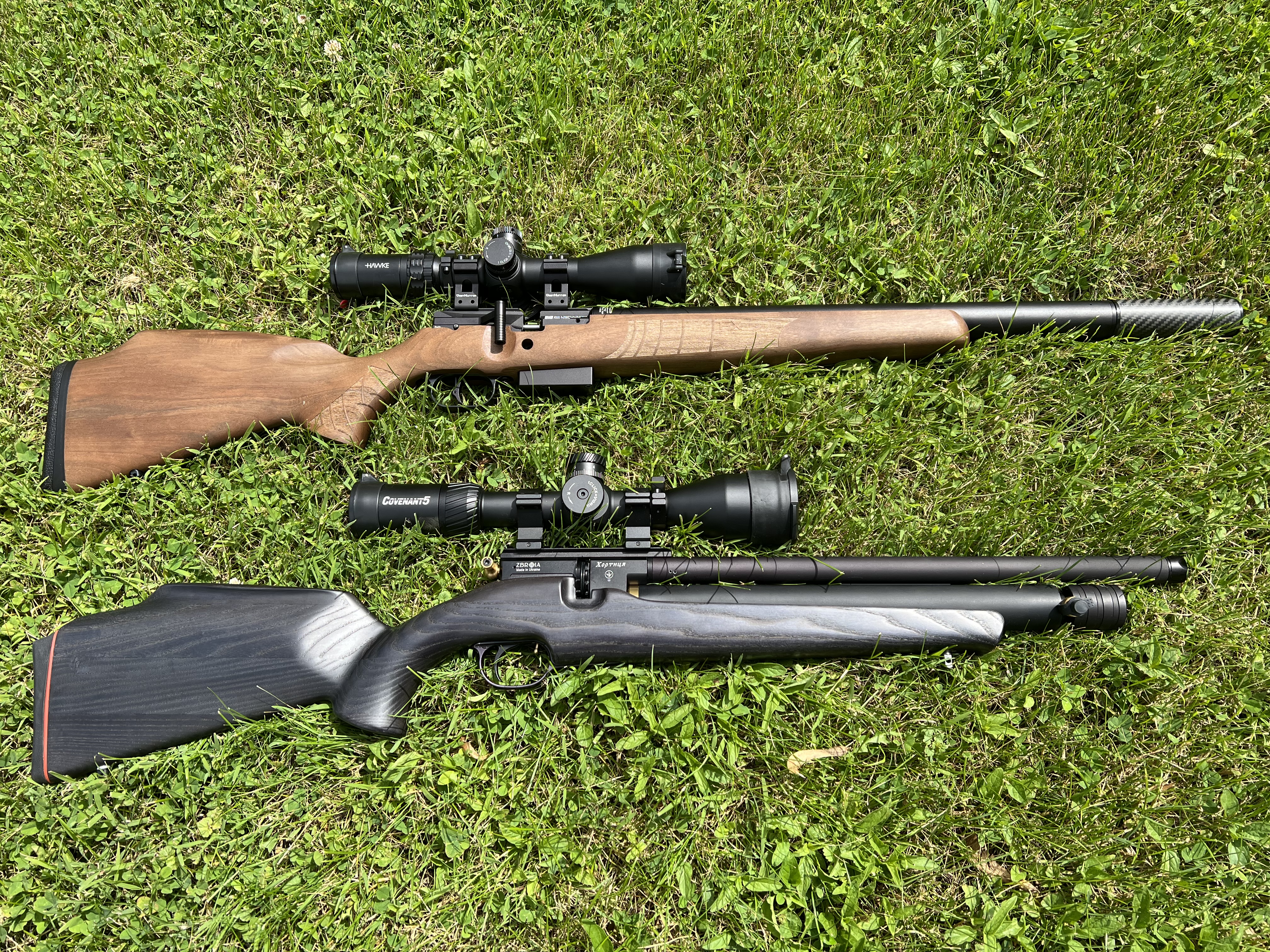

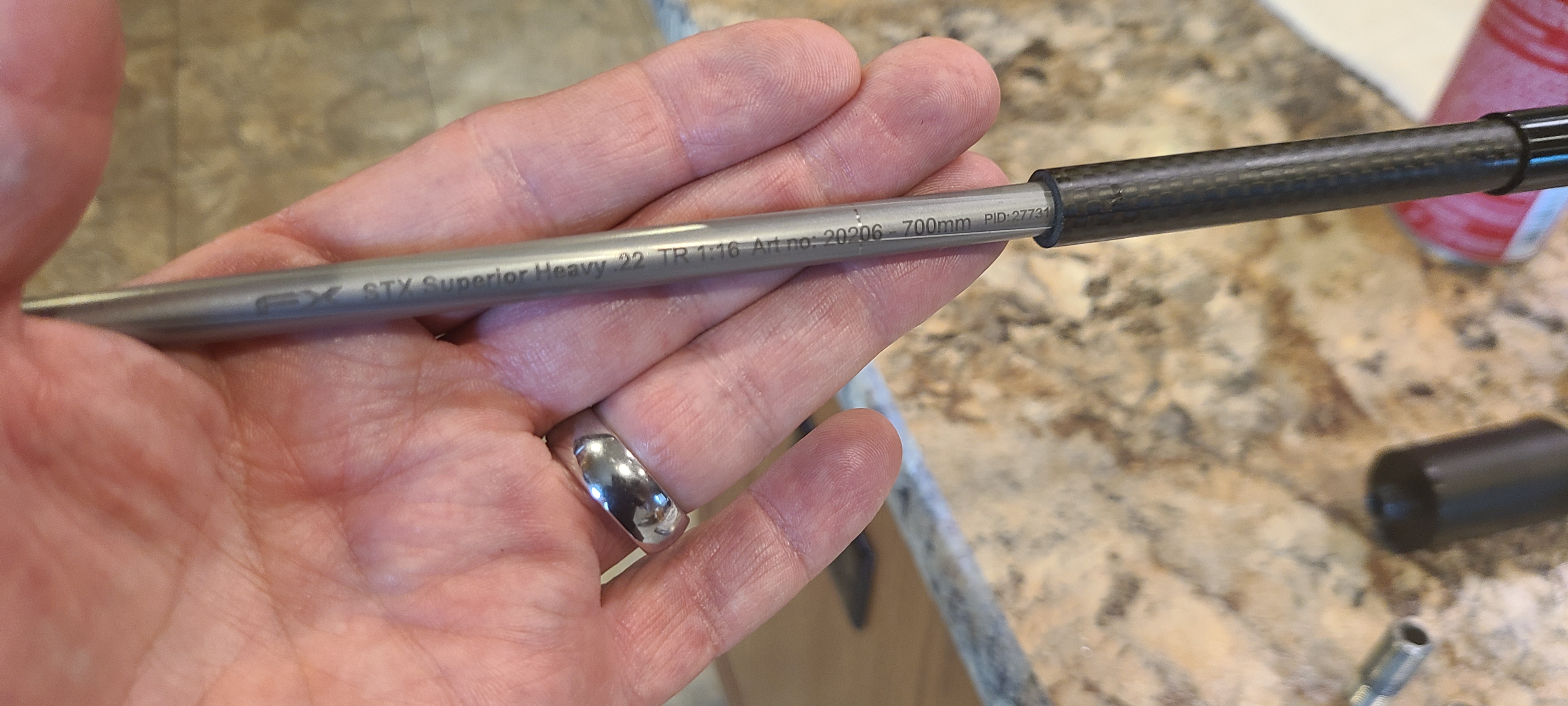

It was a nice calm evening so I took advantage of it and got my DRS sighted in after installing the picatinny scope rail and carbon fiber barrel sleeve.
The 1st thing I noticed was how quiet the carbon fiber barrel sleeve made the rifle. There was a bong noise from the air cylinder/barrel that is now gone.
It was so noticeably quiet that my wife even commented how quiet it was.
The rifle was very accurate without the sleeve but I thought I would give one a try anyway. I am sure glad I did !

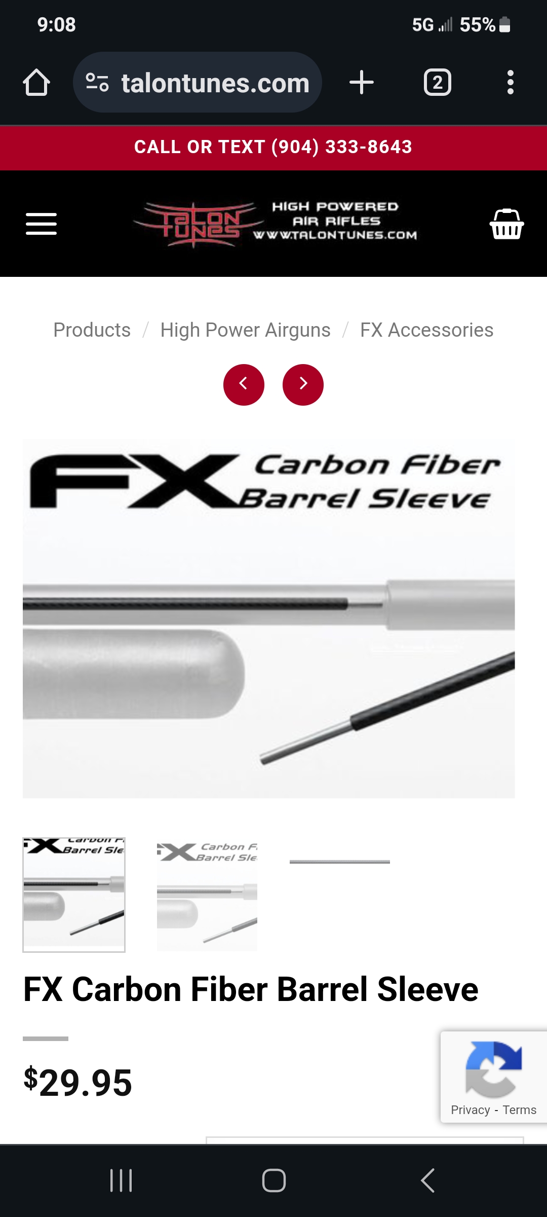

Brian, where did you source the carbon fiber barrel sleeve? Or did it come on your rifle?
Reactions: cwmoss
It's the same carbon fiber sleeve that is used on the Impact

I just took my DRS out of the shipping box. Found the fill probe in the box and it felt a little rough. I haven’t even filled my gun yet and it’s already getting chewed up. They better offer a stainless one under warranty before they catch a lawsuit when someone’s quick disconnect smacks them in the face while filling. Strike one.
good eye..yea strike one.

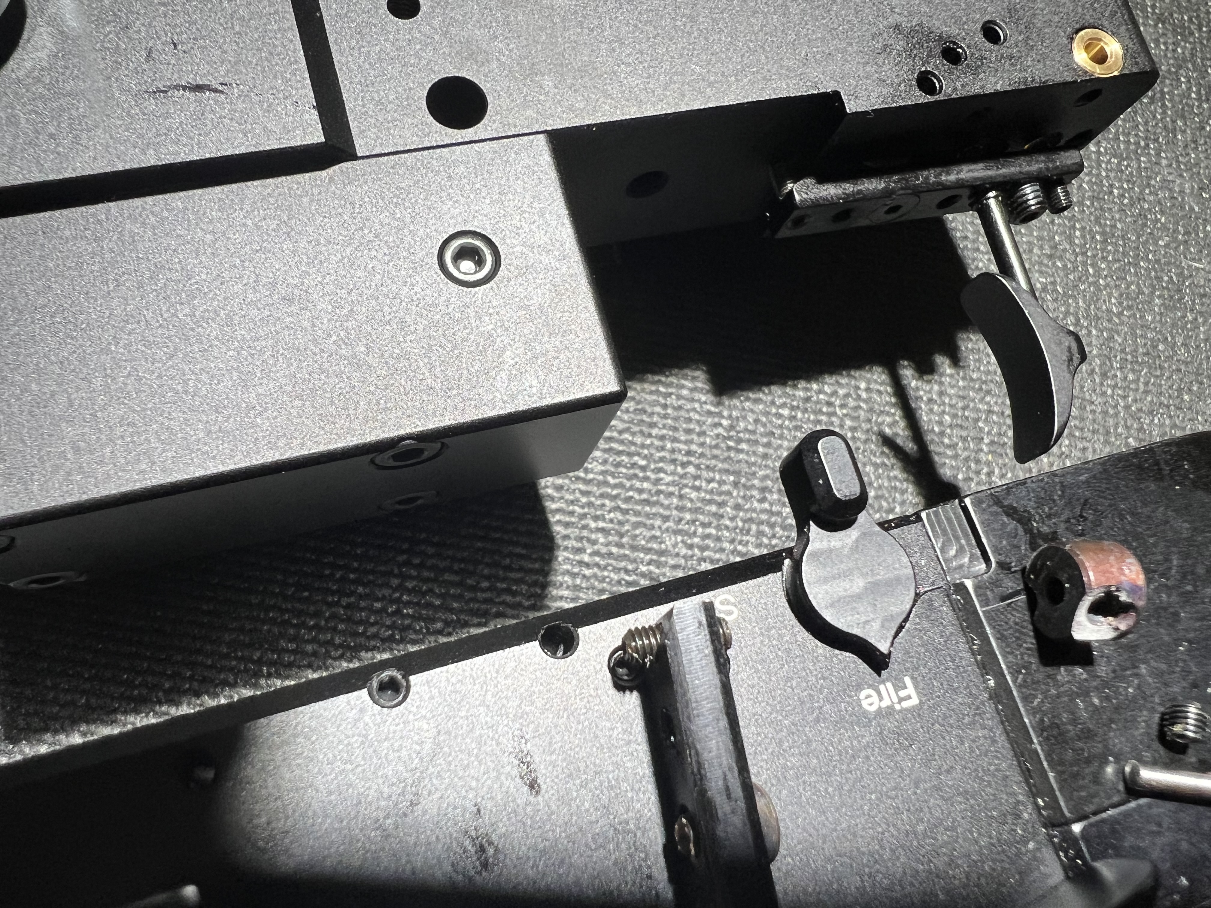

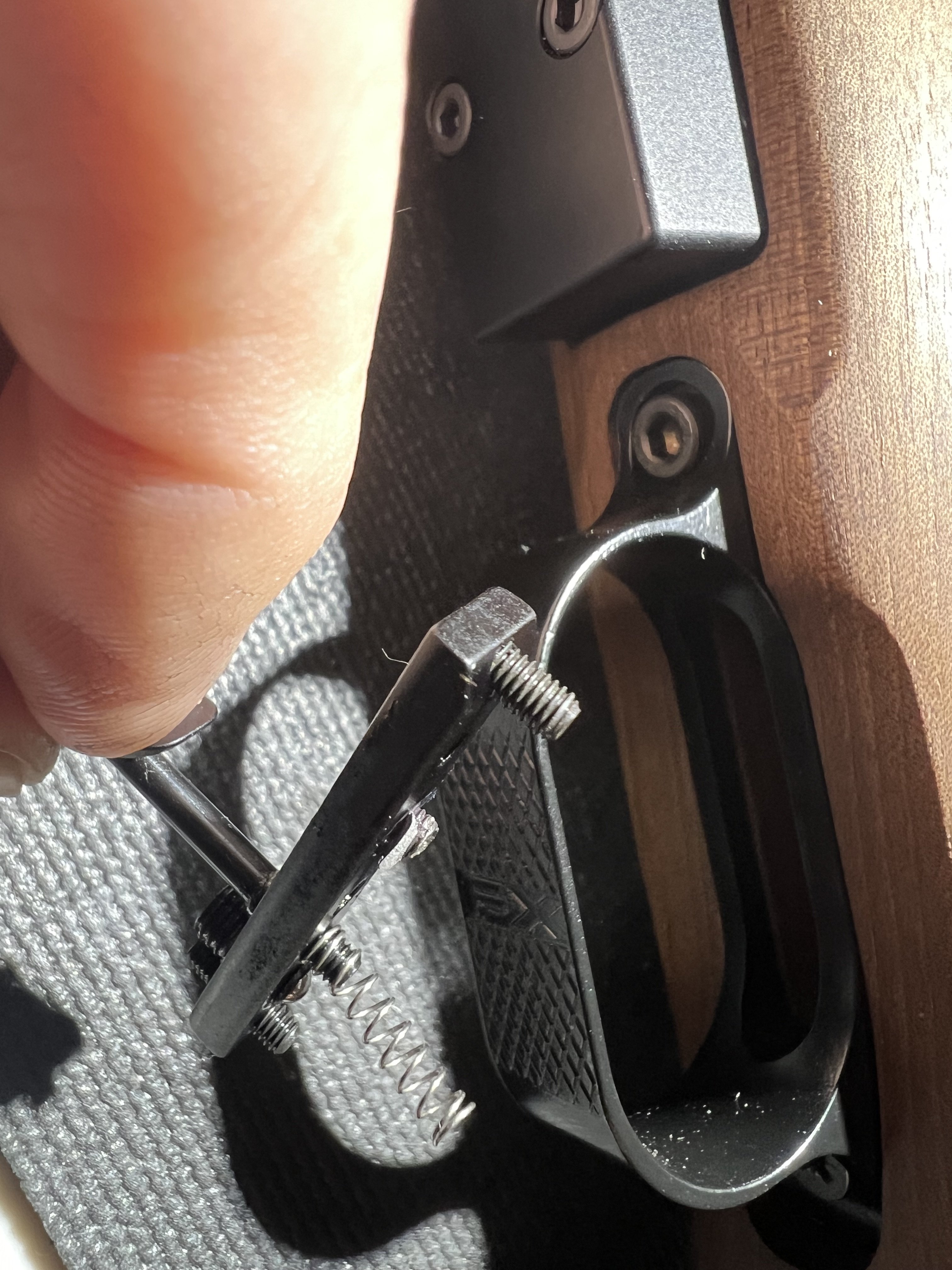

I was sighting in after a barrel cleansing and my trigger dropped down so I just pulled it out of the gun. The trigger wheel that doesn’t have much tread engagement broke. Hopefully UA will have one. Looks like I’m done for a while. I did get a couple mags out of it. Nice little gun. True featherweight and comfy. JTS 18gr around 870 and Hades around 920fps. My trigger is or was fantastic. No need to upgrade to the match grade trigger. Just need it to stay together. I’m not mad, I’m calling it a fluke. All my Impacts have the exact same trigger part and never an issue. It may have taken a shot on the assembly line.
Well this is when it pays to have a FX you don’t shoot much. Took the part out of my Dreamtac Compact trigger and put it in the DRS. Back in business. But……..here’s something interesting. In the picture you can see all the trigger pins have a grub screw in them on my Dreamtac. That’s so the pins don’t walk. The DRS has threaded holes for the grub screws but not one grub. So the pins just push out. I like the way 2020 FX did things. They were being more proactive then. Skipping 3 cents worth of grub screws seems a little silly.

Maybe that's the upgraded trigger is those grub screws lol

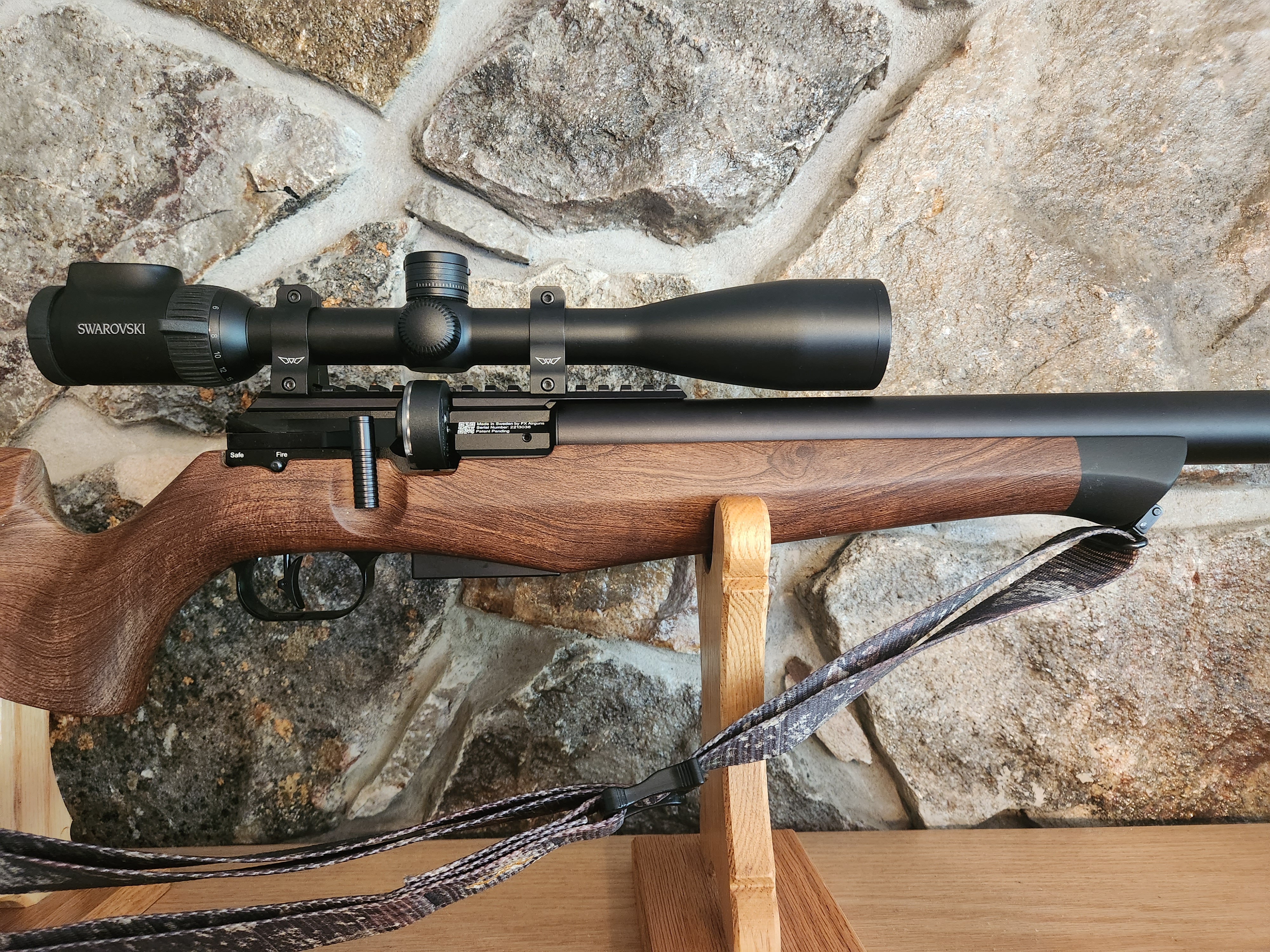

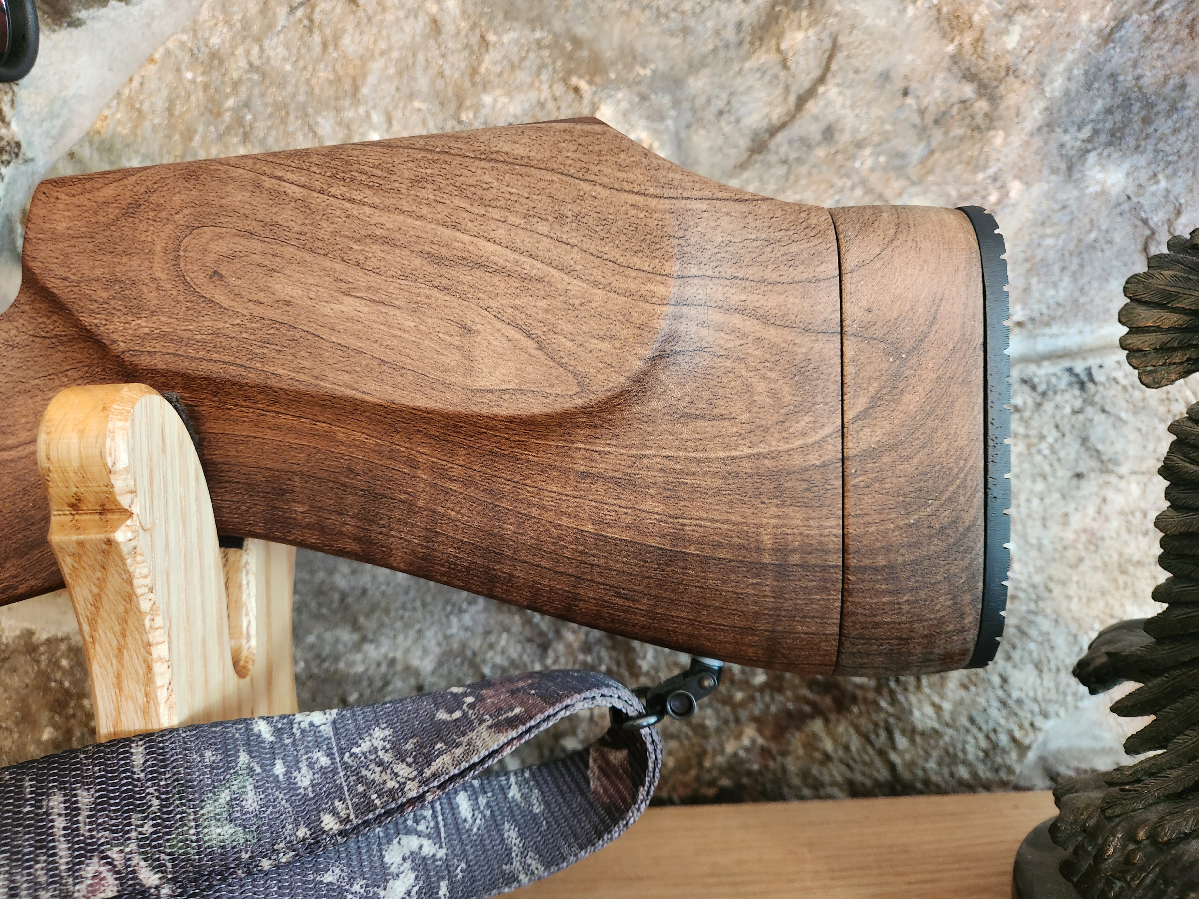

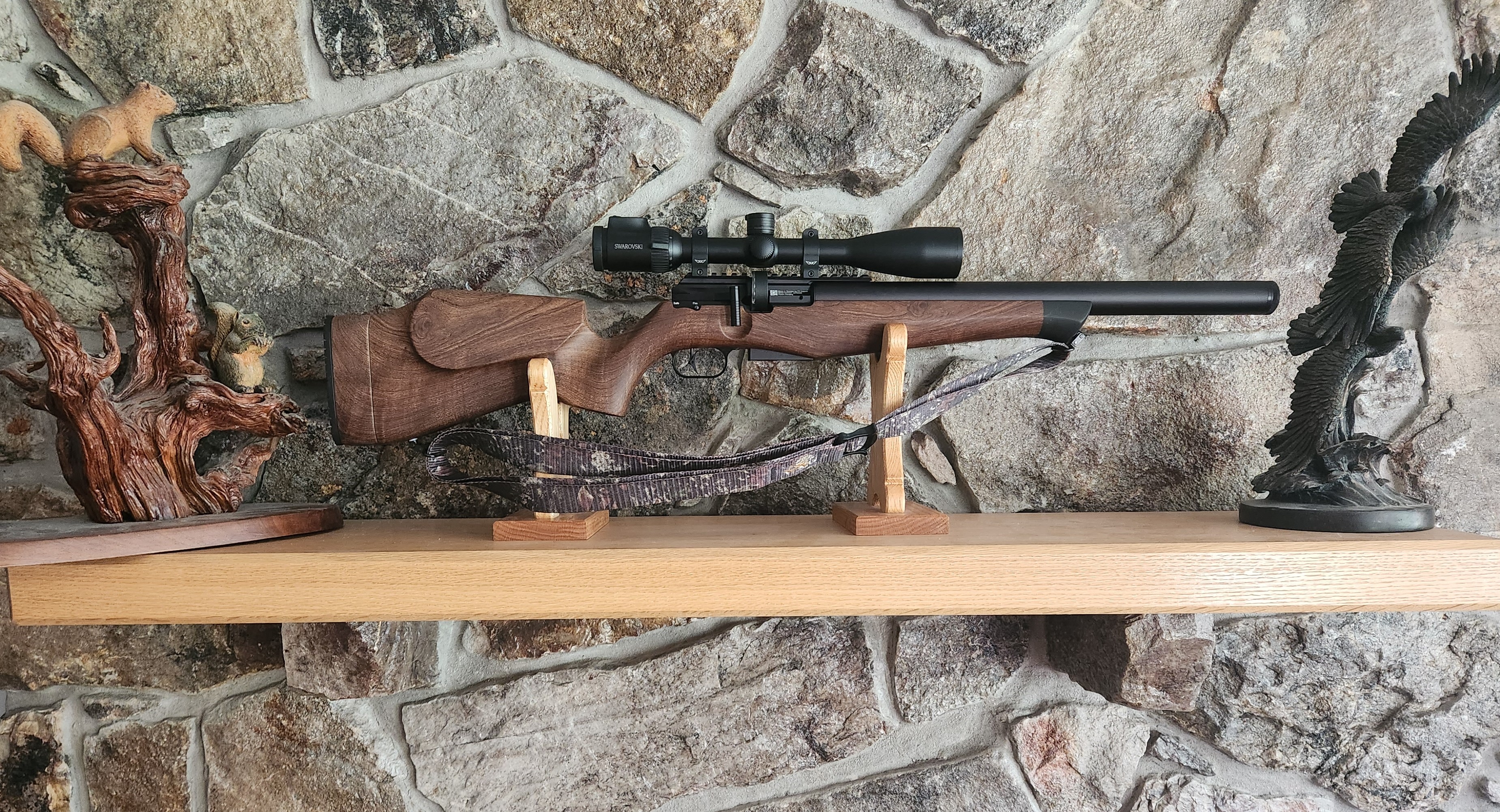

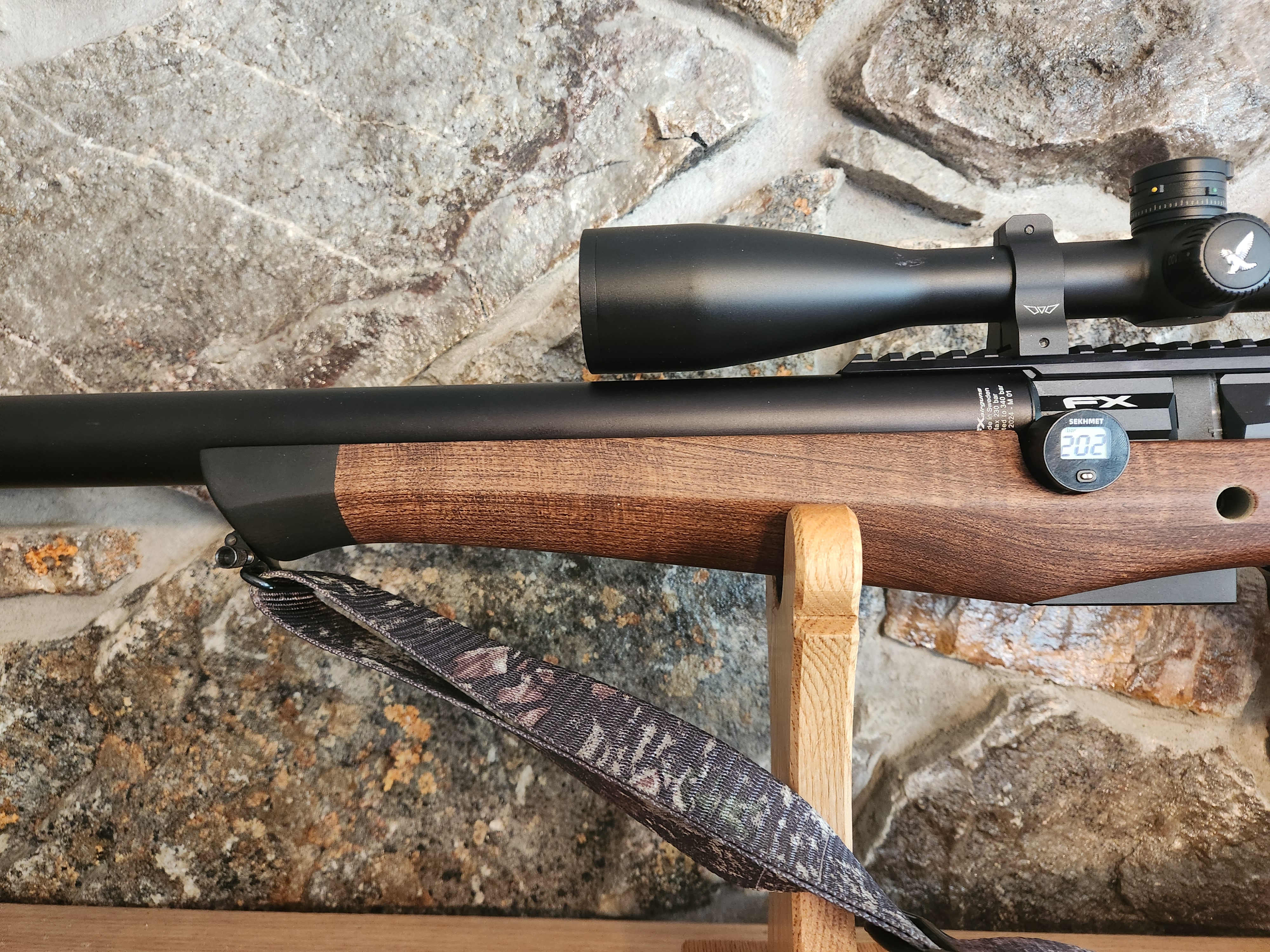

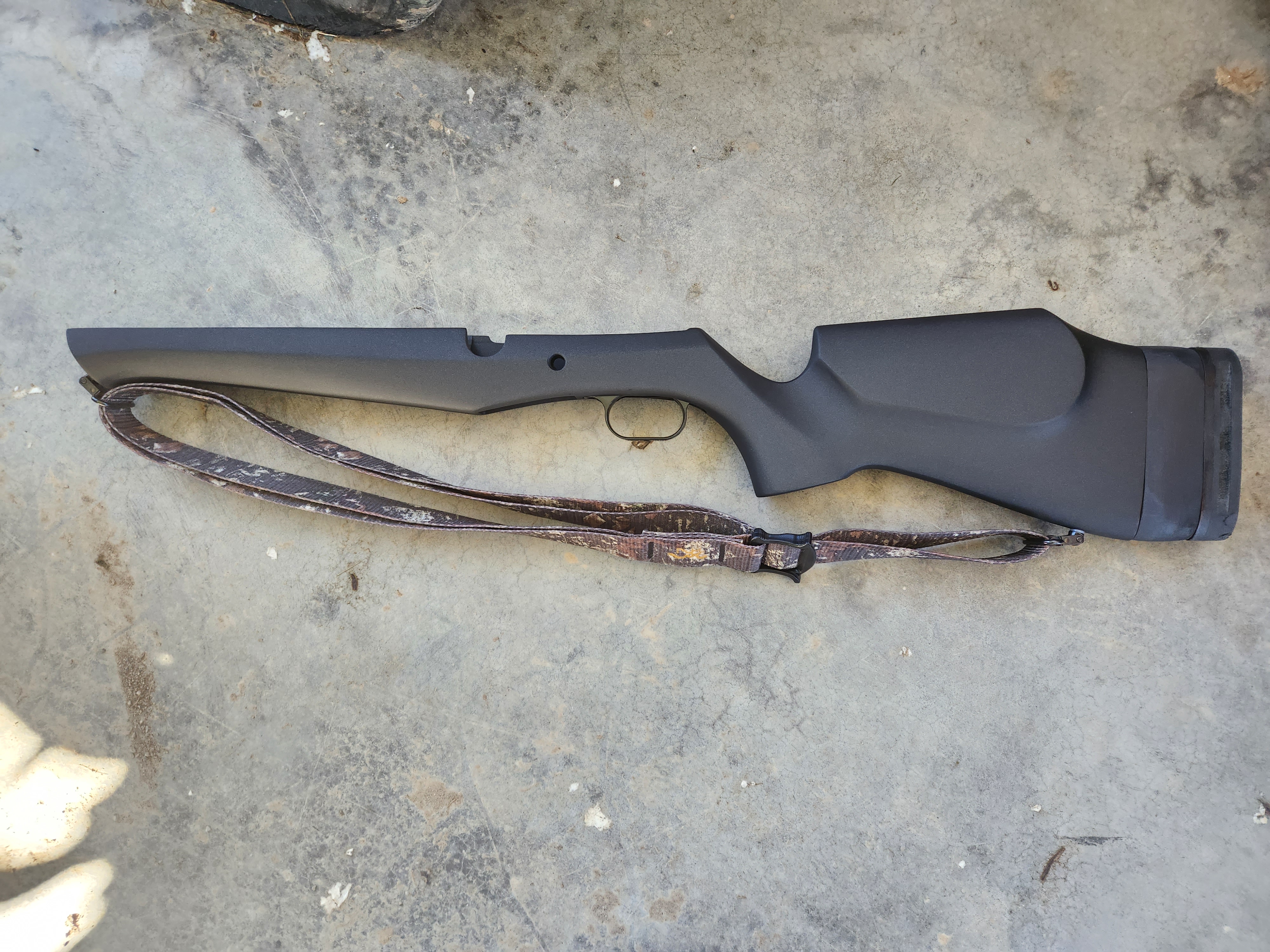

This stock isn’t the same as the pictures shown on the website. One thing is the added wood extension for length of pull, second the hole for the filler probe is on the left side as the synthetic stocked model.
I could be wrong but I think this is a synthetic stock that was hydro-dipped and has a matching length of pull spacer.
