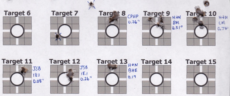

They grouped nicely from my DAR but that barrel shoots a lot of pellets well.
Bottom row, middle group. Just 25 yards. I don't remember if I tried them at 50.
Reactions: GA_LeadHead
