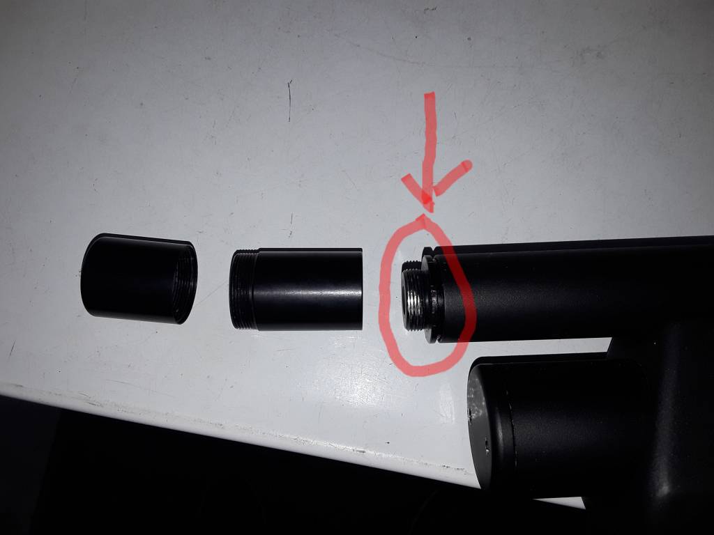

I've got use of a Bobcat Mk I, .22 for a while. It's quiet but I'm wanting to "mouse fart" it. Looked at FX's MK I diagrams but don't see thread sizes for an adapter. Gonna try my Ronin on it. Here's a pic.

you need one of these, Gerry. One longer, one short. Longer one is meant to clear the air tube with a gun whose barrel shroud finishes shorter than the air tube, like the MK2 wildcats with the 600mm barrel. Looking at you pics, you just need the short version. M20 x 1.25 female thread to 1/2-20 male threads
