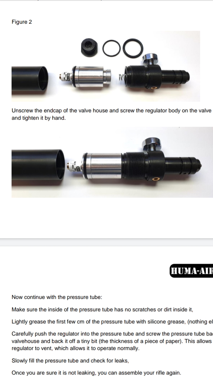

My valve stem broke on my puncher breaker. I have the replacement and all new orings, but since I have to open it up, why not add a regulator.
I am adding a Huma to my Mrod, and like the way it's put together, so I ordered one for the PB.
But I noticed that there is another version now where the valve endcap is removed and
the regulator then screws into the valve body.
Anyone using this yet? Just ordered today probably have a couple weeks wait for the mail being holiday season and all.
Think I'm going to polish the barrel also, its shooting good already, but why not since its apart.
