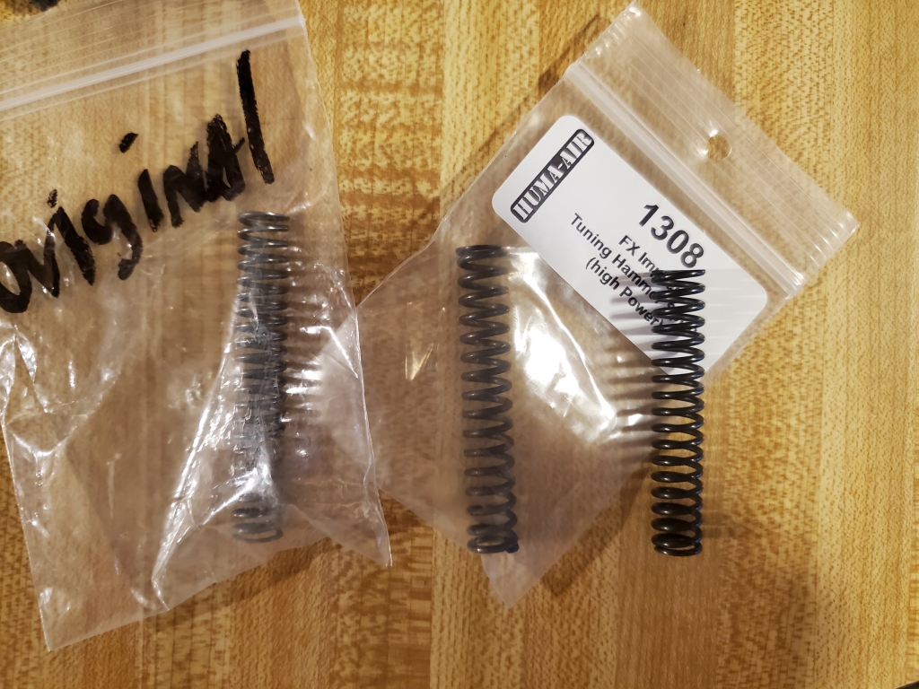

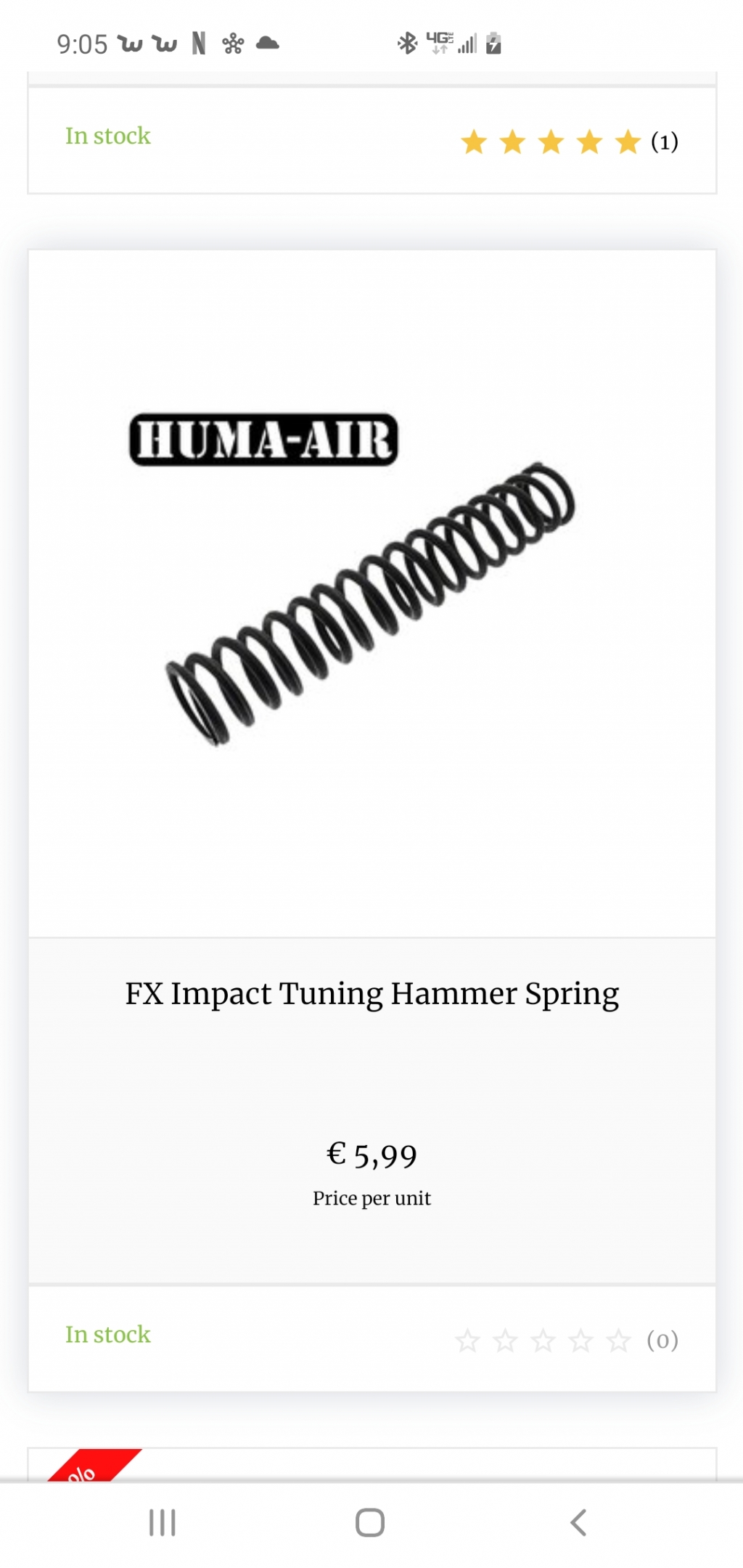

Its not that deep to where I gotta talk to a tech. was just asking if anybody had experience with the new Huma spring to save me some time it was only six dollars and if I don't like it I could just throw the old
spring back in .......i ordered it it came today so now I got the MK1 spring which is the longest Huma spring wich is longer than the MK2 spring and I got of corse the Mk2 spring which came with my gun ill test them both this weekend and post results......I guess this would for folk who have .30 cal. And wanna send "slugs"a little faster without major modifications.......
