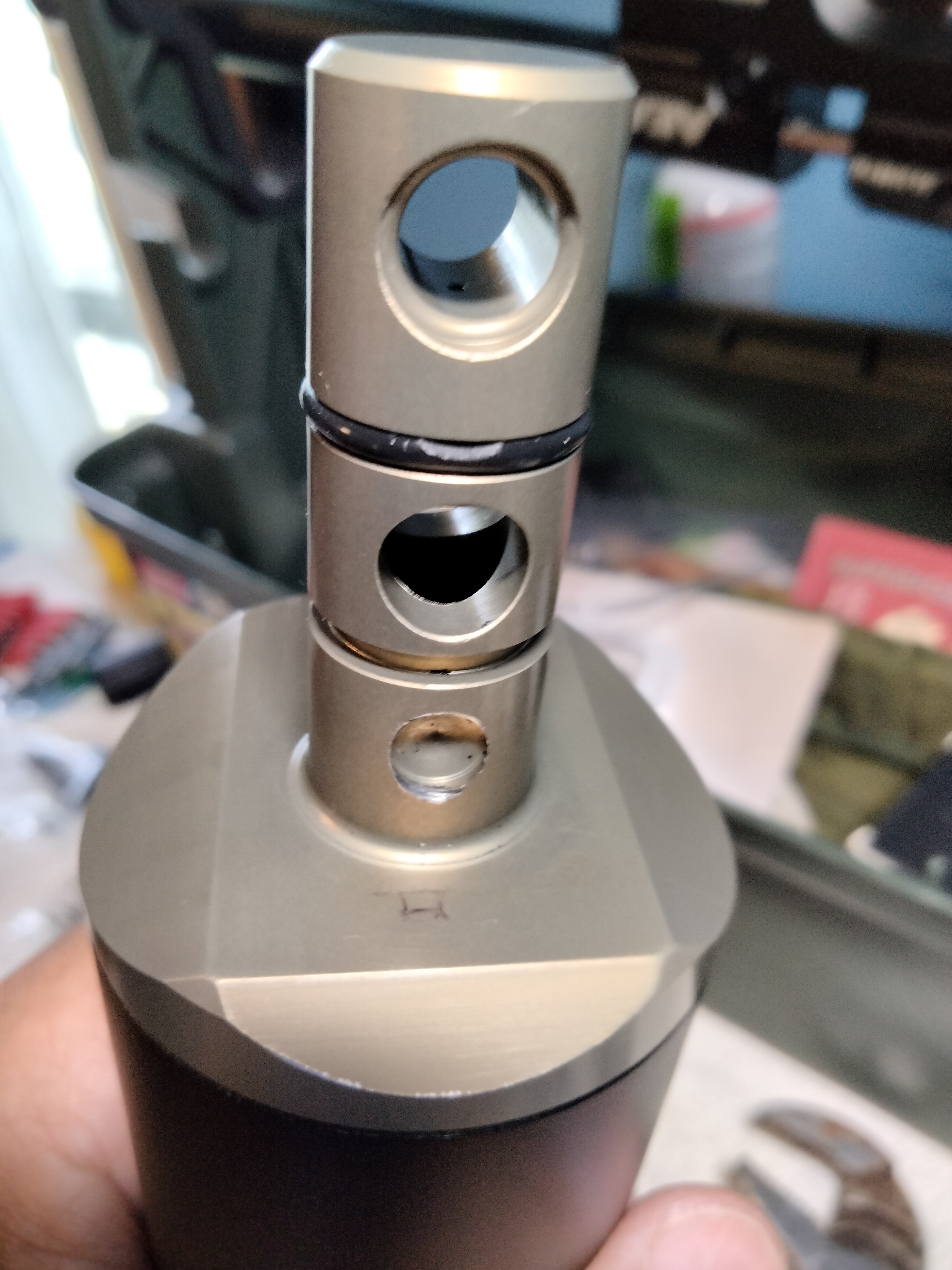

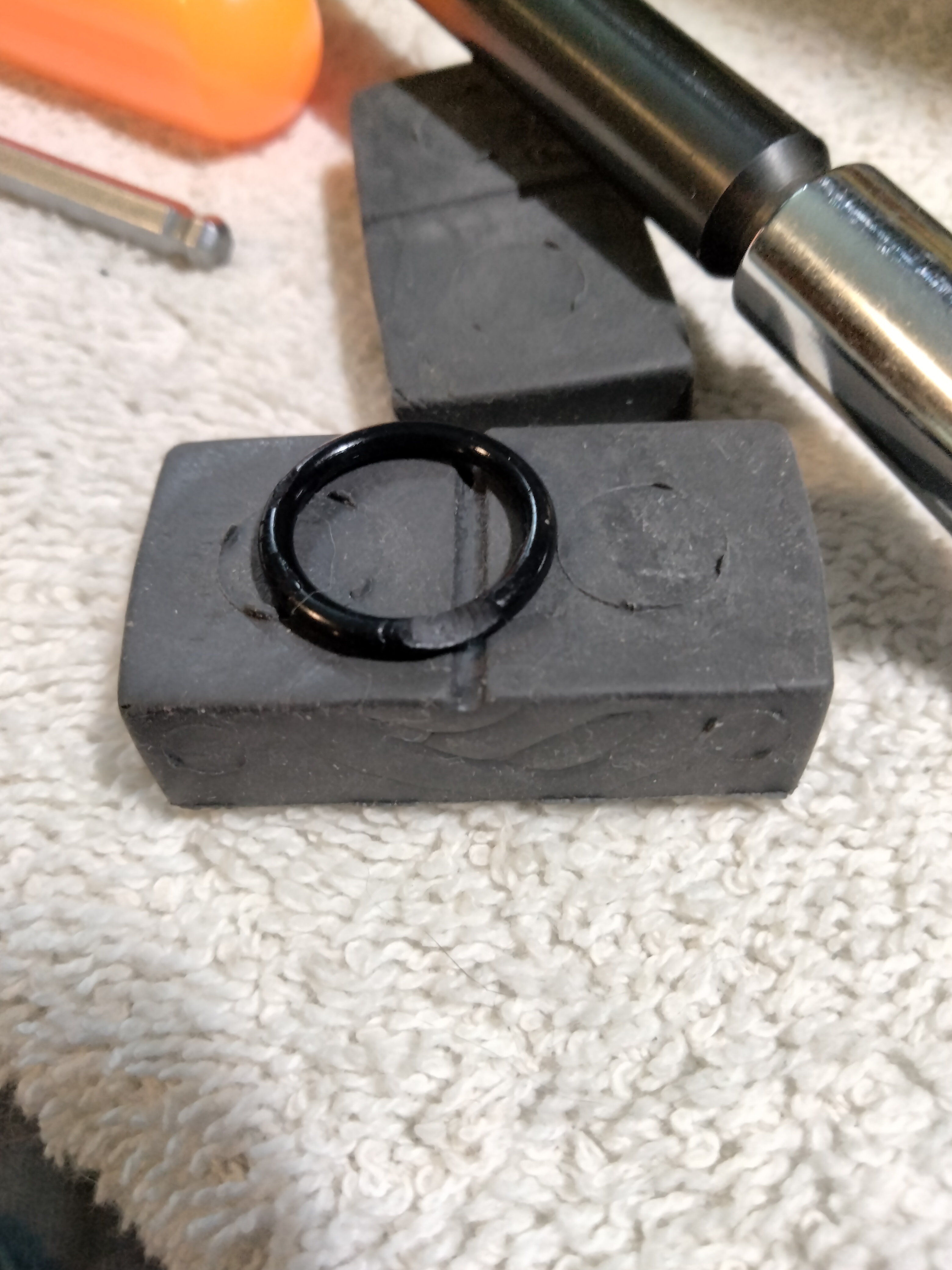

So I've got an AEA HPSS Plus in .25. I replaced the puppet valve and realized I couldn't get it to fill anymore. Once I took some soapy water to it I found out it was leaking between where the pressure tube meets the housing on the rifle. So it took it apart and found a big gash in one of the o-rings. I don't understand what could be scraping these that causes this. I take the grub screw out far enough that's not an issue and of course the pressure gauge is already removed I'm just stumped. And I just noticed one of the new o-rings I installed already has a cut in it. What the hell? Anybody got any ideas?
Don't know the AEA HPSS but if same happened to me I'd be searching for a burr or sharp edge that shaves "O" ring as it passes during install. WM
Yeah, I put my pinky finger in it and couldn't feel a thing. what worries me is what happened to all the little pieces that already came off?? I can't see them anywhere. dunno
I agree with the other suggestions that the part which enters the O rings has a burr or sharp corner. That's virtually always the cause of cut Orings.

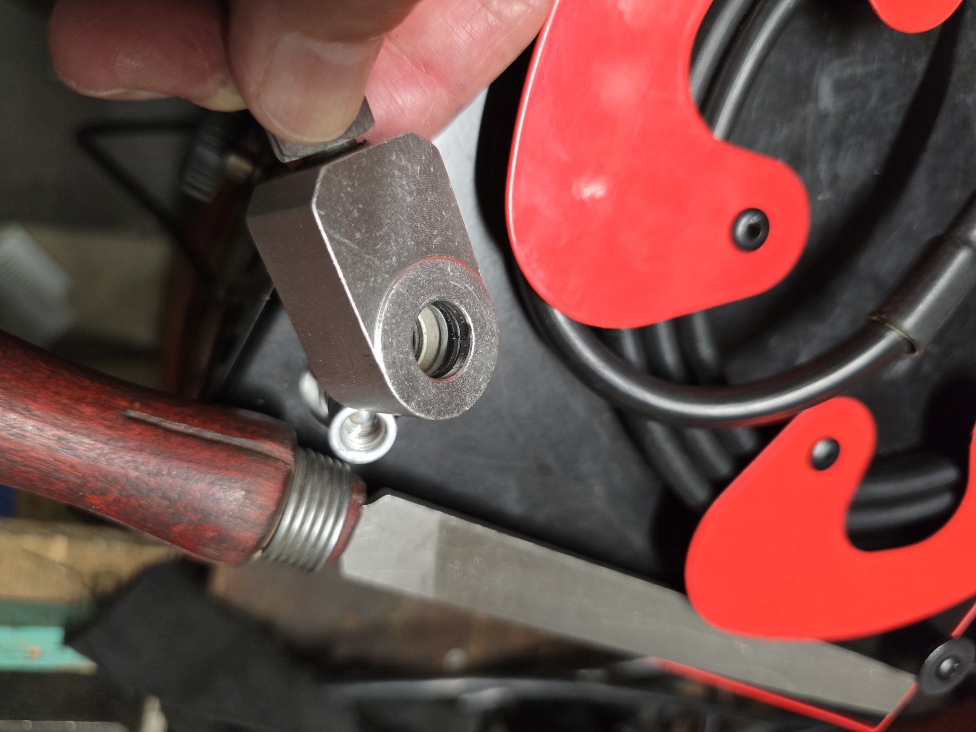

Here's a cut O ring in the swivel of a GX CS3 compressor's whip hose. I deburred the sharp corners on the stem, installed new O rings, lubed with silicone grease, and problem solved.

Usually the port its going into just has a sharp edge.
Yeah, I'm stumped. Like I said, I couldn't 'feel' anything. and the weirdest part is both O-rings are affected so it has to be something before the fill port because the fill port area is on the very end of the fill part of the tube. Then the two O-rings are following.

IME, the most frequent offenders in cut O rings has been threads. When a threaded hole and an O ring pass one another, such as when inserting a barrel with its O rings, past the threaded barrel set screw holes, the end of the last thread often protudes like a well-designed cutter.
IIRC, my Kral Mega had this problem, in spades and required judicious use of Dremel and round stone to chamfer the end of the threaded hole. I could remove the thread part that was protuding, then the next time the barrel was out, then in, the O rings would be cut again. IDK if I have photos of that, but it should be obvious what was the solution.
What size is that Oring.lol, i have a JTS one that is the same rebranded, it is slow to get up to pressure, but always gets there.
