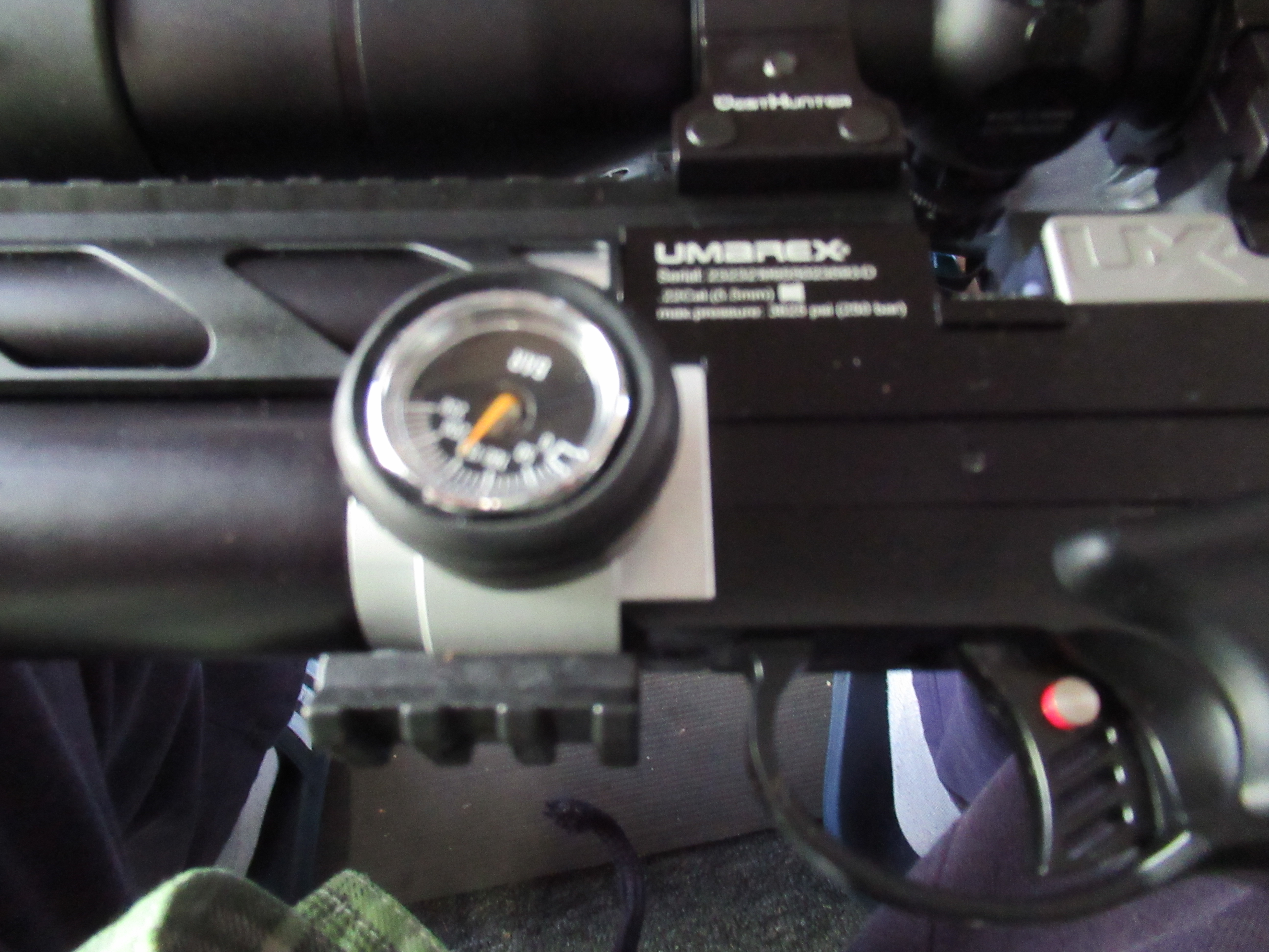

I purchased the gauge block from Archery Air Guns in Canada for the pp750 and installed it on my Noto's. My fps went from 740+ to over 800+ fps. with Crosman 14.3 pellets. I'm happy with that! My Noto's two have the eBay drop block with a 3L bottle on it and my fps is 738, ending down to 726 fps, 50 shots. I fill only 3200 psi and shoot down to 2200 psi. My extreme spread is very low from 5 to 8 on the last 10

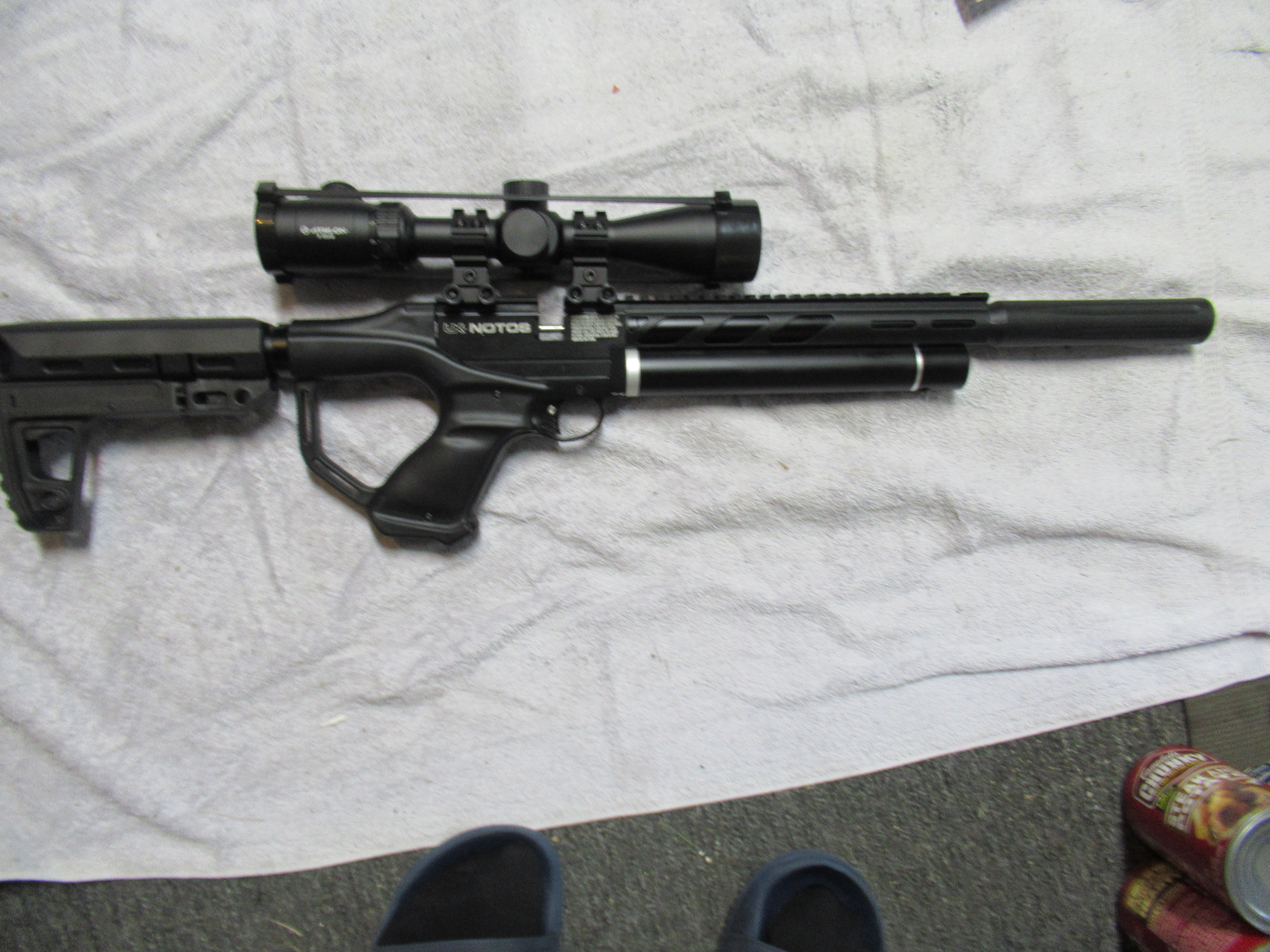

Any pics you could share?

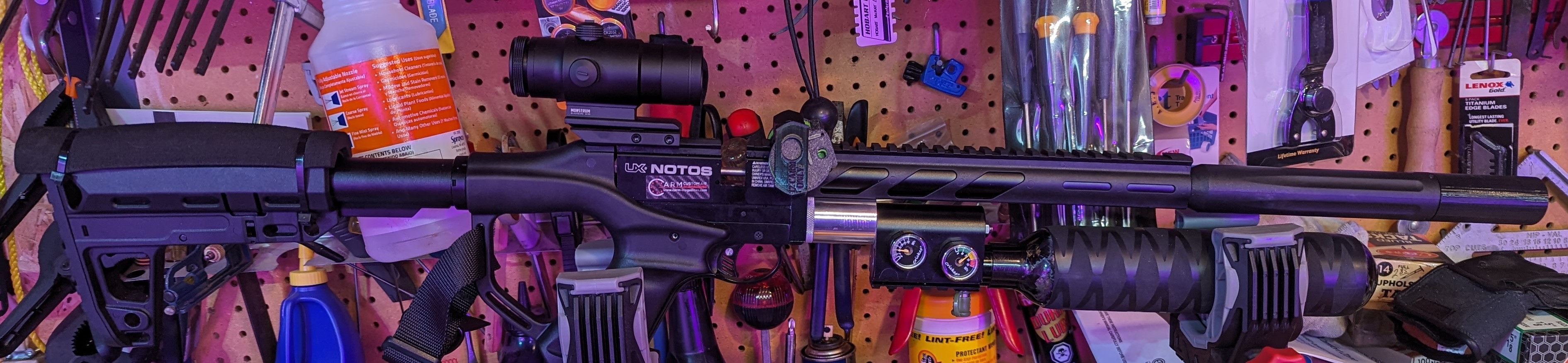

I'm really quite impressed with the ebay kit now, the first series was junk, sloppy threads and horrible fit, this set is gorgeous!
The fit-up was perfect, threads are polished, Ill be powder coating my set when it arrives and Ill share that with you all when its done.
