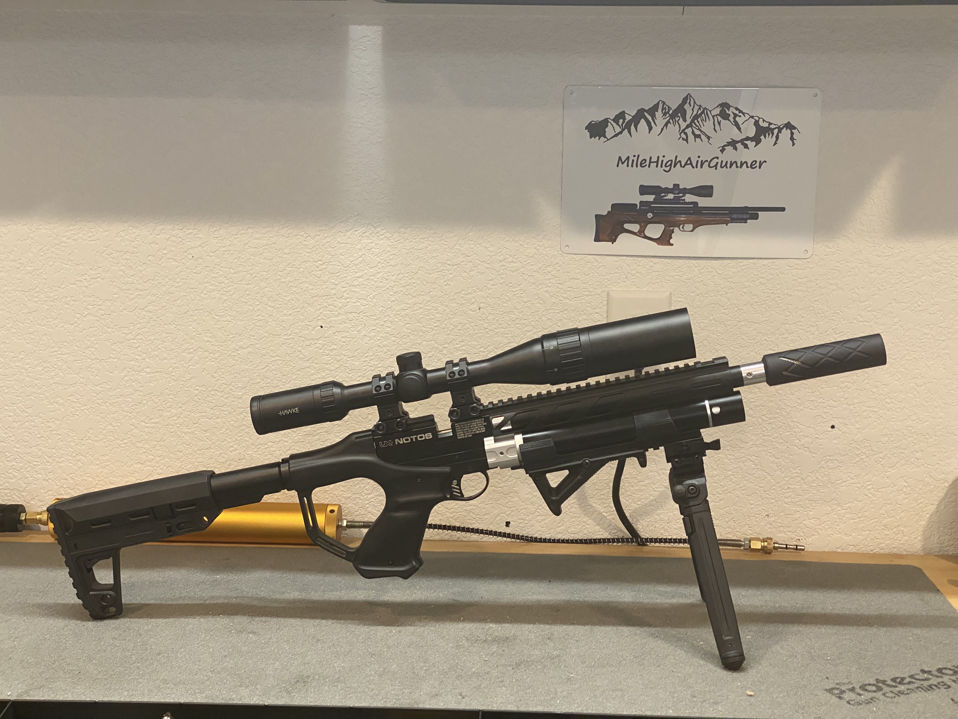

How tight is the fit of the barrel thread adapter? I'm concerned about concentricity and either affecting accuracy or having a pellet strike the moderator.
It is tight. There are set screws to hold it in place because the barrel is slip fit itself then is held on with a set screw at the breech end. I don't have any baffle strike issues.
The plenum will add 1-3/4” to the length of the air cylinder. I installed the gauge block which added 3/4” or so to the length of the tube and only had to cut a little bite away to clear the OEM moderator. The plenum would require cutting a lot more off. Whether it would affect the integrity of the OEM moderator or not cutting that much off I’m not sure. Personally I’d just get the entire plenum kit and remove the OEM moderator and use the adapters for an aftermarket moderator.
I bought the kit specifically for the adapters. I didn’t see/realize he sold the adapters separately or maybe he started selling them separately after I bought the kit not sure. I don’t plan to use the plenum so it you want mine PM me.
Nice rig, do you need that huge sunshade? Gun would look more svelte without it.
