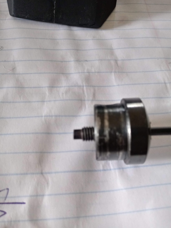

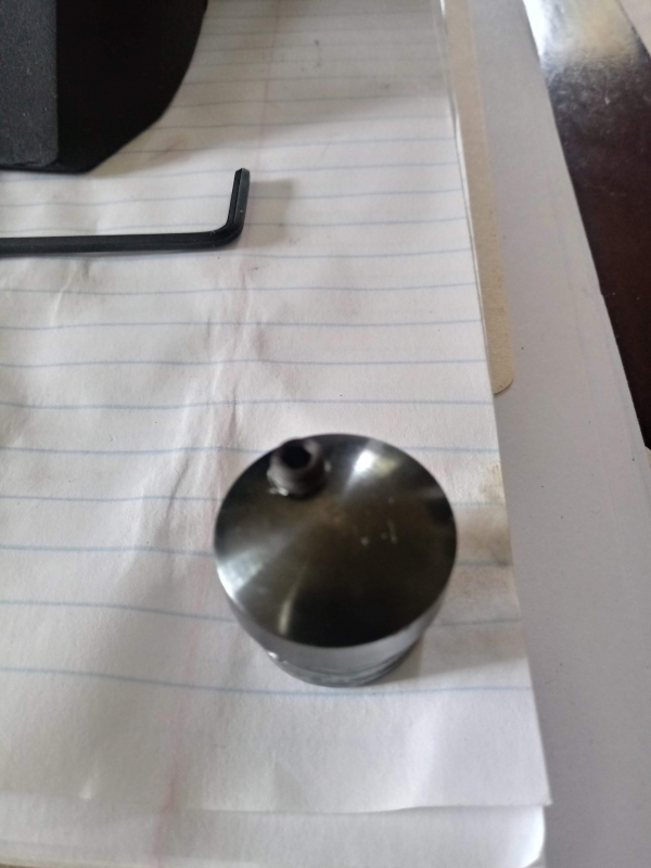

My .177 Gauntlet has some Haji-Bits,a larger bottle (380cc ),adjustable hammer pre-load device and a slightly hopped up regulator.
For what it is,I absolutely LOVE my Gauntlet! It gets over 120 shots per fill at 21-ish ft lbs and is dead-nuts accurate.

The preload adjuster and the .177 Gauntlet.

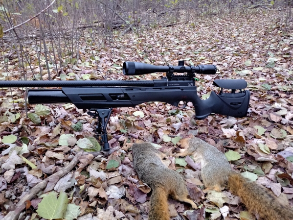

On my .22,I added the Hadji tune kit,adjusted trigger, added 23 cu.in. bottle & raised my reg. to 1400 psi.Also polished hammer. My .25 , put reg. up to 2000 psi., added 23 cu.in. bottle & waiting on tune kit( Travis saying after the Shot Show- end of Jan.

On my .22,I added the Hadji tune kit,adjusted trigger, added 23 cu.in. bottle & raised my reg. to 1400 psi.Also polished hammer. My .25 , put reg. up to 2000 psi., added 23 cu.in. bottle & waiting on tune kit( Travis saying after the Shot Show- end of Jan.https://imgur.com/w5zdv3D

With the tune kit & reg. change , I was able to push Jsb 15 gr.@ 930 but adjusted down to 880 fps(ideal speed for this pellet. My initial reg. was only putting out ~ 1100 psi. & pushing same pellet @ 830fps.-tune kit makes it all better. Trying to upload target pic @ 60 yds. but getting error 500 WTF! Never had this issue-
