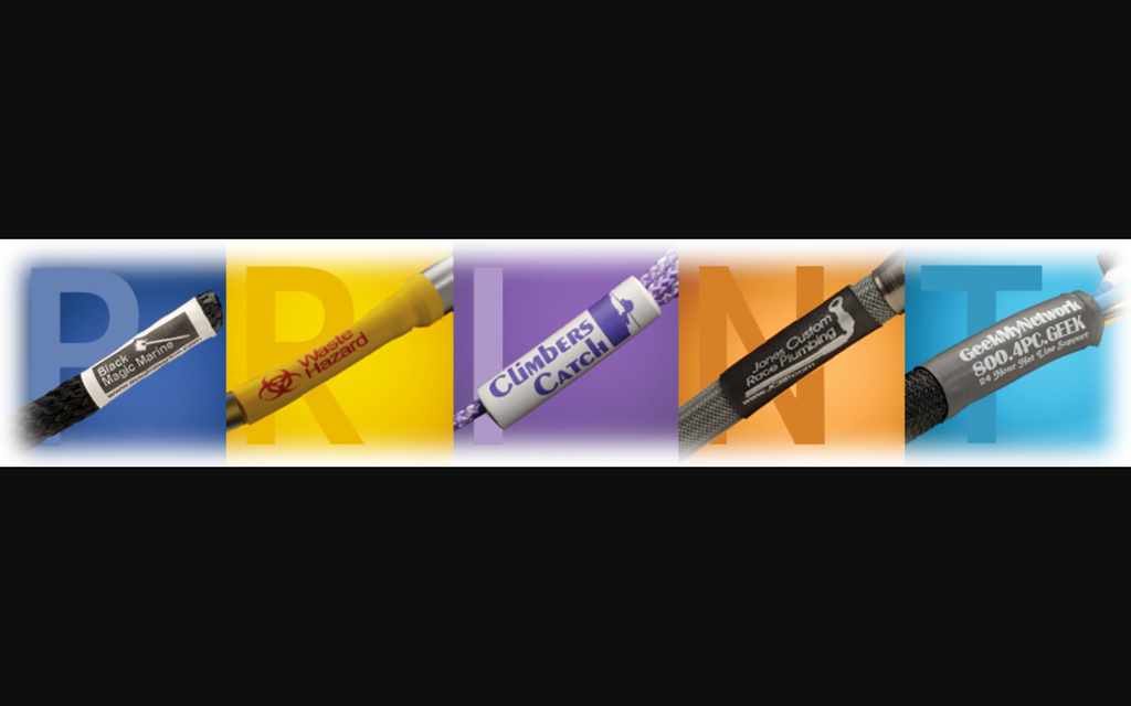

 You might consider a custom heat shrink tube, they come many styles and colors, gloss and matte. They can be printed with anything you can come up with, including address, website, phone number etc.. All you need is a heat gun to apply.
The bonus is, no one can remove it without damaging it, the vinyl heat shrink is very durable, like you see a lot of battery packs wrapped in.
We had some made with our company name to cover the service valves on airconditioners, so later we could tell if we serviced it or it had been tampered with.
