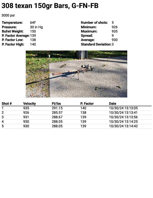

I own the Texan .308, which is powerful enough to eliminate squirrels. It is also an excellent PCP for coyotes, which is why I purchased it. It offers great long-range capabilities and substantial power. I use150gr ammunition and would confidently take a shot at a coyote from 150-170 yards, if not further. The shots below are tethered.
It definitely would be capable for both, I have been watching videos on it and it looks like it shoots very well, but it looks to be fairly long. How do you like if for hiking/hunting?
