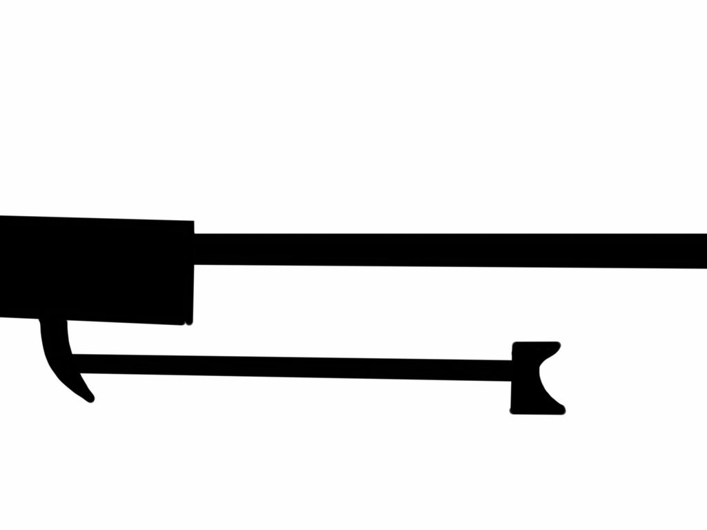

I've seen people use paintball solenoids to operate the original trigger with a micro-switch button. It works and probably works well but I am talking about a design that retains the feel of the original trigger (good or bad). Excuse the very crude drawing but something like this:
[]URL=http://s1206.photobucket.com/user/Zebracf/media/image.jpg1_zpshl9f62z2.jpg.html]
[/URL[/url]]
Instead of needing an additional trigger assembly, the original trigger is enlarged so it can be reached from a forward position. The original trigger, connecting rod and BP trigger is all one piece. This way, there is no travel that wasn't there with the original trigger. It should eliminate that disconnected sloppy feeling too.
