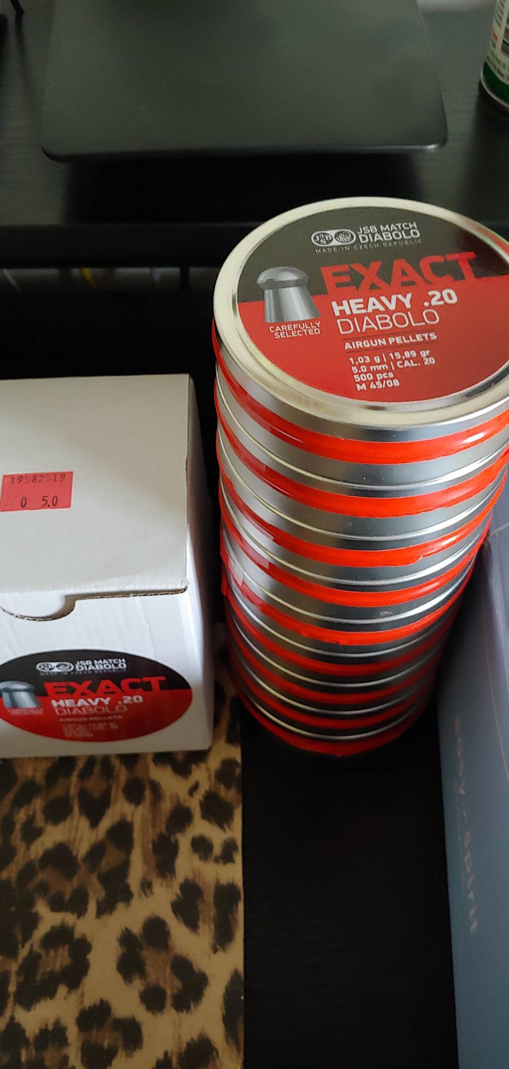

I always keep a very good supply of the jsb 15.9 heavy as my Az tuned rapid love them @ 900 fps.
