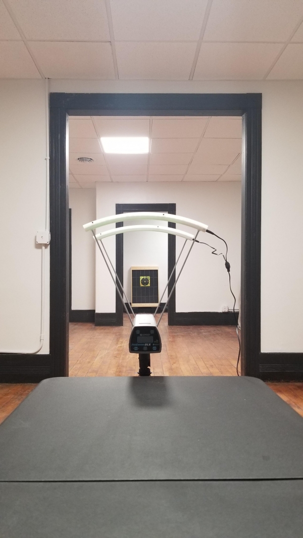

While this setup could absolutely be used outside,
I personally use it to be able to shoot inside in my apartment, so I can shoot daily/nightly throughout winter..
There are 4ft x 6ft rubber mats 3/4" thick.. They're known as 'stall mats'. Amazing for stopping rounds..
1 would stop .177 rounds. I shoot .22 and .25 cal, so, I double up the mats to give 1.5" total depth/thickness..
Anyways, they can be cut to a specific dimension and then boxed in using either a metal or wooden frame..
I threw together a quick video that sort of walks through the process, and gives the info along the way.
https://www.youtube.com/watch?v=GmrXPCpNXSw
Sam -
PS: Since I did that video, I've moved again.. Here's the same setup at my new apartment..
It is exactly 10 meters away from where my little bench rest table is located:

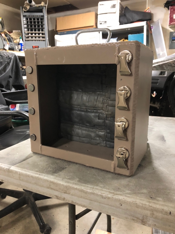

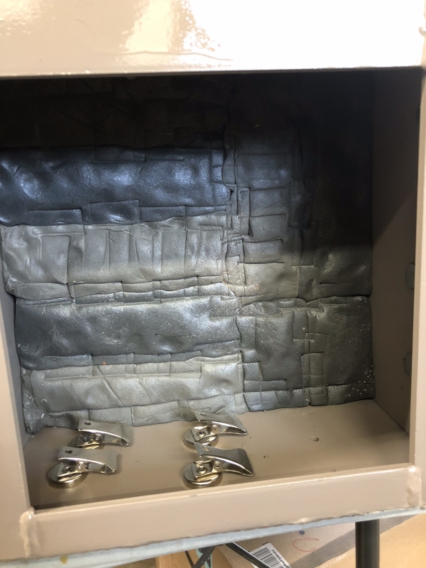

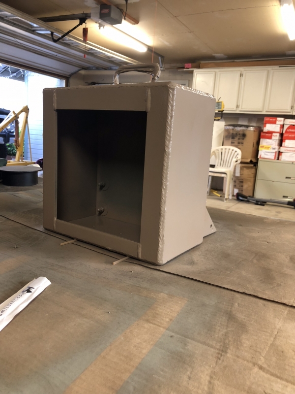

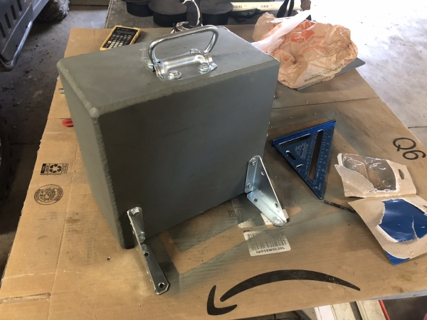

Heres mine. 10”x10”x6” deep outside dimensions, with 1 1/4” inside flanges on the sides and top, and 1” inside flange on the bottom. Fully welded seams, all made out of 1/4” steel plate. It has 4”x4” 45 degree back support legs and a 3” swivel handle on top. Lastly, it is stuffed with 7 lbs. of duct seal bars. A great friend of mine built it for me based on pics of a 16 ga electrical pull box with similar dimensions. But my 30 caliber pcp beat that thing up so bad the magnets won’t hold on to the targets cause there was no flat spot for the magnets to set on. This one here, pretty much laughs at 30 caliber pellets. They don’t even phase it. I use clip magnets for the 8” x8” sized targets and flat round magnets for the 10”x10” sized ones. This thing weighs in at around 60 lbs.
if I ever decide to mount it permanently outside on a post, I have weep holes drilled out at the bottom. For now, cause of its weight, I use a hand truck to roll it out to my front lawn where I target shoot.

Thanks guys. I did build a larger one that I posted on the original thread. I have hit the plastic face here and there, but for the most part I’m pleased with them. I usually sight in fairly close range and and walk it back to 30 to avoid damaging it. The smaller one is very portable and take it out to friends houses and such. You can always place a backstop as a backup behind it. I’m thinking about making a faceplate for it too? Anyway, glad it’s helping some of y’all.

The metal-fabricator & MIG/TIG welder in me got all excited when I saw your trap!
Great looking design, and very nicely done! That box is an absolute tank! Awesome!

Sam, if you do make one, really consider the placement of the target sizes within the paper when designing yours.
As an example, I like to use the splatterburst targets with the center diamond, and four diamonds at each corner. I took all the dimensions off of that target to design this heavy duty trap. With the flanges at the face, it gave me a clear path to each diamond in the corners, and none would infringe into the flange. Those targets were 10”x9” I believe.
I also like Caldwell’s splatterburst type of targets with the 3” round targets at all four corners. Those can be found cheap in packs of 50 at midway under the blemished section. Anyway, I didn’t pay attention to the placement of the bulls within the paper, and when I attach those to the trap, depending on how you orient them, either the top two or the bottom two will have a portion of their diameters into the steel. You follow me?
i can get around that by either removing the targets from the paper they are on and stick them on some cardboard that makes them miss the steel, or shoot the top two, walk down, slip the target upwards, then shoot the bottom two.
If I had to do it over again I’d have made the top and bottom flanges at both 1”, and the sides still at 1 1/4”

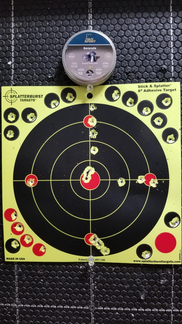

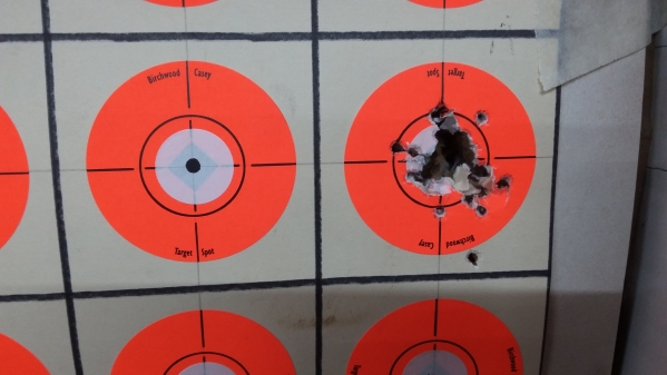

I used to go with Birchwood Casey Splatter targets, but, I go through them really fast..
While on Amazon, I ran across those SplatterBurst targets, and absolutely love them!
I go with the 100 count pack for $29.99, and I believe that they measure 8" x 8'
When shooting them, I don't just rely on the center/bulls, or the 4 main outer circles..
I shoot for dead center of all of the small 'replacement' stickers normally used to cover up shots..
That way, I have 19 'targets' before I even get to the last 5 main ones..
Those are usually the ones that I'll shoot continuously to see how many pellets I can send through the same holes..
2 nights ago, I just got my Puncher Breaker back from being serviced,
so I needed to pop it's acessories back on and get it sighted in again..
On this target, I used the center/lower dot to initially sight in,
then bulls to see where things were at, finally chasing around the outside..
Between the top and center, and the right and center, there are a few extra shots..
That's there the 7's 8's and 9's are printed in tiny font.. Not anymore! 🤣

Sam! Nice shooting, but, hey, you missed the #7 on the far right, so, it’s just like any old target then.....NOT! Kidding, man! That’s some awesome shooting.

No way dude, I just double checked, and yup, you're right.. I sure did miss that #7.
I think it was more like a brain-fart, and I totally forgot to even take a shot at it.
Nice catch! Your eyes aren't as bad as you claimed in your captcha thread. 🤣

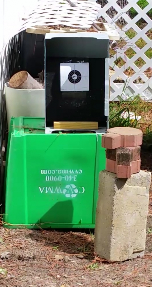

Old apartment lockbox cover from utility company. They are made to be outside. Heavy, rope light LED on that inside lip to the right for night shooting. Two stacked ballistic rubber blocks inside. Stays outside, portable. I only have a 30ft lb .22 Wildcat. I shot at it once without the rubber to see if a stray round would go through-NOPE (big dent.) BTW that wood block had 2 nails, smallest was thumb tack nail, 1.2mm wide. I missed it but got it 3rd try. 25 yards. The bigger nail got first time. Was with a Sightron SIII on 24x, lol.
