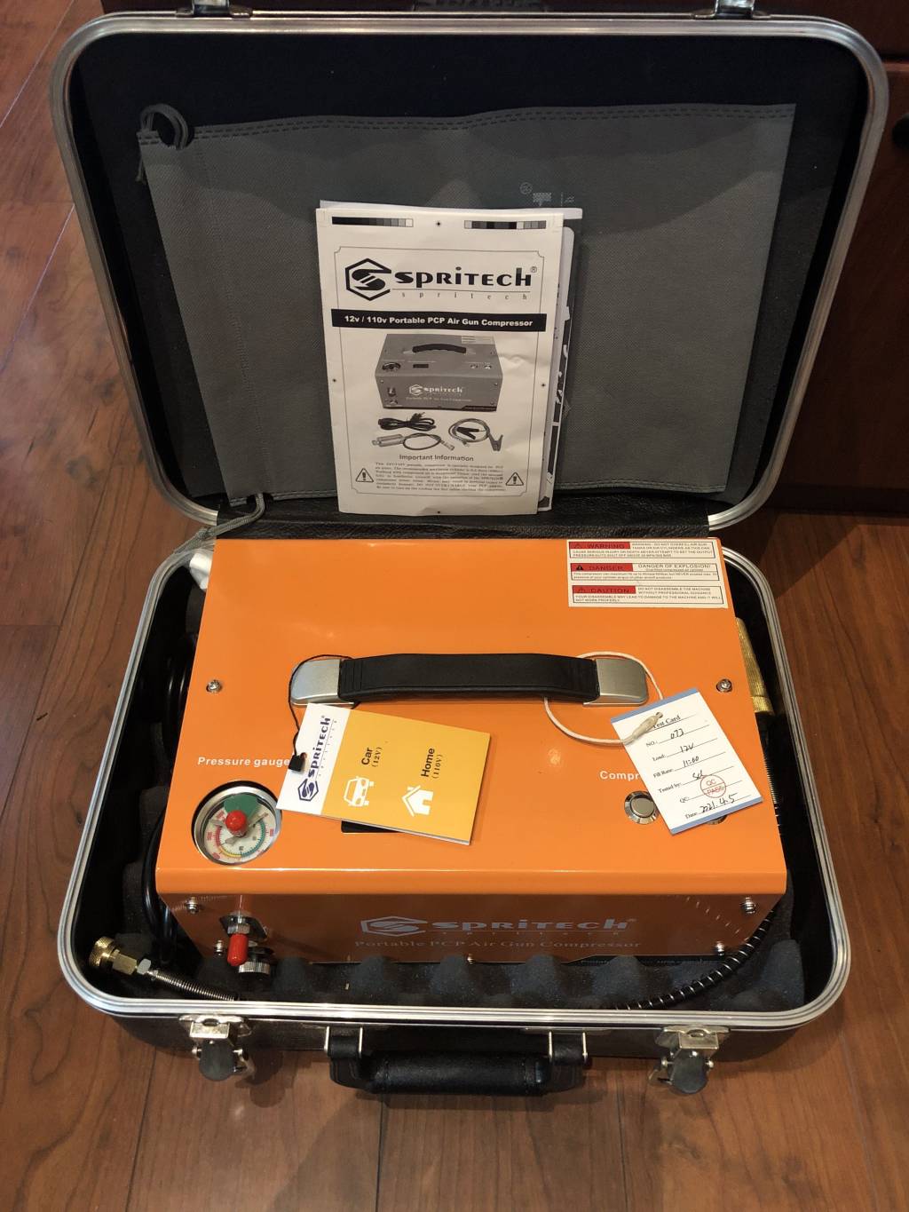

Any opinions on these type compressors?
Mine works fine. Use it as intended and it will last quite a while. Fill guns direct, pass on the scba tank fills. Never start them under pressure and let them cool between duty cycles.
They do not compete against a Young Heng, but they are drop dead simple and portable without extra water mess.
The pump CAN go to 4500 psi....but it will last a lot longer if you don't make it go that high. Few guns can store 4500 psi....so again, fill guns. Do not use it to fill bulk storage tanks (especially at 4500 psi)
When you have free air at home, there is no need to push to the ragged edge.
I have had one for about 3 months and after getting the 12V converter replaced at no charge (they sent the part) it works fine for what it is. Filling a 500cc bottle or less on your gun no water or oil to worry about. My Krals will got to 250 bar (3,600 psi) and I fill to around 235 to 240 bar from 100 bar takes 5 to 10 min. I also have 2 SCBA tanks I got for free which is nice when hunting but if you are just a home shooter these are the way to go for sure. At this price I don't get why people are still buying hand pumps.
Like @JimNM said don't fill tanks and don't over use or abuse them. If you are going to fill your guns every day or many times a day you may want to get something more just like a contractor is going to use a Dewalt and not a Ryobi but for light to medium use I also think they should last a while. I was impressed with supplies and general quality of mine.
Yeah, I'm envisioning running into the house from the backyard and topping off my Marauder from 1,600 to 2,500 psi about 2 or 3 times an hour.
That is such low pressure (I am going from 1,600 to 3,500 by contrast) that should fine except the manual says to replace the filter that absorbs the moisture after about 15 cycles mine came with a bunch and you can get more on Amazon. Again I think it really depends on how much you use it I only need to fill a few times a week and a few times an hour lol!

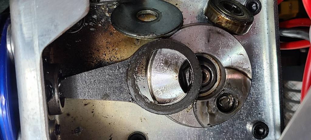

I had the orange compressor and it worked great for 7 months then the bolt that holds the piston rod snapped. I never filled past 250 Bar and it was used about 4 times a week. I contacted the seller through Amazon after 7PM and they responded within the hour and asked for video of the issue (I provided pictures). They then responded again (the seller not Amazon) about an hour later offering me a full refund which I had a day later. I did try replacing the bolt and it worked for 3 top offs and broke again. They now offer a newer digital version which I asked the seller about and bought one it does have a different mechanical connection for the piston. Two weeks in with the new compressor hoping for at least another 7 months.

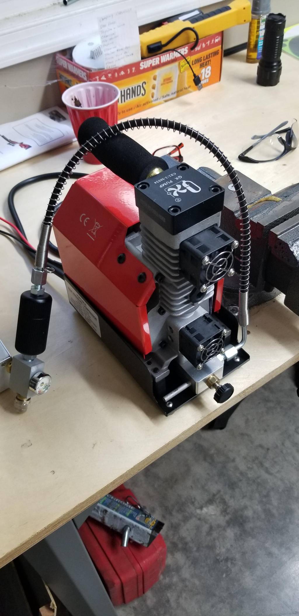

I did have the GX CS3 PCP Air Compressor, It only lasted 3 weeks and the .25 cal Avenger Killed it, The company said it would fill to 4500, I ONLY FILLED TO 4000-4200PSI. now have a
TUXING 4500Psi Pcp Air Compressor,Double Cylinder High Pressure Pump,Adjustable Presssure,Air Rifles Paintball Tank 110V(TXED012) and i love it !!!!!!!!!!!!!! had it 1 month

I have the same compressor in black that I purchased from Vevor. So far its been working well to top off my avenger to about 4000psi.

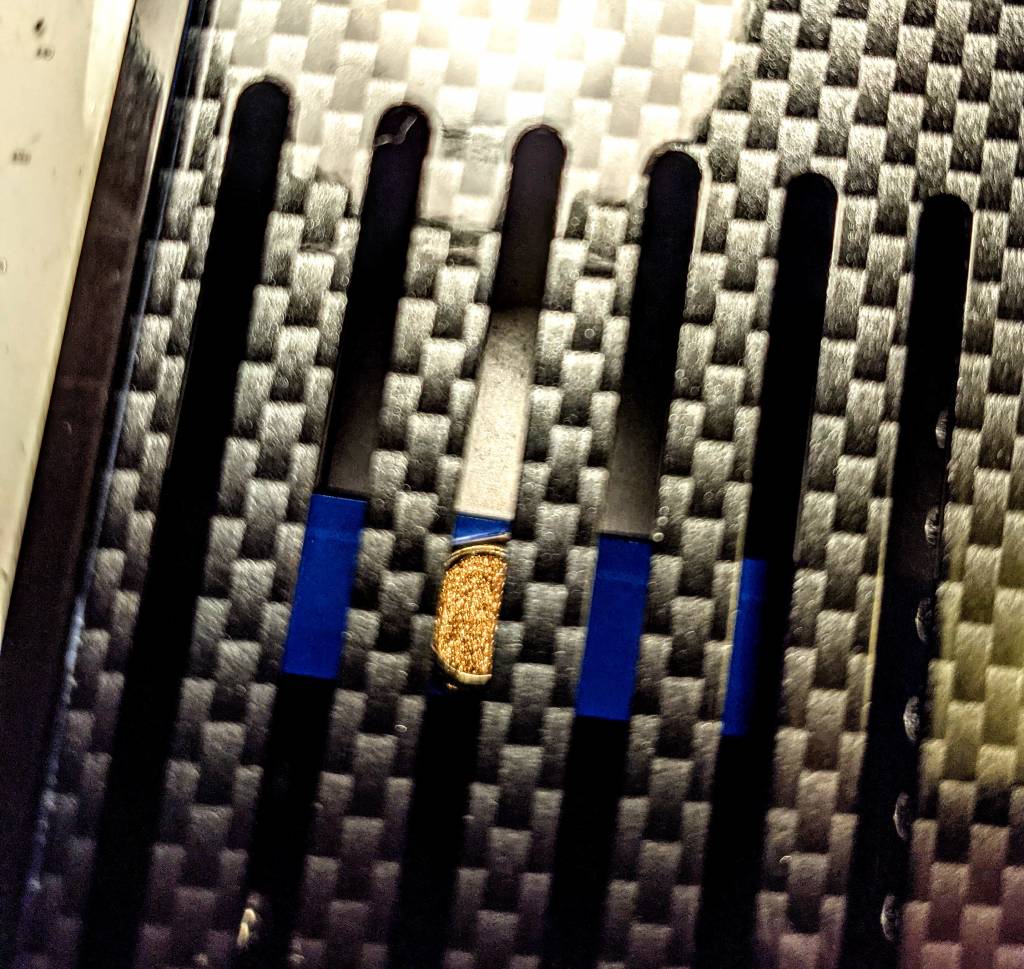

After every few runs, I turn it upside-down, and with the vent open and the compressor running, I dribble some silicon oil into the inlet screen which can be seen through the vent slots in the bottom of the cabinet. If some of the silicon oil ever finds its way into one of my guns, it shouldn't do any harm.

Interesting that your personal experience with these compressors was so unfortunate. Readings posts about water-cooled oil-lubricated Yong Hengs and oil-less compressors like this one indicates that these compressors last as long as they are being used in the manner they are supposed to be used. If you run them non-stop, over the temperature, do not maintain them, abuse them...they will fail. Not unlike running your car or any mechanical machinery. Also, if you do not follow the guide and start/stop with maximum inert pressure inside and you break a piston rod, etc -> it's always less embarrassing to blame the manufacturer.
