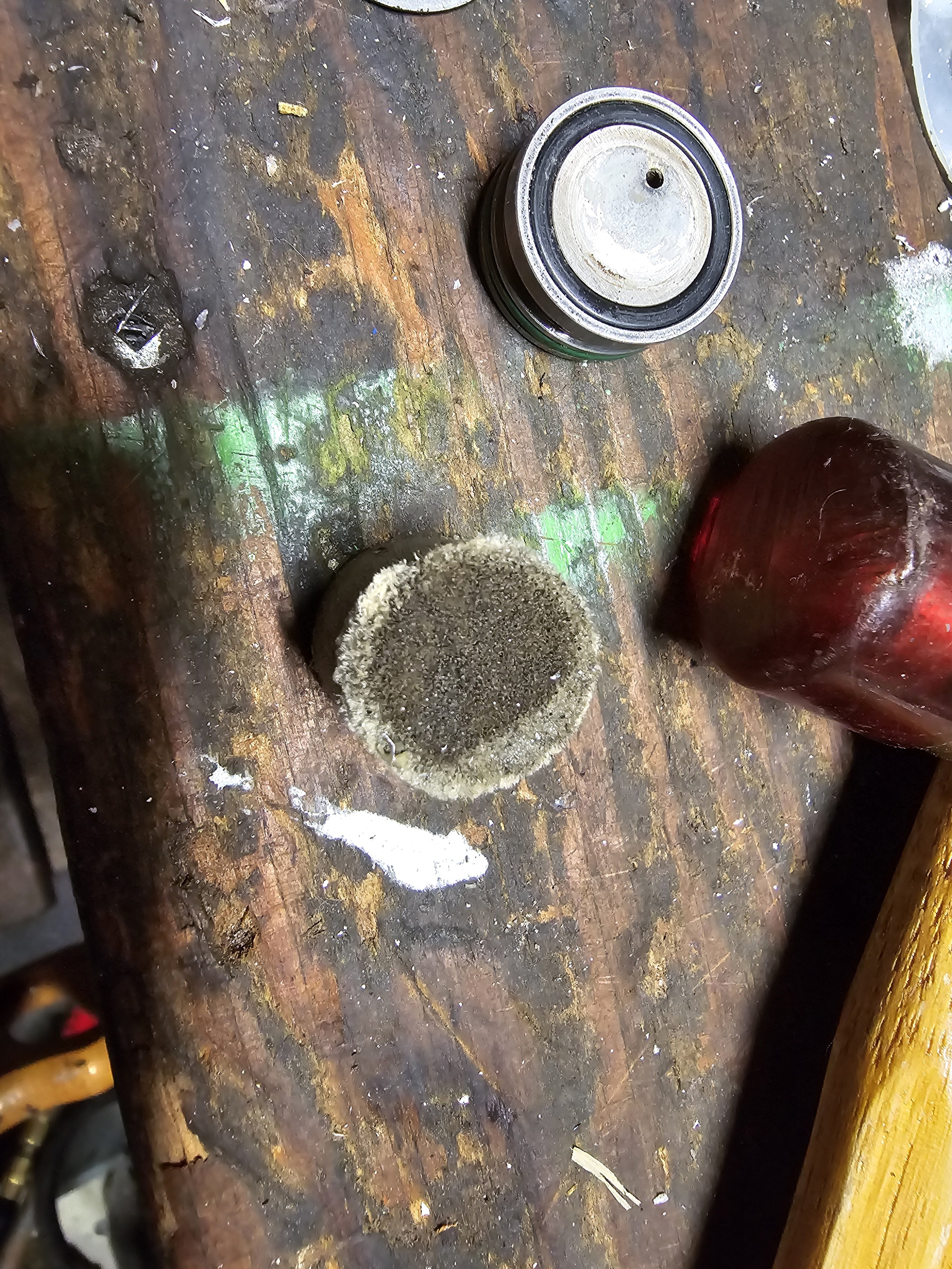

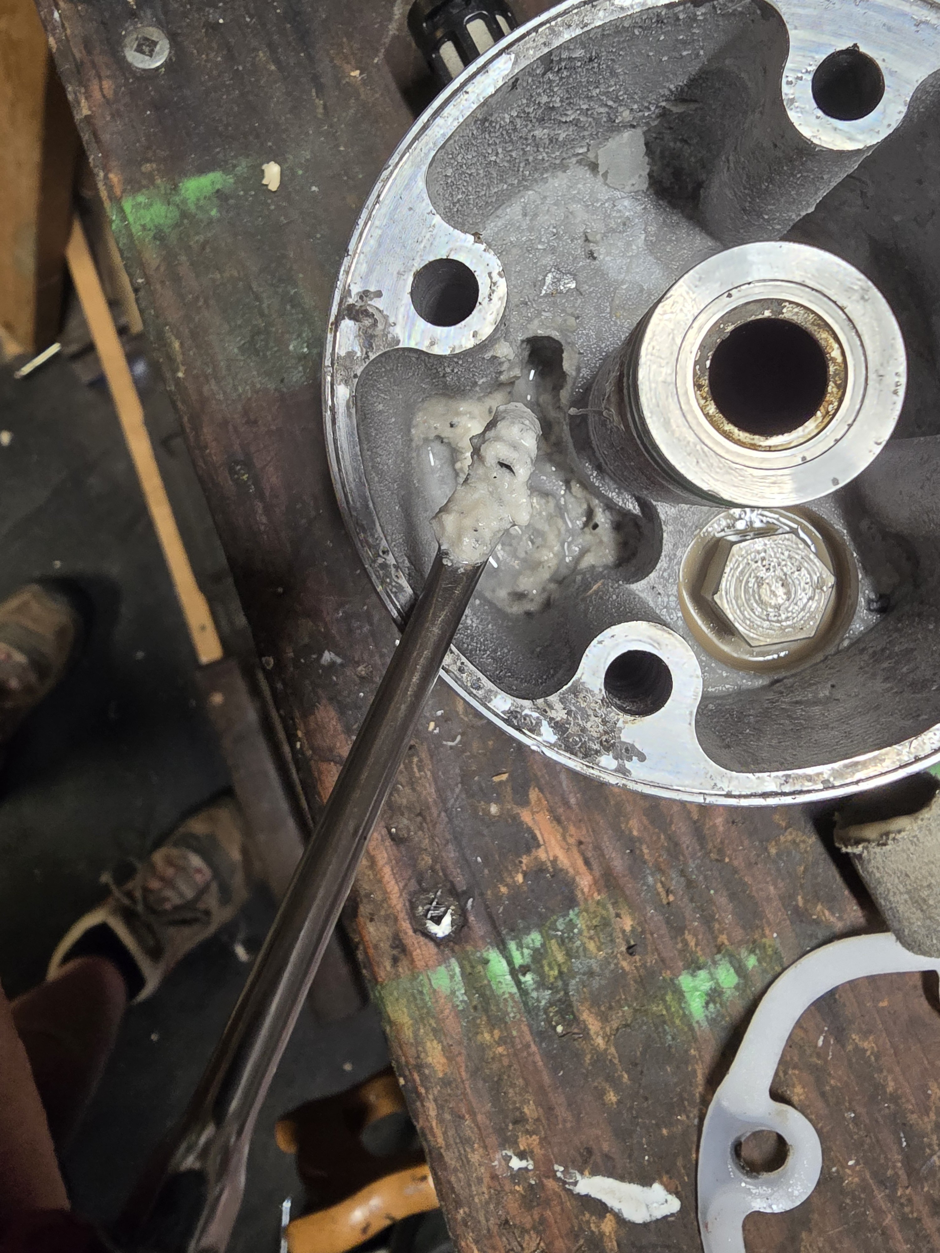

The corrosion failure was similar to the New Warrior (Benjamin Recharge 4500) that I repaired. The cooling system was badly fouled by minerals from using hard water. Replacing the internal air filter (who would hide that inside the cylinder head?) and mechanical removal of the deposits and corrosion solved the problems.
