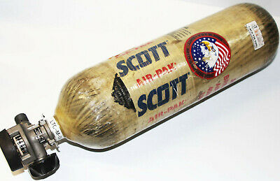

any ideas on this tank
the local FD was getting rid of all their tanks and setting up systems with all quick connects.
a friend who works there was able to get one that still had 2yrs on the certification left before they thru them all out
I am confused as to what type of connections I can put on it to fill my PCP
male thread outlet , does anyone sell anything that would work
here is a google pic of the same tank
any help would be appreciated
Nice find, esp. since they are still under hydro. You can find setups online for SCBA tanks, just be sure they are a proper diameter fit for the valve. Those adaptors can vary in price from around $50.00 on up. When in doubt you can contact Joe at Air tanks for sale, here on AGN, but keep in mind, his prices are typically higher than other sources, but on the plus side, you can talk to a real person and not have to guess on an online purchase. Good luck and happy shooting. Also, be sure to get the proper adaptor to fit your particular gun if you don't already have one. Having a female foster fitting on the end of the SCBA fill hose makes things easier.
