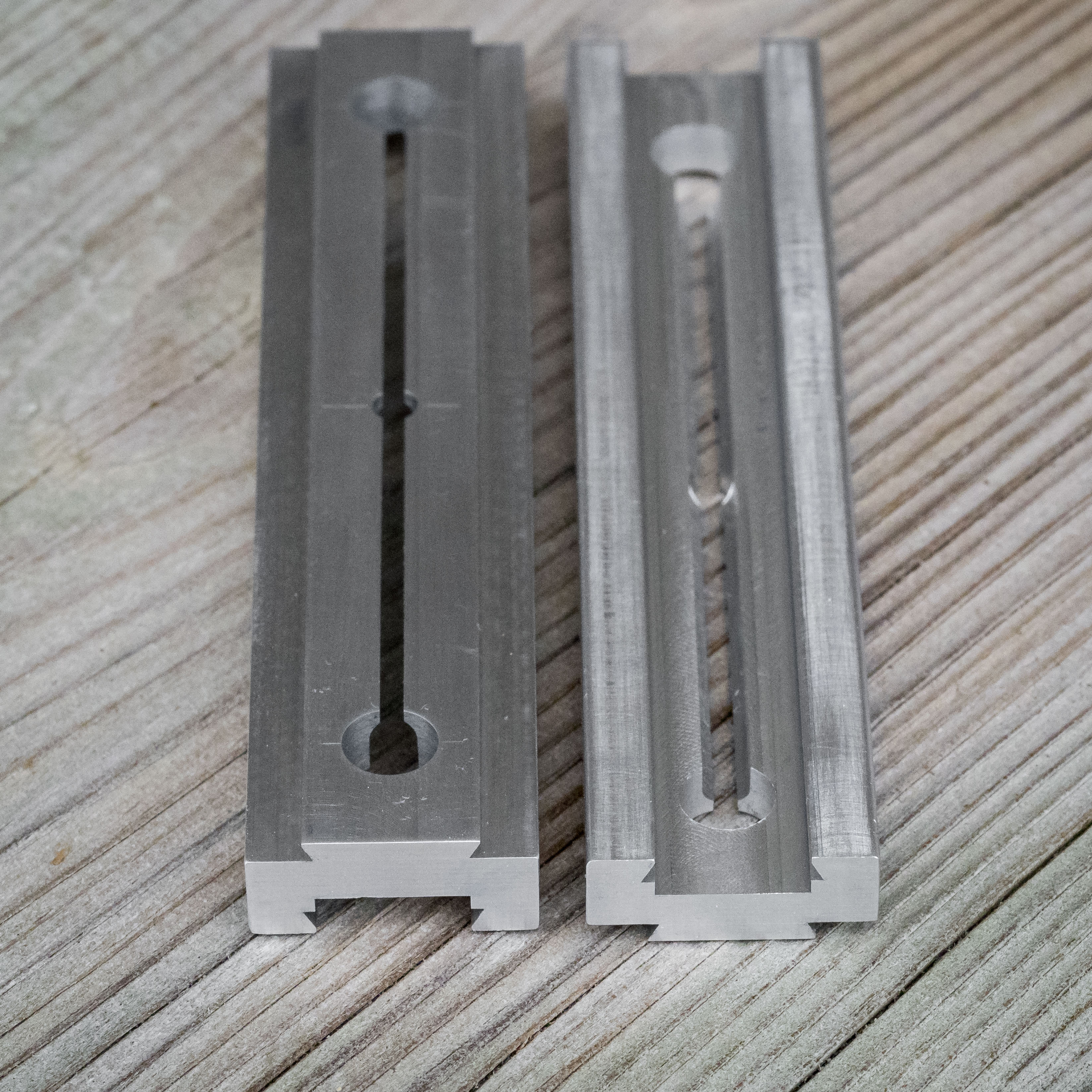

This is the kind of shop you are looking for, like the one I started in specializing in repair work. Everything is a one-off.
I have done this kind of work before. Laying out the dovetails can be a little tricky. The fit is controlled by the theoretical dimension across the inside corners of the male dovetail. This is best measured with thread wires. If you find someone to do the work, I can give you the dimension across wires for a standard Anschutz 11mm rail. These are some risers I made.
