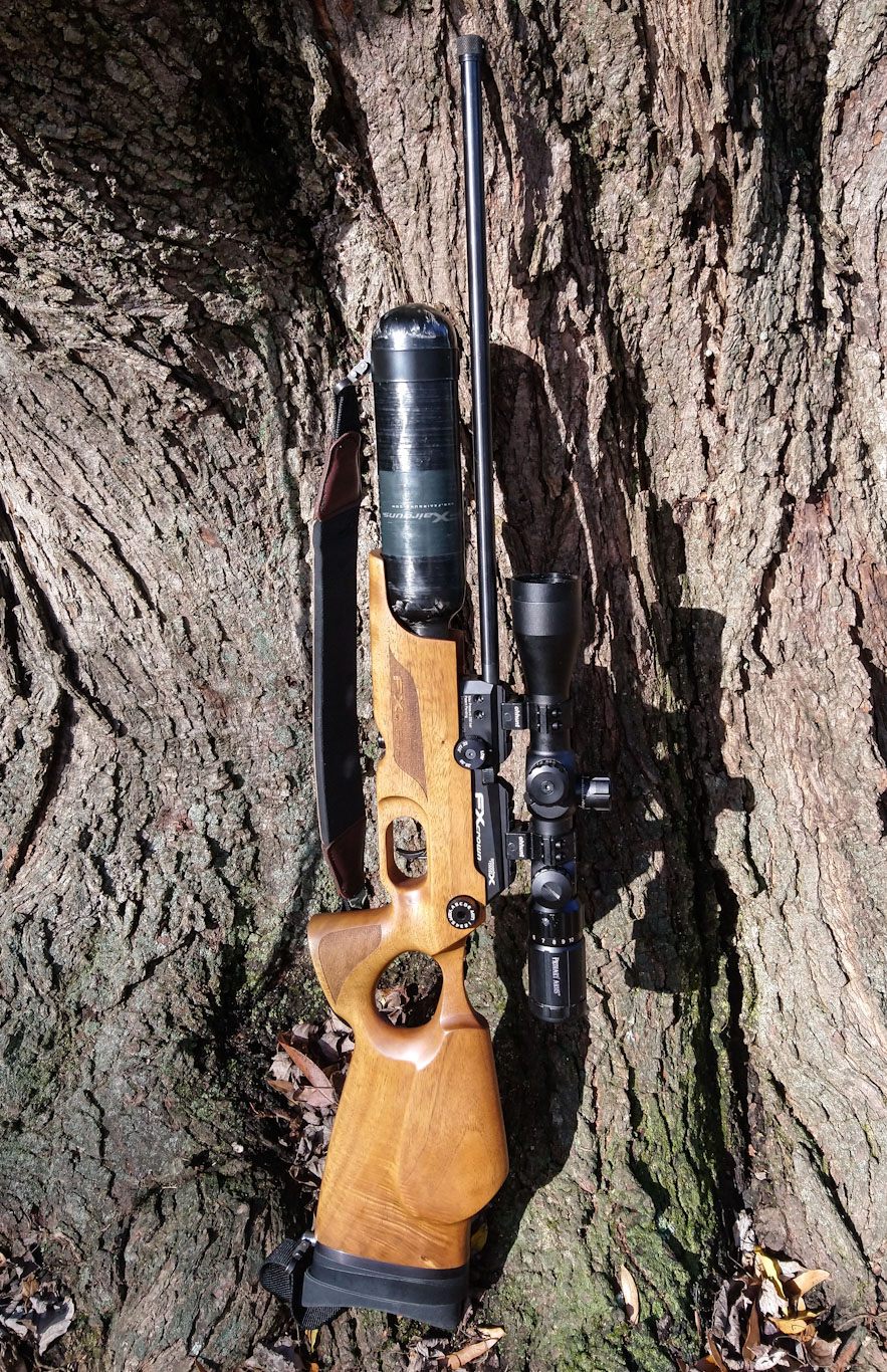

I've been running slugs thru a new superior carbon fiber bonded 500mm superlight barrel on a mk1 continuum. The difference in ease of tuning, and out the box performance is just silly. I'm pretty well tickled

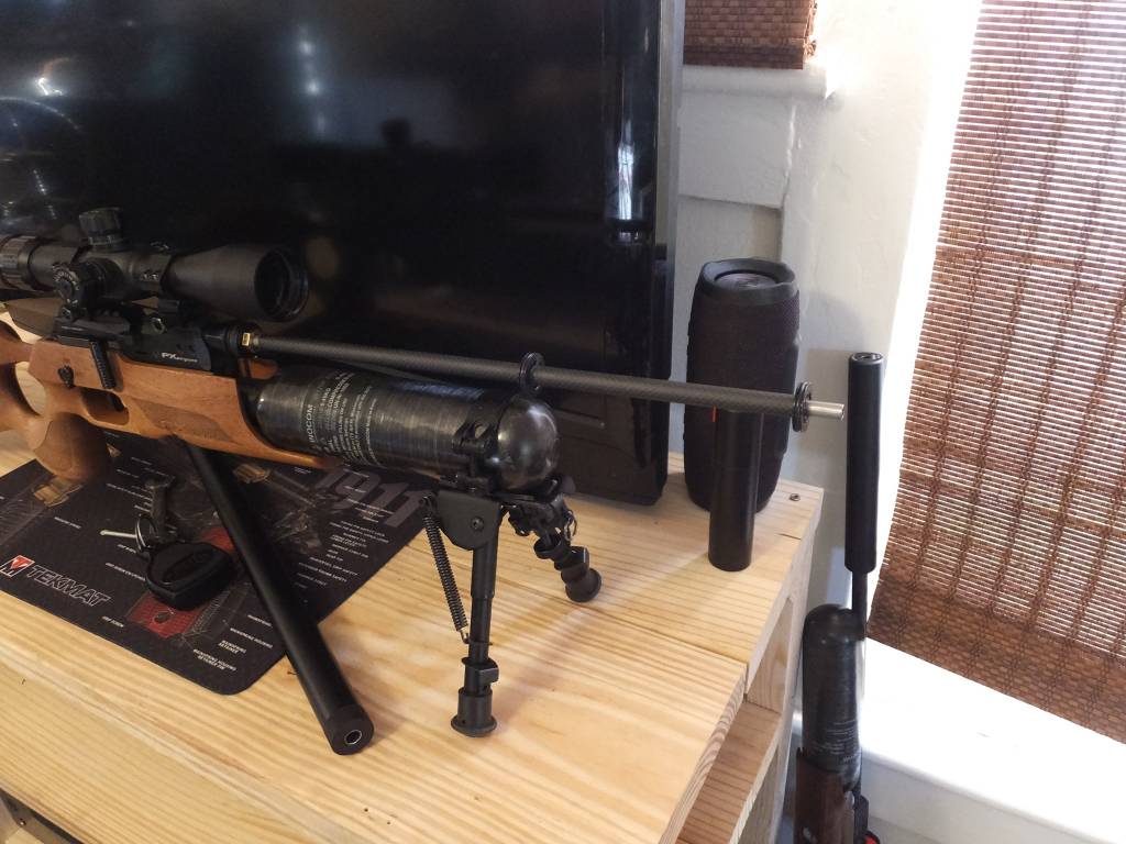

Do you have any pictures of how you did this? Are you using the same lite barrel system shroud or???
Note small space for jam nut to turn/slide.
Carbon tube is an odd size. Ordered from Earnest Rowe's custom shop.
I recon you could jam 2 supports together toward the muzzle, and that would be fine. But I felt best about doing it this way. Tried to keep the 2 sections as long as possible, and they are epoxied up against the sandwiched support, they are epoxied at full length to the barrel. This gun was shooting at just under 75 yards. Definitely sub MOA with griffin 21gr LDC slugs. I had wanted to dial it in with 25gr, but my regulator gauge got bumped, and I couldnt iron out where my pressure was at exactly, so was down on power. Shooting them at 940fps. I wish I did take pictures and measure groups, but most of my time was spent getting my gear rounded up, table, chrono, tank, tools, ect. Then unpacking, setting up, and then trimming branches to get a clear line out to the rock face on the opposite side of a creek off my friend's deck. Got off work early, and was working against the setting sun
I was also testing an original 500mm .22 mk1 impact smooth twist (not X) barrel. A direct drop in for the crown platform. And has 1/2x20 threaded muzzle, so will be super easy to setup a shroud for
