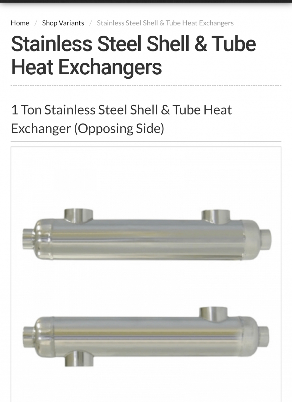

Got my Chinese pump.. and still deciding what I want to do for filtration. Joe's airtanks looks nice.. but expensive. Seems like there would be a completely different way to go about this. I looked up high pressure heat exchangers.. basinlly a large tube.. with many small tubes inside to run cool water through.. and the air would go around. Even with this concept.. for it to work it would think it would have to sweat on the outside of tube.. not sure if it would. Any other suggestions?
Yes.. "heat exchanger" like they use on lower pressure air compressors to help remove water vapor before it gets to tank. Not too worried about contamination.. as I dont for-see a piston getting in my gun. Just was trying to think outside the box as a way of removing water. Seems like there would be something better than a metered tube with cotton balls for heaven sake.
